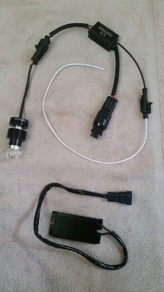

    You got the older version ? If so I don't know but if you got the newer version plug and play . New version white wire tapped into harness connecting to headlite bulb. Taps into low beam so when headlites on switch backs dim from about 600lm to 50lm.Mine 2010 has three wires to headlite.Got pics of your vleds . Yours has red wire for adapter and taps into parking lite circuit so yours might be different. pics the one I got White wire for dimming

    Thats the V3 that he has but thats not the adapter that the tech guy told me I needed to install. the one that he has has a red wire that has no terminal end just like the white one. that red wire is supposed to be t-tapped into the parking break circuit's positive wire. I just don't know which is the parking break circuit. is it the same circuit that the dtrls are already on? and what color is the positive wire? sorry I'm not a wrencher and rely on this forum for a lot of shit...
