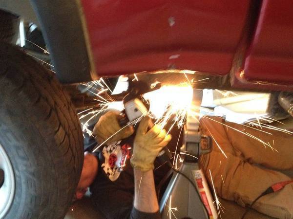

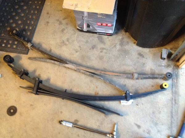

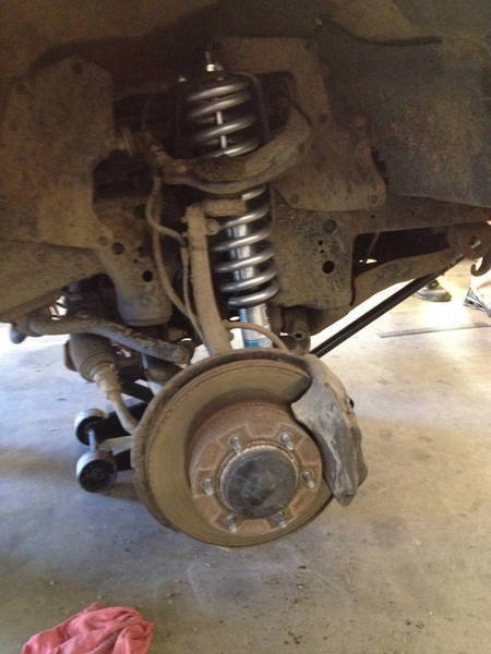

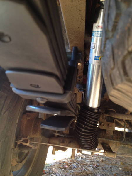

    With a little help from Matic (well, actually a lot of help) we knocked out this suspension yesterday. Not a bad way to spend a Saturday in South Carolina in my opinion. The fronts were a breeze but the rear leafs gave us a bit of a headache. The front hanger bolts were absolutely frozen in place...PB blaster, sockets, ratchets, breaker bar, hammering, bitching and cussing to no avail. We finally had to cut the little mofos out. This huge us up for a while but we pushed through and persevered. This is what we installed:
    112-620 Eibach/Toytec front coil springs

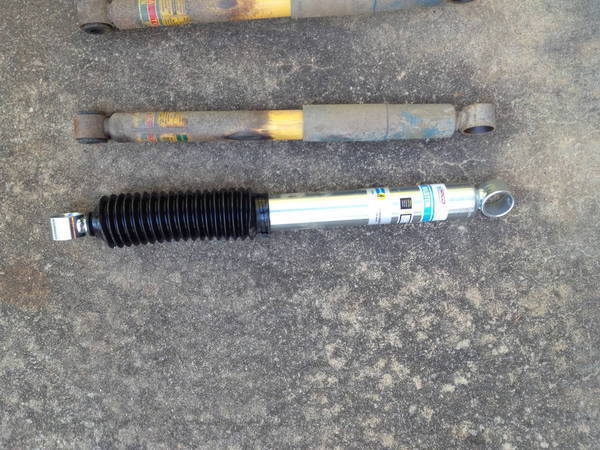

    Bilstein front (Set at 0) and rear 5100 shocks

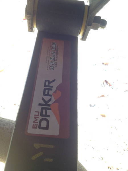

    Old Man Emu Dakar rear leaf springs (Part Number CS046RA/B)
    Front diff drop kit (TAC-DR)
    BPV-K brake proportioning valve relocation bracket
    OME Exhaust Bracket (FK-21)

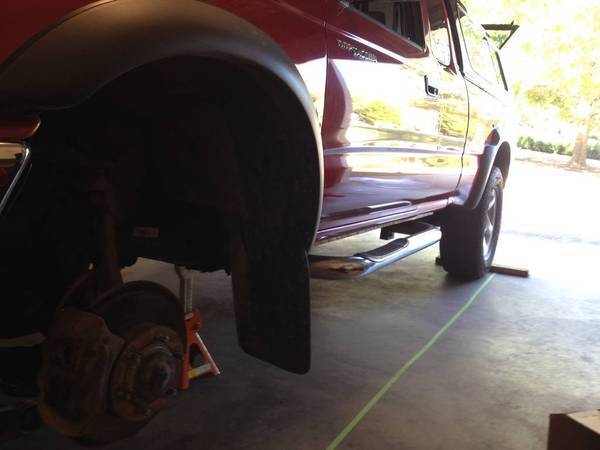

    This was definitely a learning experience for me and I am hugely grateful to the help I received. Here are some pics:
    Bro Lean, Bro!
    Matic gettin' some!

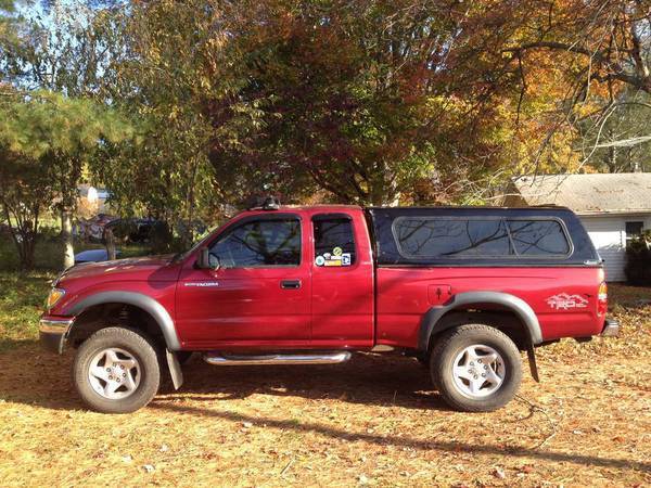

    Sits pretty level. We measured 25" from the center of the axle to the wheel well all the way around.
