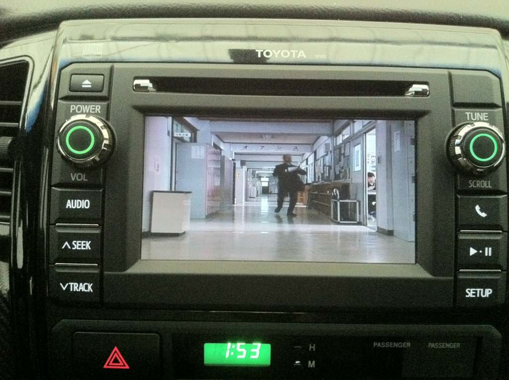

    Added that beat sonic harness to add a/v into the headunit today...ordered it last night came by ups 45 mins ago :eek: didnt notice it was down the freeway lol jutatega_4ad6f34ca2257830c73cb9d362b3c29fca0f25ee.jpg
    Hooked up a small Sonya DVD player I had and success :woot:

    Part number? Link?
    I'm guessing it changes the "aux" source into "av"? Or does it add another source in addition to "aux"?

    And does the HU automatically list it as a "source"? Which existing plug does it replace (all 7 connectors are populated on mine).
