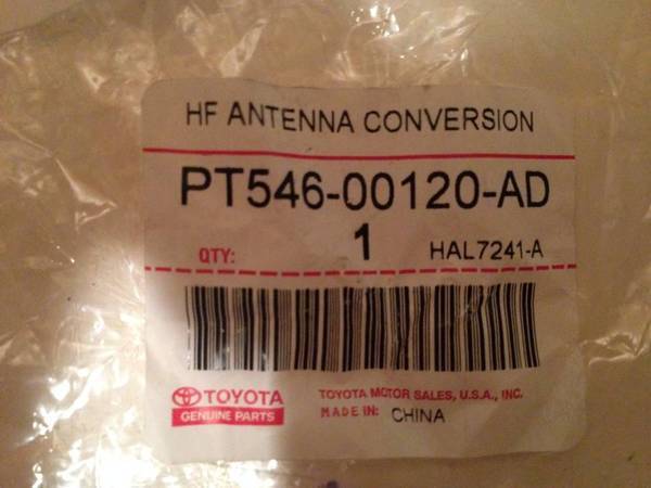

    Just Bought theses 2 connectors from Toyota for my 2013 Touch screen install into a 2012. Plugged right in and now I have my Steering controls, Bluetooth mic and my antenna to listen to the radio. Just need to find a USB and Video connectors so I can see my reverse camera and maybe watch videos.

    ^^ If I may ask. How much was it?

    $100 for both
    $70 for the 28 pin and $30 for antenna adapter

    Yeah it was pretty pricey but didn't want to wait for shipping. I know there's some sites with them for a little bit cheaper. If you just search the part number there's a lot out there

    FYI, I just purchased my kit here: http://mytoyotapartsstore.com The Scion Base Audio Wire Harness Kit (Item # PT546-00142) comes with the antenna cable, 28 to 20 pin, and the USB cable referenced above. This kit is $77 + shipping coming to $91.XX for me.
    BigKaks mentioned that the USB cable didn't work on in his install but it leaves a door open for maybe some splicing....
