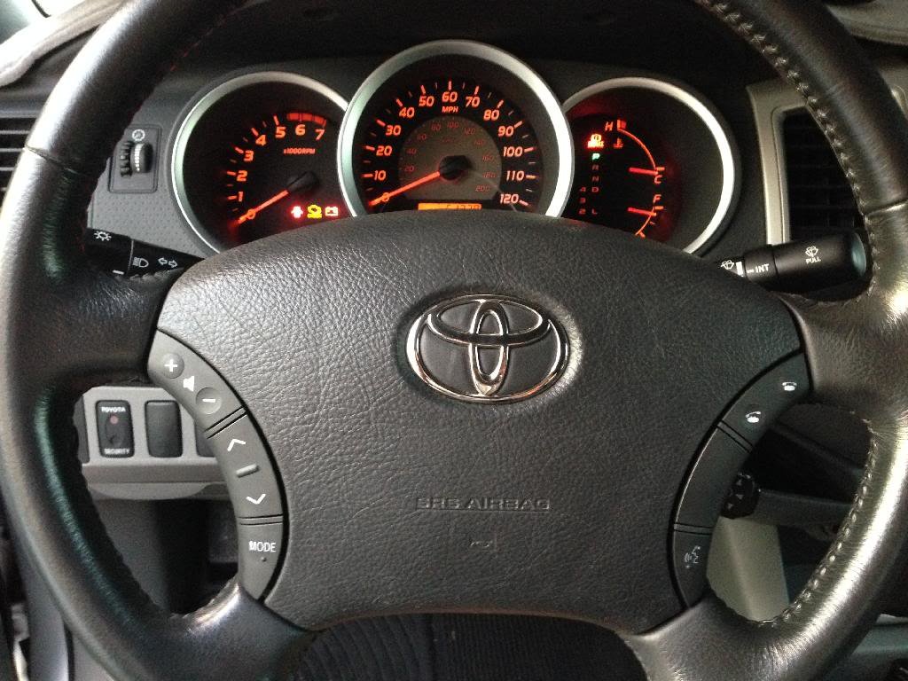

    Successfully installed steering wheel audio control, BT calling control and voice activated control. I had the plain jane steering wheel and this is a big improvement and taking the full advantage of the 2014 Entune NAV HU.
    BB0E7360-A99F-4F38-A47E-E1045E2DC017_zps_cf9325da33092911983a3691f6cb0b1ca664230e.jpg
    Volume + & - works, Channel < & > works, Mode function works, Bluetooth calling works and Voice Command Activation function works. Everything's working flawlessly :D and yes this is on an 08 without any of that fancy premium package. :thumbsup:

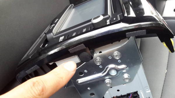

    Alright, my radio showed up today. 2014 non JBL w/ nav & entunes.
    Installed it in the truck to make sure it works. It does. I still need to order the rest of my harness and other parts now, but I have a few questions...
    1. The radio I have doesnt have the 2 side pins that hold the radio to the bezel. Does anyone have the part number for these? Pictured below -
    2. Does anyone have a part number or size of the 2 screws that goes through the top of the radio bracket into the bezel? Pictured below -

  7. Feb 27, 2014 at 5:29 PM
    #307
    adio
    adio Well-Known Member
    Sep 11, 2008
    #9165
    2,637
    HI
    2015 INFERNO TRD PRO
    worse case scenario you can get substitute those parts. pretty sure can find some at Orei'lly or something.
    Or ask the seller why he/she didn't include them.

    Got the push pins and screws sorted out with parts from the hardware store.
