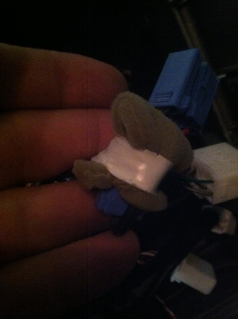

    That sir is your usb connector, it transmits the info for music to play, if not connected u will be able to charge usb but no aync with the head unit

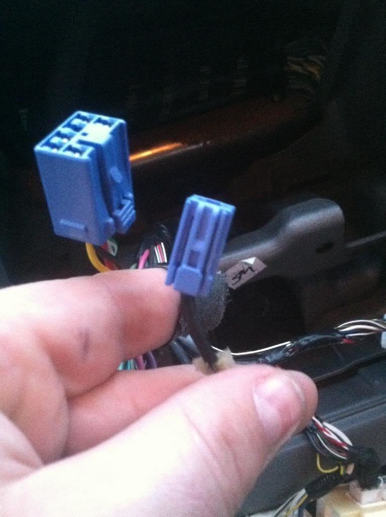

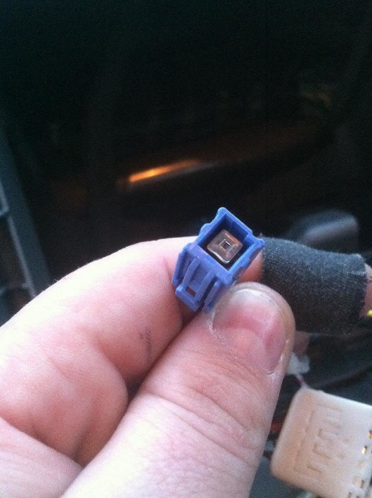

    So with this picture,
    and your Pinout Charts, I should be able to do this in 5min flat.
    [​IMG][​IMG]
    [​IMG][​IMG]
    Reference to the chart vs the wire harness color codes.
    15. Black w/ Silver speckles
    16. Red w/ Silver speckles
    17. White w/ Silver speckles
    18. Electrical Tape Black
    19. BLUE

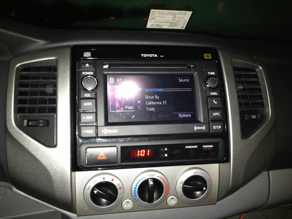

    Hey,
    I own a 2011 Double cab Taco with JBL System, I hate the bluetooth that comes with that radio, so I just got my new Radio with display model number 57016 and part number 86140-04060. I also bought the USB harness and plug, the antenna adapter, the R3-R10 to R15 adapter, Until now it's working great, but I have some questions that probably you can help me solve:
    1.- My new radio came without the extension module, what is this for? The audio and phone bluetooth works fine, the same with the XM radio and steering switches, and the USB plugs directly into the main unit. So I guess it's only for the navi option, am I right?
    2.- My system came with the MIC on the rear view mirror, but I upgraded it to a 2013 mirror, because it has a bigger display and compass and Temp (temp in the mirror does not work, yet), so I had to buy the newer MIC that goes at the Overhead console. I would like to have the MIC harness connector (that one that comes from the radio into the MIC's conector) I think it's the female one. Does anybody know it's part number?
    3.- I would like to buy the 2013 radio bezel, so my new system fits properly, but I do not know the part number as well. Note that I need the 4WD part.
    4.- After changing the new radio bezel, if it comes without the 4wd switch, I think that 4WD switch I have won't fit, so if you know the part number of the newer one, I'd be pleased.
    Thanks a lot this thread has been very useful for me.
