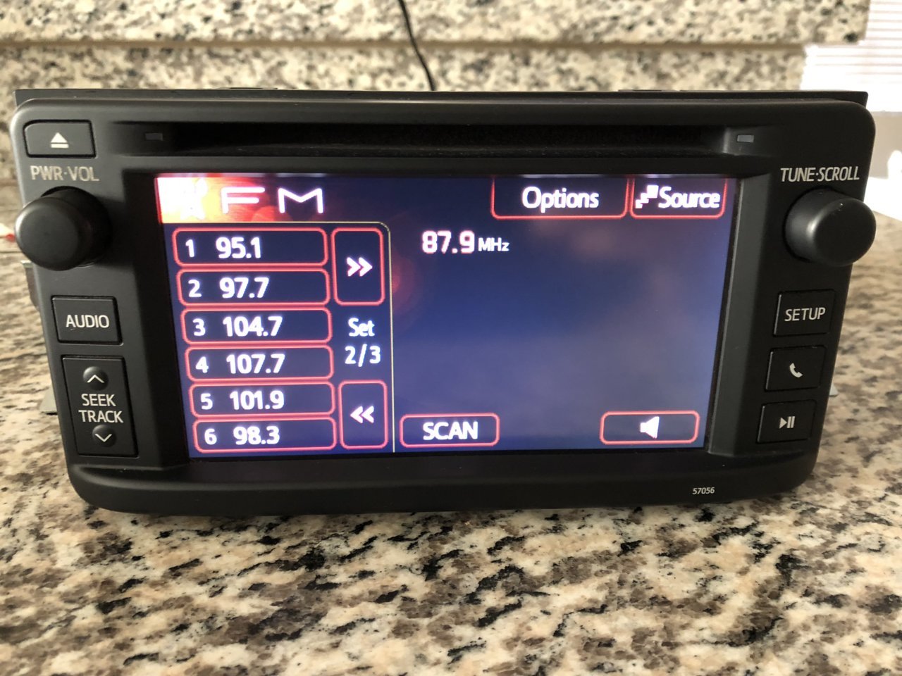

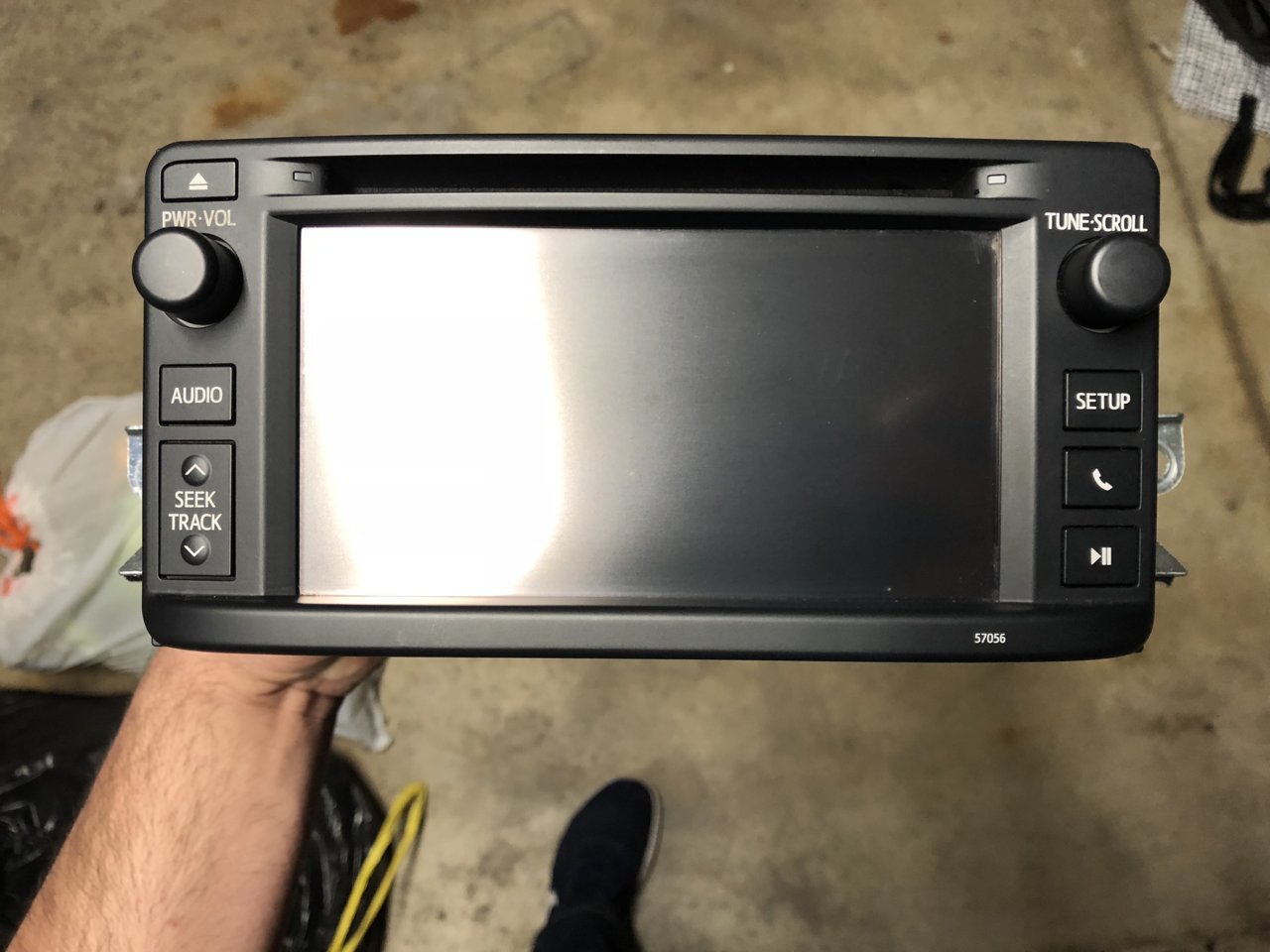

    Since then, I scrapped the 12 non entune idea
    Went with a 2013 touch screen no nav
    And existing now I have a 2014 entune radio with navigation (non jbl) with radio surround and vents painted black to match the radio.

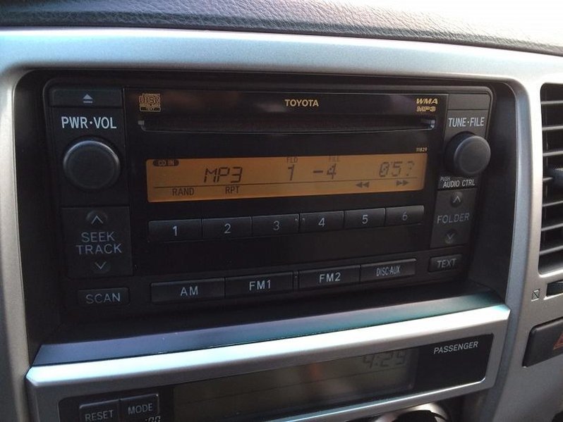

    But now I'm being retarded and bought an entune radio from 2016 sport with entune and navigation (the radio itself is the same as my 2014 radio but the from face and buttons are completely different) :cool:
    2014 radio compared to the 16
    PS: i can change the leds on these radios very quickly :woot:

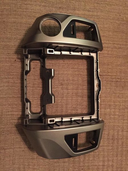

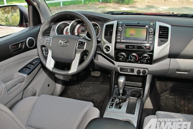

    Like others said, you need that center piece. They're hard to find here so I recommend searching online salvage yard inventories. I used car-part.com for all my 2012 interior pieces, which are now installed :cool: Warning, in order to remove the center piece, you have to first remove the driver side step in panel, the kick panel, the lower dash, and the upper dash. It took me about 10 minutes total, not bad. Only tool needed is a screwdriver for the plastic screws above the speedo and I think a 10 mm for the radio.
    Also, when removing the upper dash, it's a GREAT time to wipe off the instrument cluster glass! Mine had a ton of dust and grime under the rings.

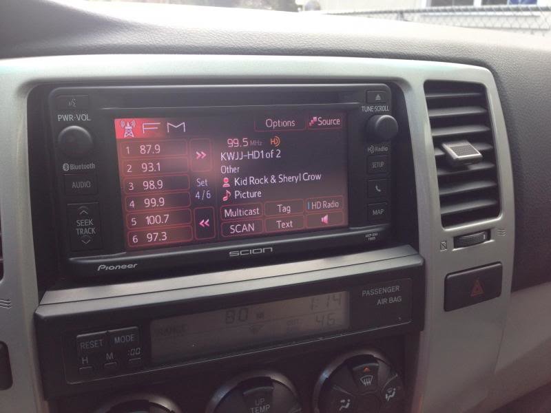

    Now I can get an older one and swap the head unit. I did a similar upgrade in my 07 4runner to a 13 Scion FR-S headunit. Plug & Play.
    before
    after

    Awesome thread, finally found the R17 connector that i need.

    Did you have controls on steering wheel?
  11. May 15, 2018 at 3:41 PM
    #371
    Az636
    Az636 Member
    Oct 31, 2016
    #201185
    14
    I did, it was all plug and play

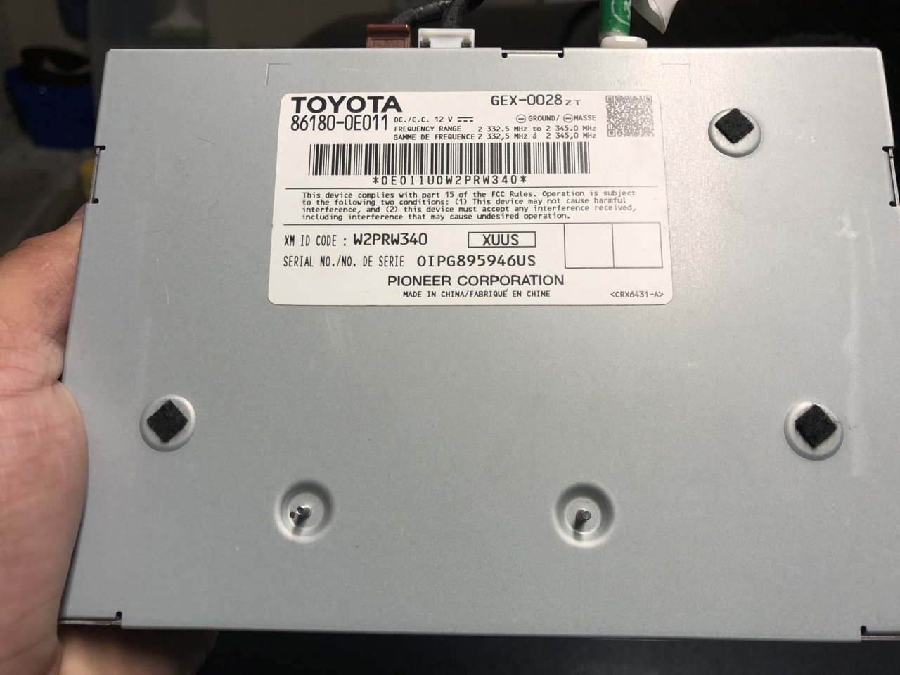

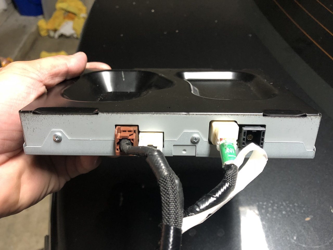

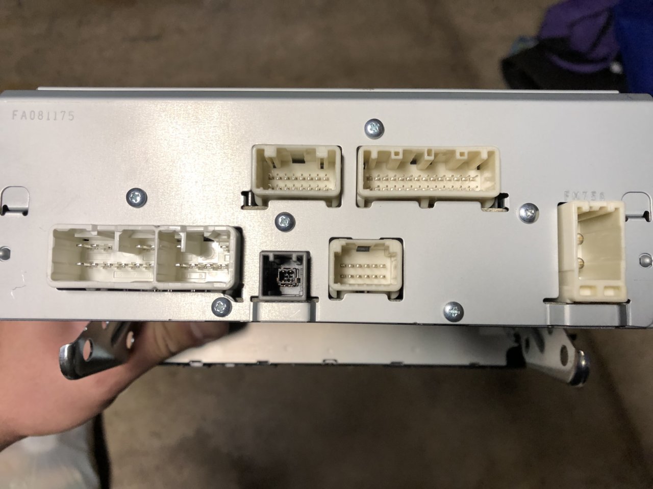

    I have an xm module with harness I don’t need from a recent radio i bought (2014+ radios)
    Module $120 obo
    And a 2013 Toyota Corolla touch screen radio with orange background I bought for my girls corolla but decided to go a different route if anyone interested
    C40B783D-4BEB-4F2F-A9FA-BF8327A2607A.jpg 42F1E550-9D43-44FA-9A73-59331AEF4913.jpg 6916BAD0-12B1-4DBC-87F7-BFC14DE497DD.jpg C2FBF220-2B7E-4067-A4CD-7529CC960AB2.jpg
    Radio $220 obo
