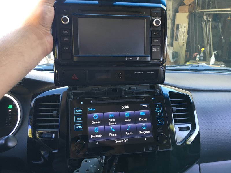

    EF1C7301-3E27-4E6E-BE80-EC49D96B7FFB.jpg AAB50487-9499-4DB1-B945-519C9646E4BA.jpg
    Finally got a working 3rd gen radio :rofl: it’s awesome that it bolts right up and plug and play!! Now just got to mod the radio surround to fit the new radio so I can have hazard lights and airbags lol :anonymous: (went back to the stock radio for now :thumbsup:)
