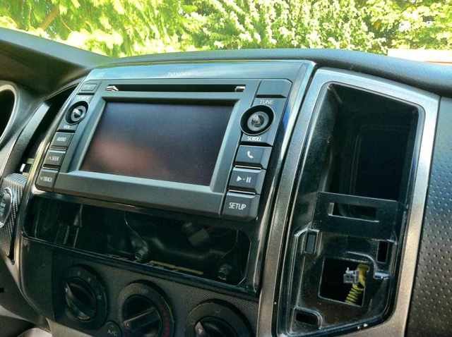

    i need to cut some of the dash to make the non entune in dash to fit

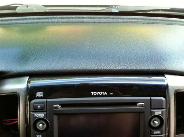

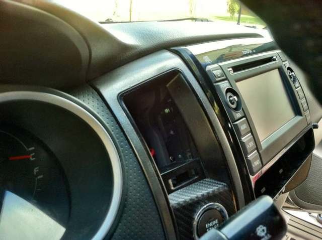

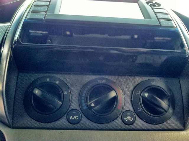

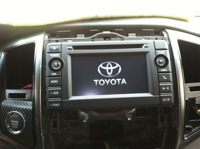

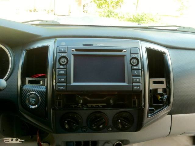

    Ok so I cut my surround a bit (yes I used a grinder becuz I couldn't find my dremel :anonymous: lol)
    And by doing that this radio sits about 1/4 in deeper having enough clearance to be able to bolt it down without having the top slide off :woot:
    That surround piece is a spare one I have...going to cut mine tomorrow
    No gap up top
    A super small gap at the bottom that I really don't care ;)
    Still a work in progress...need another harness and some other wiring to have this unit up at running 100%

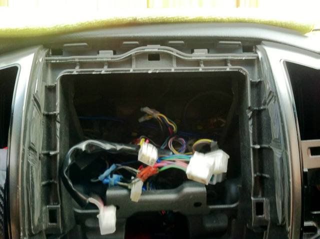

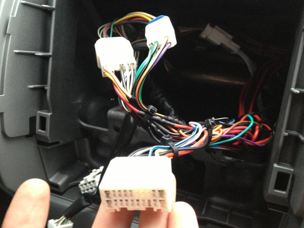

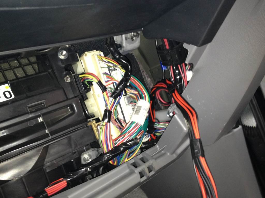

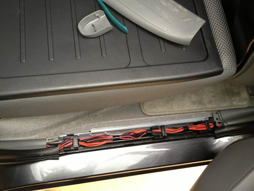

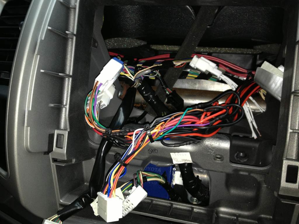

    Well I got my custom non-JBL to JBL Entune harness installed. Just waiting on my navigation unit to arrive with my household goods (just moved). More details once I start testing everything.
    The custom harness is 13 feet long from the rear amplifier to the head unit. I ran it along the passenger side threshold up behind the glove box to the stereo.
    Harness at amplifier. The third connector is in the mail now.
    Harness running along passenger door threshold.
    Going behind glovebox.
    Behind headunit.
    My custom harness that converts the non-JBL wiring that went to the old sustem to go to the JBL amp. Everything is plug and play, I didn't want to cut into any of the stock wiring.
    Like I said more details to come once I test everything.

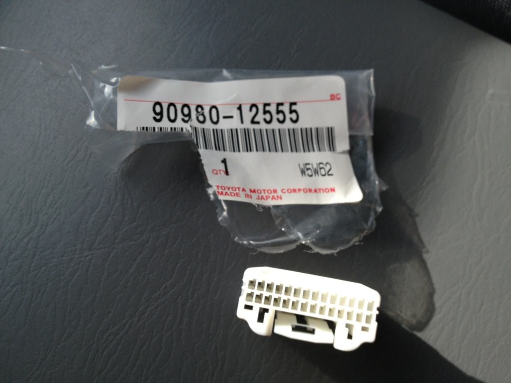

    so i found one of the plugs i need on the web just now ( the big one on the top right- 28 pin female)
    and in order to acquire 1, i need to order a minimum of 1000 :facepalm: damn back to looking..

    Jerez, here is the part number for that connector. I'm still trying to source pins for it though, buying a body harness off eBay to salvage the Toyota pins out of it haha.
