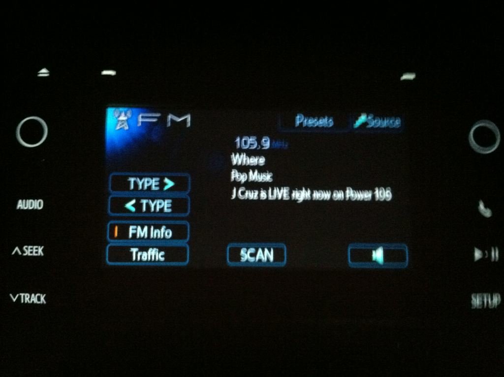

  18. Jan 2, 2013 at 7:34 PM
    #138
    Jerez
    Jerez [OP] SoCal LED Dash Swap
    Feb 1, 2010
    #30488
    17,998
    Rod
    Ontario Ranch
    08 TRD 2wd converted to 4wd
    Estock
    Found a antenna adaptor that works so now all I need is The wire pins and this radio will be up and running with backup cam and USB port :cool:
