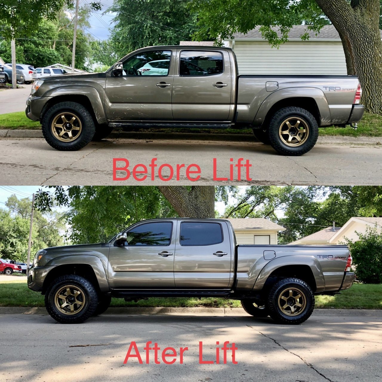

    For reference I have the OME Med leaf pack and 6112's on the front 5/4 clip settings. I didn't measure the amount it raised the rear (or the front for that matter lol) compared to the OEM 2015 leaf springs but judging off past posts I think its around 1.5" over stock. I still have a little rake, but nothing crazy. With a dirt bike and gear in the back (350lbs-ish total) it basically goes to level. Luckily you can often find used leaf springs on the classifieds page here for less than new. If you can get that TRD PRO setup, that would be the bees knees! Usually those go for about $1000-$1200 used FYI.
    If you end up with aftermarket leaf springs there are 2 options to level the truck out if the rake is too extreme. Remove an overload leaf from the leaf spring or add a lift spacer in front. Just an FYI going with lifted leaf springs in the rear. Pay attention to the fully extended length of the shock when installing the leaf springs when its on the jacks and after it is on the ground (and driven around to settle). The factory shocks (and standard Bilstein 5100's) are just shy of 23" fully extended. You will have a rough ride if it's only an inch or two away from full extension since there won't be much down travel when the suspension drops into a pot hole or something like that. They have shock extenders that can help with that, they just thread on the top of the shock where it mounts to the frame. They are very common in the Jeep community as well.
    Heres a picture of my truck with the 3rd gen suspension (before) vs the 6112's (5/4 clip setting), OME Dakar Med leaf springs and Bilstein B110 5100's (extended length) in the rear (after).
