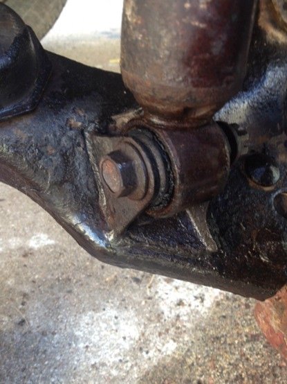

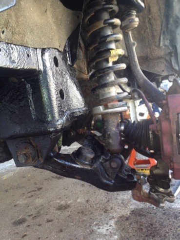

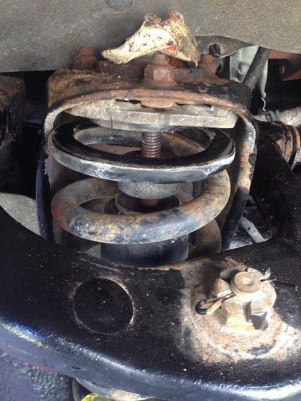

    apujebyz_a7991c32c24684d3fe1a7b63fce11aaf01dccc1c.jpgbugu5uzy_9550a3e792d33c3a4ff4e0b90ac097e01e049649.jpgbyhysuqu_4a72ae1fcf4ea64d9192b4b7233a60073dcfa3d2.jpg
    As you can see the spring is completely loose from the assembly, so it's not putting any pressure on it anymore, but I still can get that bolt to come out at all

    Bolt might just have rust holding it in. Spray with some WD-40, then use something hard and flat and hit it out with a hammer.

    So the problem is just that you cannot get the nut off the bolt?
    Can you get the bolt and nut to turn, or will the whole thing not move at all?
    I would try penetrating oil. Heat if that doesn't work.
    If it will turn, get a wrench on the castle nut and let it rotate until the handle of the wrench is against V of the control arm. Then put a long breaker bar on the head of that bolt and give it hell.

    Naw I got the nut off of it, I only put it back on so I don't mess up the threads while I pound on it.
    It's currently soaking in WD40 so we'll see how that turns out. Thanks for all the help!

    He was able to get the nut off, but the bolt is spinning inside the bushing and it doesn't want to "slide out". He even tried heating it and pounding on it. I told him to put the nut back on just enough so when he hits it with the hammer it won't jack-up the threads on the end of the bolt. Just soooo odd with what he is dealing with:confused::confused::confused: And yeah, very, very similar if not the exact same suspension setup as my 1998. It looks very similar!!!

    The bottom bolt!!! It is spinning inside the bushing and it won't push/pound out!!!??? He's even tried heating it and still no go?
