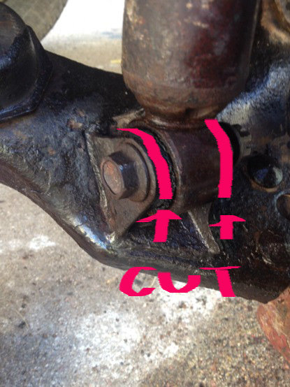

    sawzall the rubber bushing all the way through the metal inner bushing and the bolt on both sides inside of the mounting tabs.Replace shock and bolt and keep on trucking.Unless you have a torch and air hammer.They can be pretty stubborn.The bolt is seized to a metal sleeve inside the rubber bushing.

    The bottom bolt that holds the strut to the LCA ?

    There's just not enough room in there to get a sawzall in there without removing the whole spindle I don't think:/ I really don't want to do that. I will try a BFH tomorrow, all I had at home was just a small hammer.

    So the nut/bolt itself is free & loose, just won't unthread ?? Get the biggest /longest wrench on the nut & use impact socket on bolt head w/long ass breaker bar & slide a 3ft-4ft pipe over it & start applying pressure & just when you start thinking somethings going to break give that pipe a "balls to the wall" pull,if that doesn't do it the threads are run & not going to budge, no problem , secure the bolt so it stops spinning , get an angle grinder w/cut off wheel & start cutting down the bolt head as much as you can, finish it off with a grinding wheel, take it down till you just start into the mounting flange (just a little contact, you should be able to get a good hardened punch with a single jack (sledge hammer)& blast that miserable POS bolt into the next century by then...

    The nut will come off the bolt completely, the bolt will also spin freely within the mount holes. I think TacoLlama is right, it must still be seized to the metal inner bushing. Maybe if I pound on it with a BFH and heat it up it might break loose.

    Correct, they are. But if it really is the bushing holding tight I burned out my UCA bushings with a propane torch.

    Yeah the torch I was using was just one of those cheep portable can torches, it heated the bolt sufficiently enough to separate it from the rubber bushing

    If the nut comes off & the only thing holding it in is the bolt siezed to the metal sleeve ?? That shit is thin as hell really, torching is a possibility just plan on new bushing /sleeve & I'd be damned careful about heating up that strut too much, excessive heat+ gas charged shock= BOOM regardless if its an inert gas...You can do it how ever you want, I'd still just cut the bolt head off, or you can spread the mounting flange enough to get a cut off wheel to the inside for a cut as well...

    Try this as well before going to the torch, get a wedged chisel & start pounding it in between the strut & mounting flange, something will give, most likely the bolt will seperate from the sleeve..

    If you have a big enough drill bit you can drill off the head of the bolt and drill out the bolt on the castle nut side.
