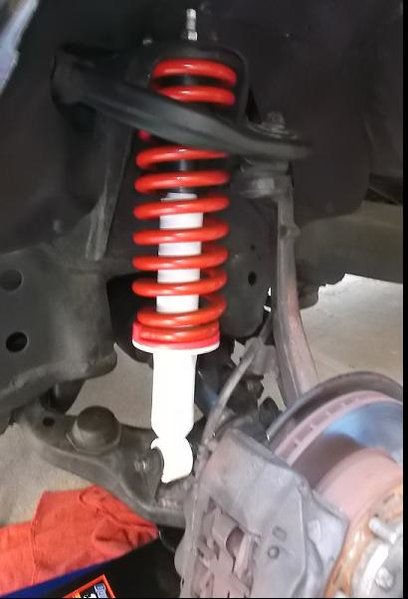

    Went to Home Depot first thing in the morning to get a propane bottle and a few other items. The only LCA cam bolt I had an issue with was the driver-side rear LCA cam bolt. I had to heat it up a few times and try moving it. Finally saw movement, let it cool a bit and then sprayed the PB Blaster on a bit, let it sit for a couple minutes... just continued this process and finally "cracked" it open:D The crappy part, I lost my marks for that rear cam bolt and now my alignment is WAAAAAY out. Wasn't much I could do and didn't get too pantie twisted about it. I was just happier than a clam that I was able to loosen the cam bolt and not have to go the more drastic route:D Yeah, it was on there pretty good and DREAD the next time I have to deal with seized bolts:eek::(:mad: At least I have an idea on how to approach them now and have learned do's/don'ts from you guys. Thank you guys. Now I have to see how bad my alignment is out:confused::eek:
    On to the next "project". Also, I finally took some pictures of my truck and will be posting them in my "inbox" or whatever the heck it is called for my "gallery". Anyways...
    btw, I painted the coils red... just to do it. Putting make-up on a pig, I guess:p;):rolleyes: Anyways, I like it as it goes with the white very well. Take care people.
