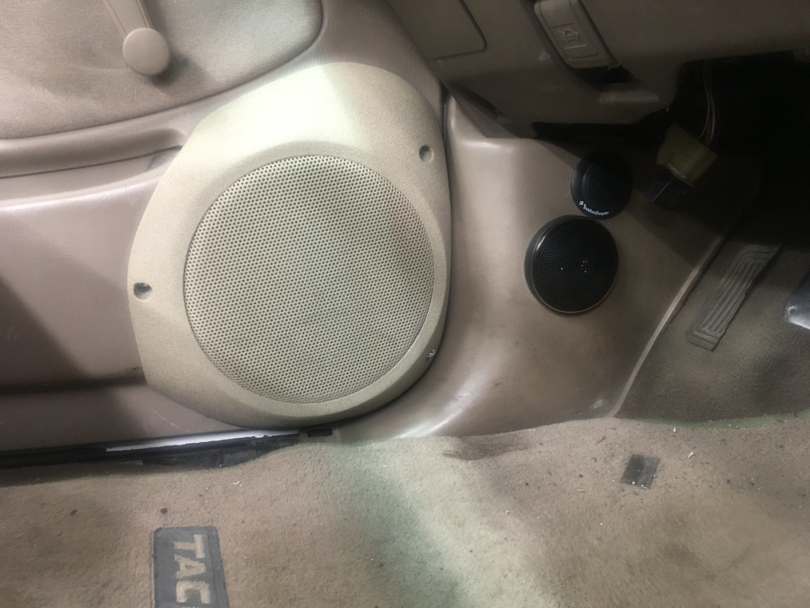

    I built these speaker pods for a pair of 8” Morel woofers, I wanted some door speakers with really good bass response as there’s really no room for an easy sub solution E7DE20C8-6236-47E0-A056-0CF2B775EC5D.jpg 8403147D-73F9-4E82-A501-B2D121BCA413.jpg
    I installed a pair of soft dome mids and tweeters in the kick panels and the system is biamped with a 500 watt alpine amp for the woofers and a 500 watt arc audio amp for the midranges and tweeters. I have an old school alpine head unit that goes in tomorrow.

    Most impressive single cab any gen speaker installation I've ever seen.

    Thanks! It should be very easy to tune because all the drivers are nice and close together, so there shouldn’t be any need for any time alignment. The door pods were the hardest part. With the very small cabin it should sound really good. I still need to tighten up the install of the amps tomorrow

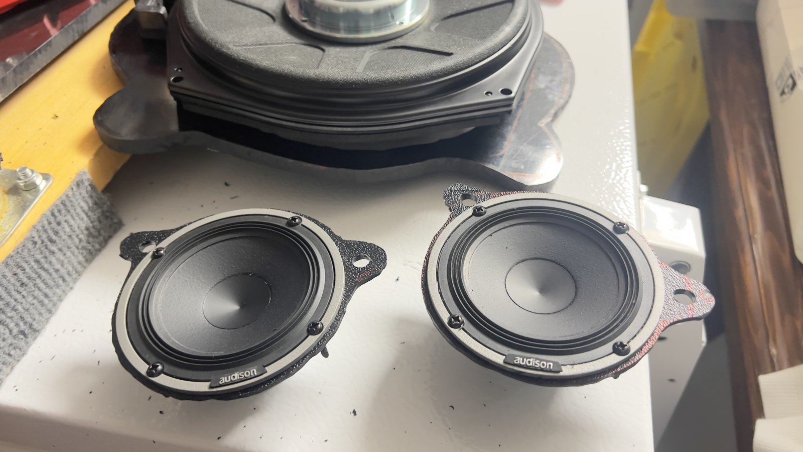

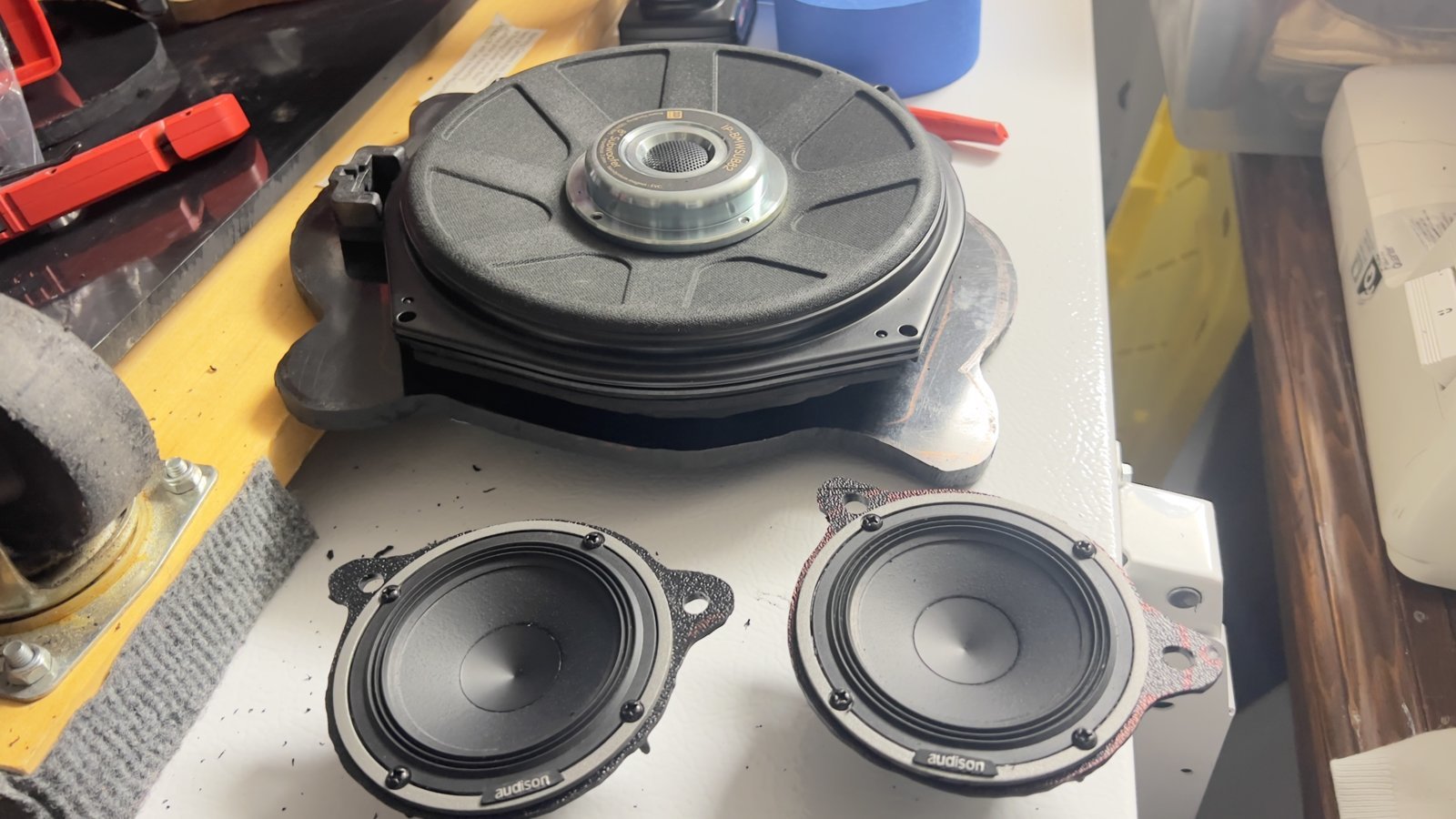

    Man what a coincidence I’m about to start an installation of 8 inch Morels are yours installed in the door using the whole door as an enclosure or did you built a separarate sealed box within the door.
    I hear a lot,of cons as being too boomy and excessive rattles out of the door -what is your opinion
    I wanted to leave my 6.5 Audison voces,in the doors and make enclosures and fit them under the doors. Based in your exèroience should I stay away from the 6.5 mid range? I will have 3.0 inch in the dashboard and already have the tweeters mounted on the door a late mouldings

    This would be the three way set up if I take out the 6.5 midranges out of the doors

    Having a closer look at your pics, are those the morel integra 8” coaxials? Mine are just the just the msw 265 shallow mount woofers.
    Edit: Ah ok I see what you have there, they’re under seat bmw 2 ohm subwoofers. Not sure if they’re designed to be in a sealed or ported enclosure without looking at the TS parameters. I would research what enclosure bmw uses for them and try to copy it the best I could. It’s most likely a tiny sealed box with a lot of polyfill or possibly an aperiodic membrane enclosure. An aperiodic enclosure is a very accurate design once you get it turned properly. What it is, is a very small enclosure with a vent that is stuffed with fiberglass to tune it, so the woofer will perform like it’s in a much larger enclosure. Looking at the frequency response of these, they play all the way down to 20hz so I would try to figure out a way to use them strictly for a sub and try crossing them over to the Audison mids around 60 to 90 hz depending on how close to the mids you can get them installed, the closer they are to the mids the better and you can cross them over at a higher frequency which will help the midrange sound much better without trying to play the lower bass frequencies. I’ve never seen those, pretty cool! https://www.ebay.com/itm/1450203197...72J4wUFRk-&var=&widget_ver=artemis&media=COPY
    An Aperiodic membrane would probably be the best solution for your application because you could make a tiny enclosure and vent it to the inside of the door stuffing the vent to tune it, then also stuffing the door to keep it from interfering with the midrange.
