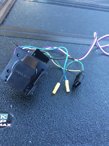

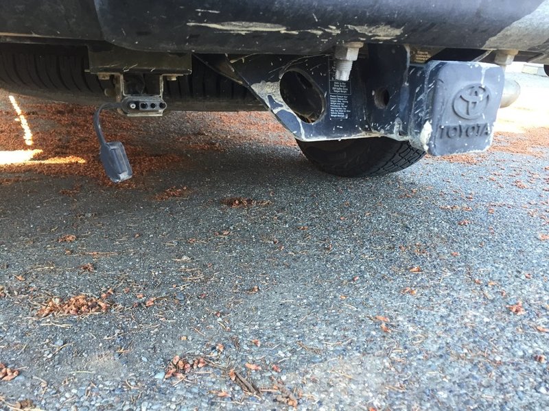

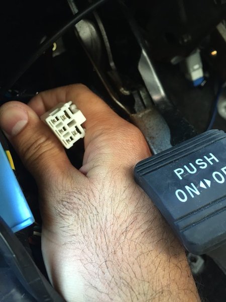

    I have a 2011 Tacoma with a towing package. I ordered it with the towing package and I drove it off the lot brand new with it installed (not sure if that makes it factory installed). I have a 4 pin trailer connector on the back and want to install the 7 pin so I can use the brake controller for a camper. I have the connection under the dash for the brake controller and the 4 pin to 7 pin conversion part. Where does the black and blue wire from the 7 pin adapter connect into the truck? I feel like if the truck already has wiring for a brake controller in the truck, then there should be a connection outside too.

    so what is the brake controller connector for and where would it go?

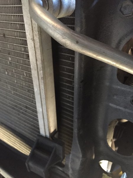

    OP, take a look under the hood and see if you have the oil cooler and the tranny cooler. If you do, you in fact have the towing package and your trailer harness connector is weird and can be replaced. If not, you do not have factory towing.

    Looks like I have a tranny cooler and I have the connection for the brake control, just need to put on this 7 pin adapter but I don't know where to tap it the blue and black wires to the truck

    I know the brake controller connects to the connection, but how do I get that to the camper brakes?

    I know this may sounds like a stupidly obvious request, but when you look back there near the connector, is there anything back there that looks like remnants of a trailer harness? I could be mistaken, but based on what you've said so far, it looks like you have factory towing, but someone hacked up the original harness and replaced it with a 4-pin. If that's the case, there might still be connections back there that you can simply just extend and reconnect.
    Once you have the 7-pin installed, it's just a matter of putting the pigtail to your brake controller, then plug and play.

    I checked under most the truck, didn't see anything, that's why I'm stumped

    Did you find split-loom harness that carry the other wires back to the 4-pin? I'd suggest pulling the end of that apart to see if you have any black and blue wires hidden inside/cut/tucked up somewhere. Lower your spare too so you can see and get to everything better.

    Yeah, if you could trace where those wires from the 4-pin are coming from, maybe even post a few pics, that'd be helpful.
