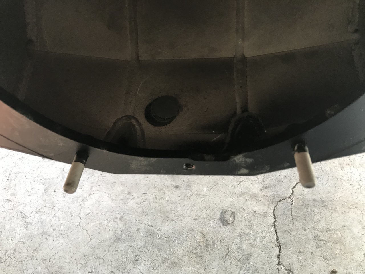

    I'll admit that I was eating while reading, so kinda skimmed some of it, so missed that part of the OP.
    So with that bolt there, you would have to remove the skid plate to be to remove that bolt correct?
    If it includes a standard drain plug, that is still there right? Or is that not what I am seeing in those two pictures?

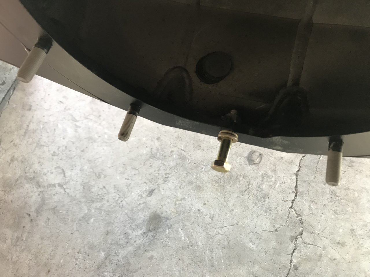

    There is no drain plug (it's an option you can add, but like I said, I did not like how low it was).
    I made a drain plug out of the bottom stud. Skid comes off in 20 seconds. I dunno about you, but I use power tools.

    The way the picture looks, looks like a drain plug there, but I now know that there was no drain plug at all on the housing to begin with.

    If you are referring to the black circle inside the housing, that’s a magnet.

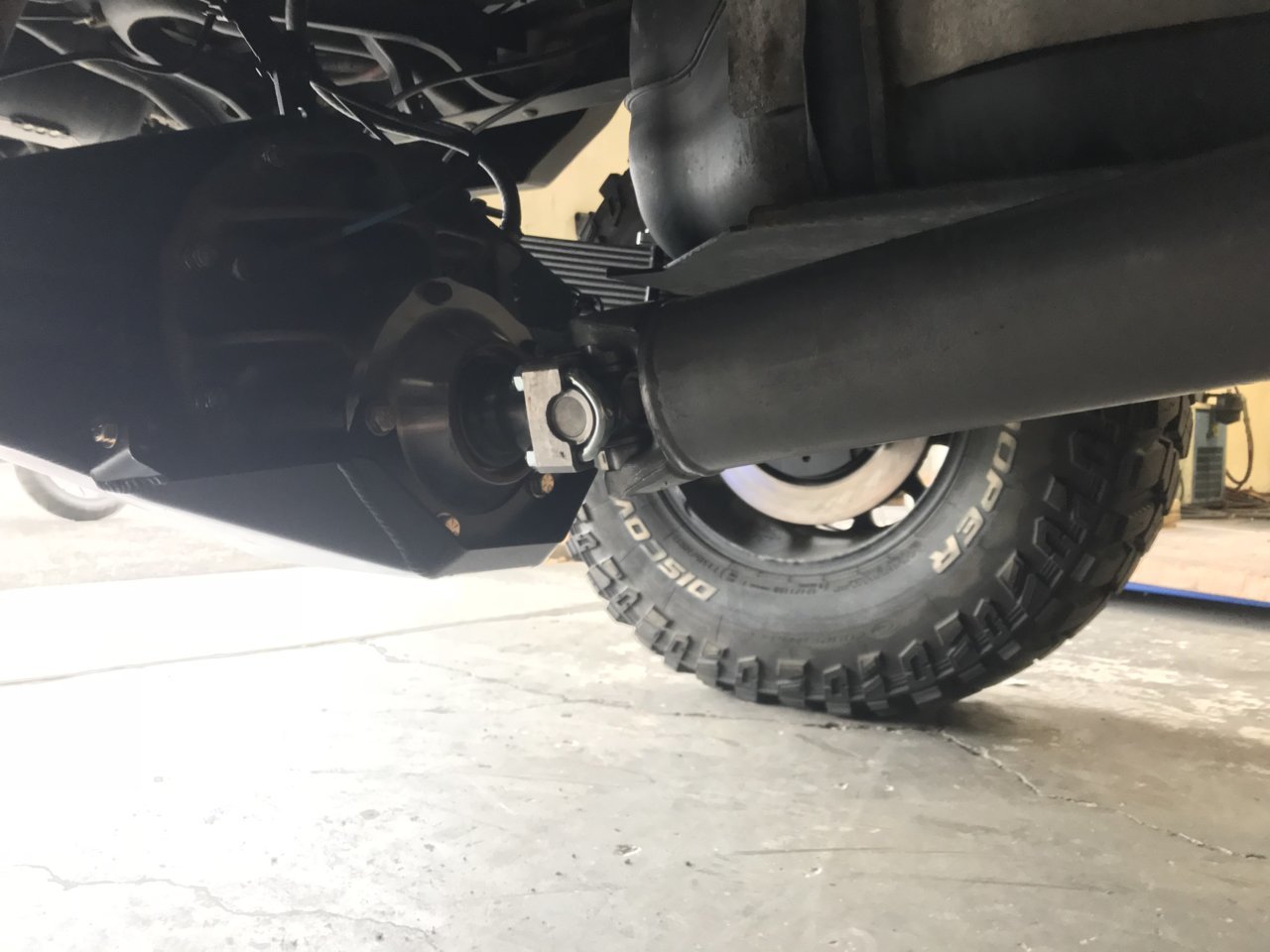

    Driveshaft extended and we went with a strait 1350 u-joint. Time to send it...............
    Fernando, Gply, Torspd and 11 others like this.

    What prompted the change from the adapter ujoint? Had to get it changed anyway so screw it?

    Exactly. Had to be re-tubed and weld the end back on anyway so did full 1350.
