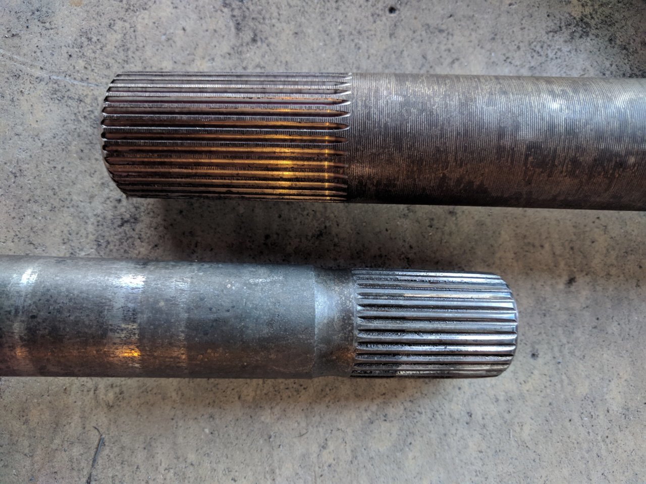

    The 9" is a nice axle and definitely a better diff but the regular 31 spline axle shafts arnt really any stronger then stock Toyota stuff. Did you go 35 spline?

    Currie's Tacoma OEM abs sensor compatible axles come standard with 35 spline axles.

    Nice! I wasn’t aware of that. I haven’t really looked into them as I’m running fj80 stuff in my first gen.

    OEM vs Currie

    Do 35 spline axles replace 31 spline without modifying the diff?
