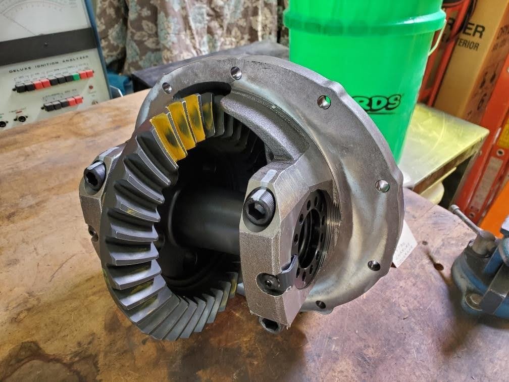

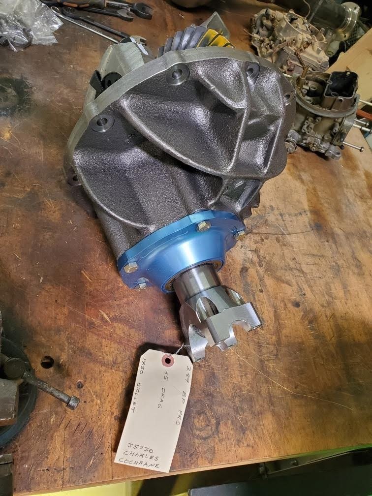

    US Marine
    US Marine Semper Fi
    Mar 24, 2016
    #182227
    14,744
    Chuck
    Gallatin Tennessee
    02 Pre Runner supercharged 4cyl
    TRD supercharger , Doug Thorley header , K&N CAI 265/75-16 Toyo open country mud terrain , 15x8 Method Racing wheels , Rancho 3" lift , 4.88 gears , Detroit Locker
    Nice looking fab 9 from Currie !! :thumbsup:
    This is my 9" Ford from Quick Performance i had built for my Camaro and capable of supporting 1500hp
    It has chromemolly tubes with big bearing ends and braced to increase structural integrity . Two center sections , one for street use and the other for drag racing . Both have Yukon lightweight housings Billet pinion supports , Billet yokes and lightweight Billet full spools set up for 35 spline axles and each have 3.89 gears
    The only difference in the center sections is one has a soft gear set up for drag racing with a Transbrake
    Resized_20200805_132609.jpg Resized_20200805_132722.jpg Resized_20200806_150943.jpg Resized_20200806_150934.jpg Resized_20200820_184928.jpg
    malburg114 and RedFiveaz like this.
