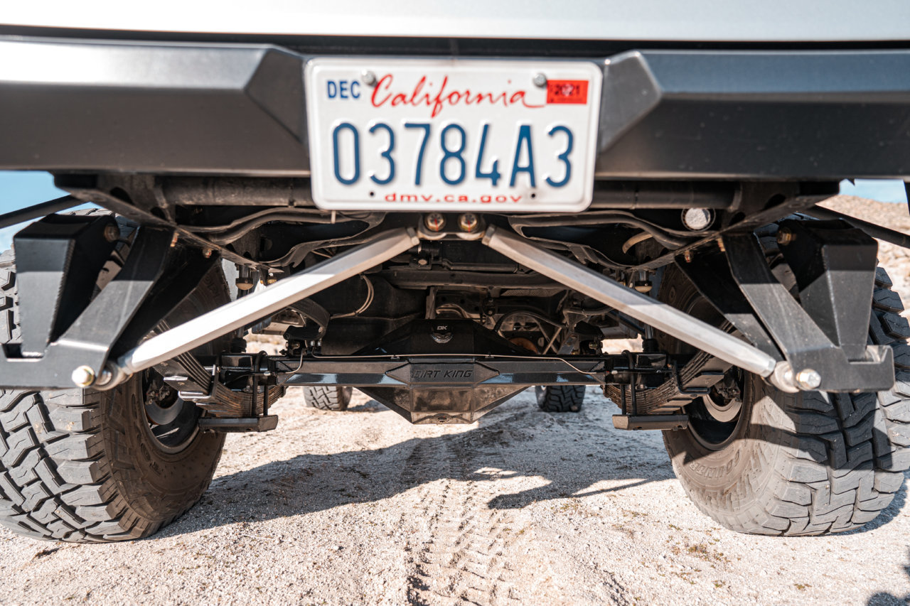

    Could do a trail gear 9 housing for $2600 and put a piece of black tape over the dash to hide all the abs lights :D

    You can literally buy the complete kit from trail gear and use unit bearings. Be everything minus a third. Or buy a bare housing and use the solid axle industry kit to use a spindle and bearings and hubs and then source a third and brakes and shafts etc.
    Plenty of information on the webs about building a 609 rear axle. My build has a pretty good list and pictures of building one using the solid axle industry kit
    Jcyr[QUOTED] likes this.
  15. Feb 24, 2022 at 4:40 PM
    #155
    malburg114
    malburg114 Well-Known Member
    Dec 26, 2012
    #93766
    3,774
    Las Vegas, NV
    2001 Toyota Tacoma TRD
    But here’s the trail gear axle with ends welded on shafts. Just needs brakes and a third.
    https://trail-gear.com/axles/rock-a...-assault-9-rear-axle-housing-with-shafts.html
    or a roller and you weld the ends on
    https://trail-gear.com/axles/rock-assault-9/rock-assault-9-rear-roller-kit.html
    I used the solid axle industry kit because I can buy everything from an auto parts store. Besides the inner shafts. And trail gear has one that will work with my short side. And the parts from my front axle interchange with the rear.
