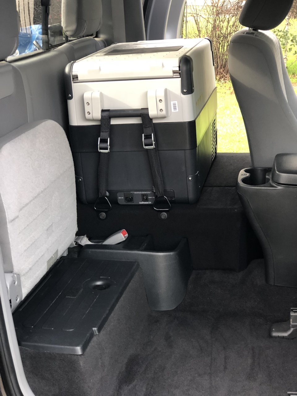

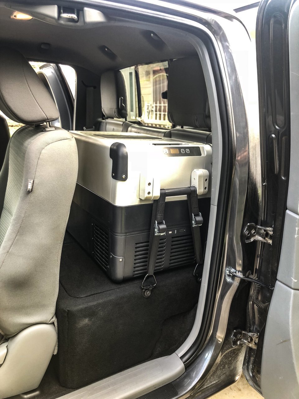

    Just made this for about $45.0041C62C7C-CBC4-4EA7-9BAE-91D860ADDE03.jpg D0B670E0-B5E5-4888-A608-C9F68803D298.jpg

    any details on the platform build? I'm looking at trying to add a fridge behind my seat on my AC.
    Im short AF, so room is no problem for me...what size fridge is that?

    I don’t have exact specs. I basically would trial and error the pieces until it all fit together.
    Used some small wood screws to hold it all together, and glued it. Covered it in black speaker carpet using staples and 3M fabric glue.
    It’s tall enough for me to be able to put in a standard car battery in, which is going to be the area for all the electrical.
    The fridge is a CFX40 and it fits pretty well, I can open the lib pretty much all the way.
