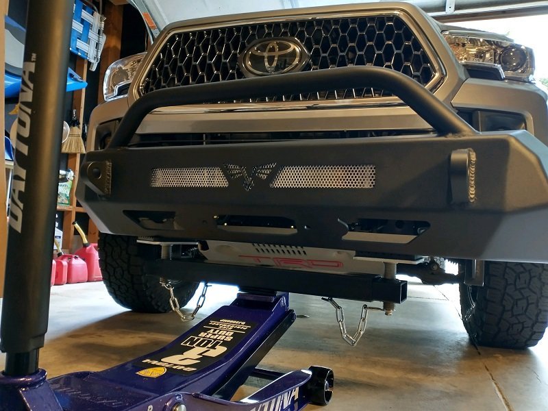

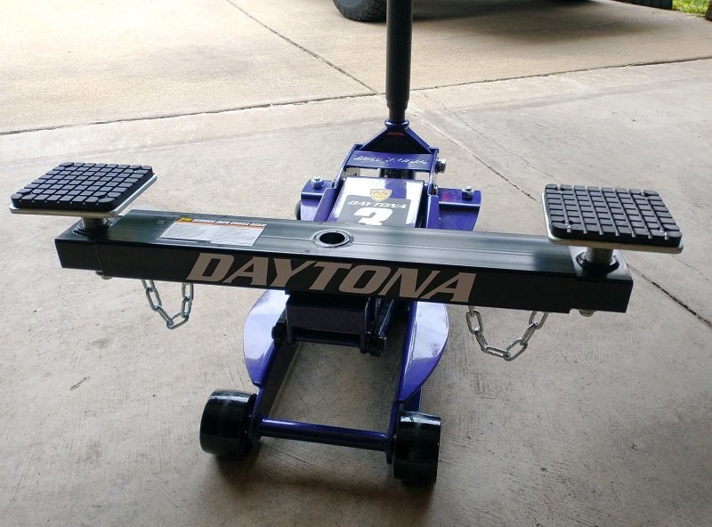

    -Rorschach-
    -Rorschach- The Black Helicopters are coming…I gotta go!
    May 8, 2020
    #327337
    5,843
    2019 Silver Sky Metallic Tacoma DCLB TRD OR 4x4
    I bought a cross beam attachment for my jack, its come in handy around the garage. The wing lengths are adjustable as well the pad heights in case you are using it on something uneven.
    Just recently used it to help install my front bumper.
