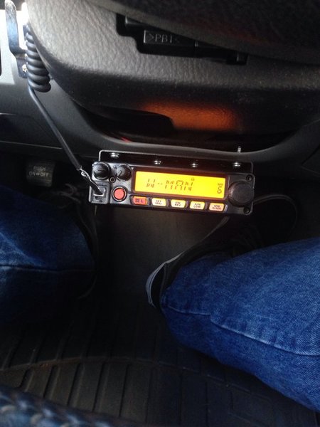

    +1^^^^ Make a little bracket to span between the rails if you are dead set on mounting it there. I have a yaesu ft1900, which has no separation kit. I had to mount the full deck in my view, so I mounted mine under the steering wheel. I don't have a picture of it, but it looks like it gets in the way, but I never hit it will my legs and I'm 6'4". Easy access and in close reach.

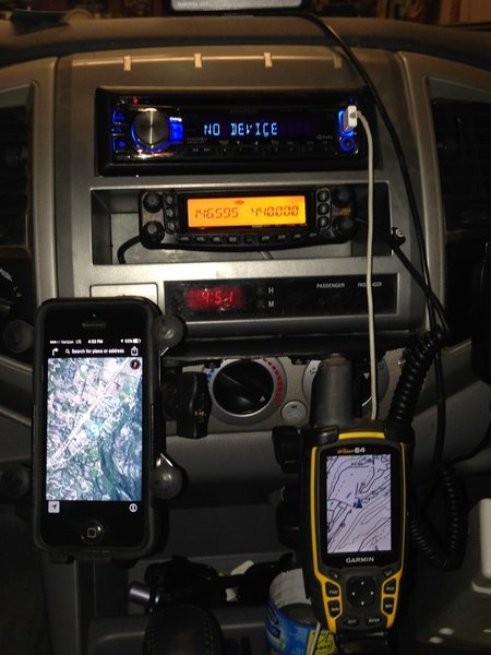

    Here is where I mounted mine, finally took a pic of it.

    Not a bad spot to mount...for the off road driving we do, I would want to shore up the mounting area with something substantial, maybe a metal bracket behind the plastic to sandwich between the screws?
    Road and off road vibration might wreak havoc and eventually fatigue and break down the plastic dash...just a thought.

    Good point. I haven't had any issues with it. I have pretty big washers on the back and loctite'd the threads. Its been on there for well over a year and never had any issues with it and my truck sees a lot of dirt and crappy roads.

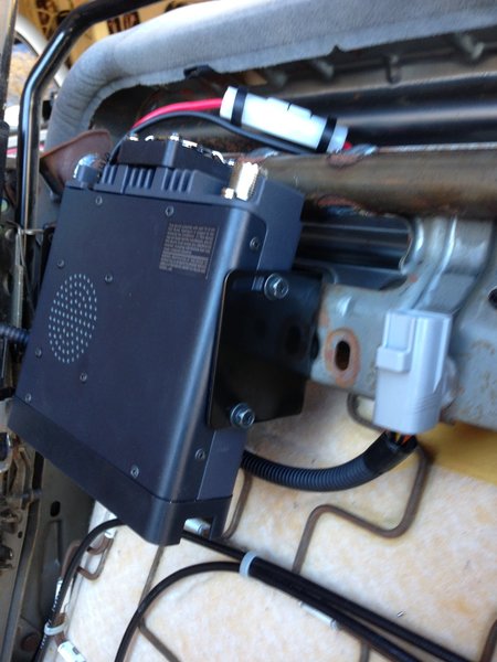

    Just a quick update. I'm guessing you already mounted your radio, but I bought a new ft-8800r with a separation kit. Mounted the unit under my seat, but to the seat and it took zero modifications to mount it. And the interface for it is mounted below my FM radio.
