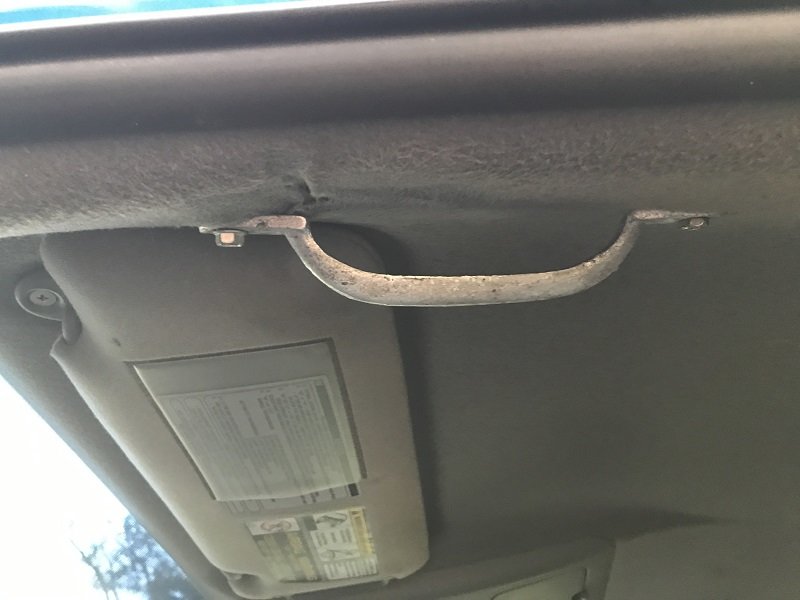

    Hi everyone! I currently have a 2009 Taco access cab off road. It is outfitted with hand controls and a lift to put my wheelchair in the back. I am in a wheelchair (obviously) and have to use a grab handle that was installed over the driver's door where the airbag is supposed to be. Well, the guy that installed it is no longer around and most mobility dealers will not mess with airbag modifications or removal. So a buddy and I are going to try to put this in my new truck.
    I purchased yesterday a 2017 Taco access cab off road which is going to get a similar lift and hand controls, but I still need to install the grab handle. The airbag can be removed I think and just have a shunt installed in the circuit to tell the computer the airbag is still there.
    Does anyone have any experience in removing an airbag (not deployed) from a new truck. Which shunt should I consider? Is there a procedure I should follow for doing this. Is there someone I should consider taking the truck to to have it done professionally?
    I am in Central Indiana and could use whatever help I can get. Thanks guys!!

    To get the airbag out you're probably going to have to lower the headliner, going to have to take out all the pillars, sunvisors, overhead console and rear dome light. Then unbolt and disconnect the airbag. Then you can find a mounting spot for the handle while you have the headliner dropped. It's not that big of a job just a little time consuming.

    I'm not sure a shunt would take the place of an airbag.
    I had an older vehicle that was affected by the Takata airbag recall. The airbag had the potential of shooting shrapnel, but no airbag recall replacements were available at the time. So I disconnected the airbag connector at the airbag, and shunted it. The SRS dashboard light illuminated, so it appears it knew the airbag itself was disconnected.
    About a year later, the airbag was replaced under the recall, and the SRS light went out.

    And yes, I believe the shunt will work. That is what is in my 2009 Taco instead of an airbag.
