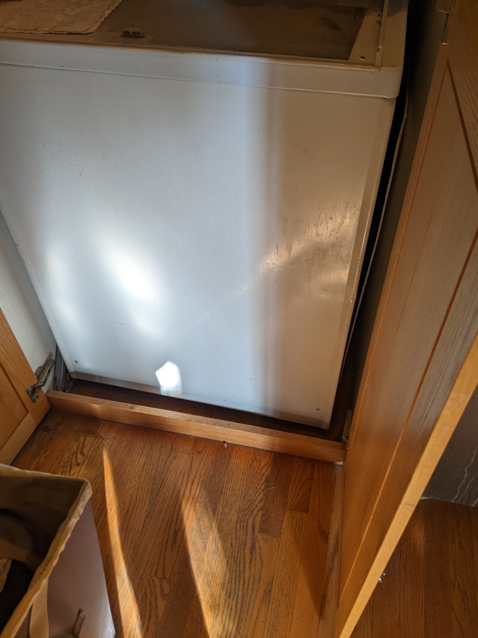

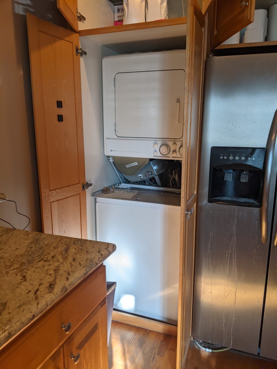

    I feel like I can always find a good answer to my stupid questions here, since you guys know your shit. I'm installing one of those drain hands underneath my washing machine, but it's a stacked unit that is built into a tiny cabinet. There is pretty much only a few inches on each side, in about 3 in on top. Zero access to the rear of the machine. It looks like the only way, is to remove the entire unit from the cabinet, lifted onto the drain pan somehow, and then put it back in the cabinet. That sounds good in theory, but the machine is heavy as hell so it will be difficult to lift, And I don't think I'll be able to slide the pan back in place with the washer on it. You guys got any ideas to make this a bit easier?

    Oof! That is a tight space. How did it get in there in the first place - especially over that lower lip of the cabinet?
    I'd take the doors off the cabinet first and probably use an oscillating tool to remove that lower threshold, but then find a way to put it back later so it is easily "removable" for service.
    Then, pull the unit forward just enough to tip it back so the pan can start to go underneath and then do some shimmy shimmy wiggle wiggle to get it under and in place.
    Good luck.

    I’d assume there’s an access panel at the side of the fridge.

    Man, the doors have been off so long that I totally forgot they were even on there. I pulled off the doors a while ago, and that little wooden curb was a giant pain in the ass. It was screwed and glued to the floor and the sides and was a real bitch to get out, but I finally got it. I think they put the washing machine in first, and then built the cabinet around it. My plan was to do pretty much exactly like you said, but the damn machine is super heavy.

    We thought so too, but nope. It's pretty much impossible to shut the water off behind the machine.

    If there's already a drain in the back corner and if it works, there's no reason to put a pan in.
    The reason for a pan is if the washer leaks the pan is supposed to contain it before it runs all over the house.
    Other than that the laundry center is behind the unit, tipping the unit forward you should be able to reach the water shut off.
    To reinstall with a pan if you go that way, install the pan and tip the machine forward pick up the bottom and put in the front of the pan, hook up the water & drain to the laundry center then tip the machine into place.

    Horrible install design, if you ever need to get into the dryer for a belt, bearings [rear], tensioner pulley, and the like, you need to access the top of the dryer to remove it and get to more screws. I'd rather contemplate shoehorning a Detroit diesel 11.1 liter engine into a chevette then figure out a way to get into that thing.

    There is a drain in the corner, and the installers tried to put silicone around the bottom cabinet, so they thought about it at least a little bit. But... If the washer were too leak, that silicone would last maybe 30 seconds and then the entire kitchen would be flooded. I feel like the plastic pan is just a safety net. Thanks for the "tips". I figured I would have to tip the unit into place, but there's pretty much zero room to do any of that And there's absolutely no way to get to the rear of the unit.

    Like I said (per the pic in first post) you have to tip the mach. forward rite up to the counter and crawl over to get to the hoses for service.
    Back in the day I installed more than a few of those stackable's some in places tighter than your's.

    i would cut that upper cabinet "shelf" and leave like a "U"-shaped portion about 3/4" wide, where the opening of the U is big enough to clear the dryer part when tipped, then cut a new "shelf piece that fits in there, resting on the "U" for your storage stuff above.
    heck, you could even screw it in, if you want more stability.
