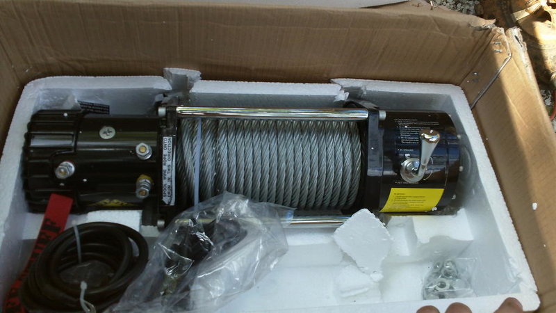

    Here is the winch itself.

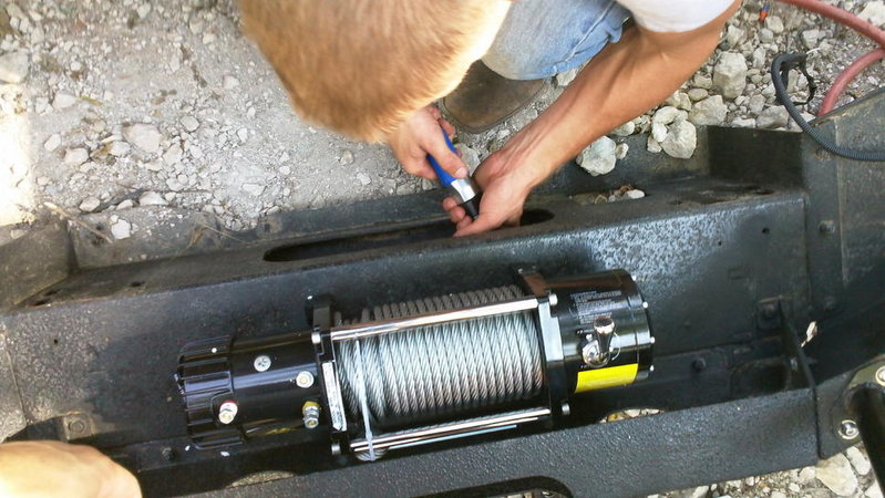

    There are 4 bolts that hold the winch on. The holes were lined up perfect from allpro. I think we had to drill out the ones for the Roller just a little bit.
    Here is the winch installed without any of the wiring hooked up yet.

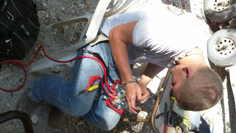

    The only real problem we ran into was the box for the controls goes on top of the winch and as you can see there isnt much room at all on top of it. So i found the spot with the most room and started cutting wires.

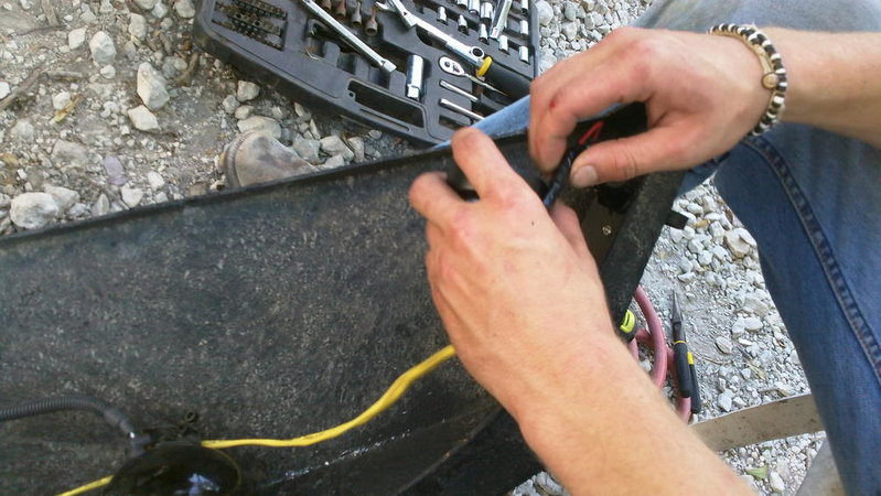

    This is where we took the connector for the controls and extended it with about 6 feet of wire so we could mount it anywhere on the bumper we really wanted to.

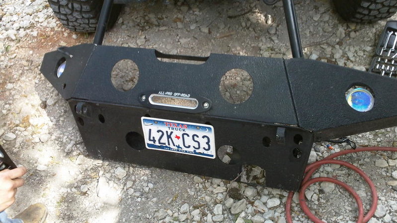

    I decided to put the connector here so, drilled out the hole and got ready to run the wires over to it.
    Reconnected the wires, and mounted the connector.
    Where i ended up installing the controller connector. That way if i need to use the winch i dont have to go around front and get into the mud or anything to bad, its just right there by the driver side door.
    Vwalla All installed and working.
