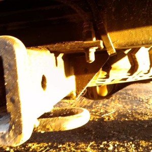

    Put the stands on the frame, take off the wheels and remove the spare. Work smarter, not harder. You will run into minor difficulties. Don't sweat it. It won't take terribly long and you'll be happy with the bags when you're done.
    Here's a pic of where I routed my valves.
    Easy to get to and they are out of the spare tire area. My original location had the spare contacting the hoses in a manner which would have eventually kinked the hoses.
