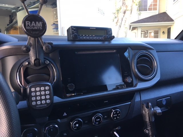

    Hi, Chief from a fellow EWC! I mounted the control head in a similar fashion as you did, but as you can see from these 2 pics, I actually mounted directly to the trim piece around the radio/vents. I find I like having it a bit lower than yours for visibility out the window. Am running a Larsen dual band through glass antenna mounted on the rear window. Works ok, but am thinking about a roof mount instead. Will be adding a CB soon, so will certainly be borrowing some of your ideas for that install!

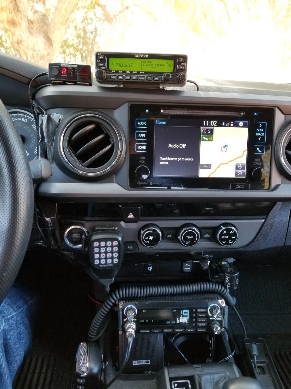

  8. Feb 26, 2018 at 11:27 AM
    #28
    EWCFred
    EWCFred [OP] Well-Known Member
    Nov 19, 2017
    #236430
    186
    Fred
    2016 Silver Tacoma TRD

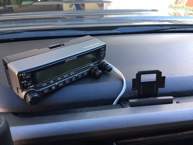

    Liking "sdwf"s Kenwood TM-V71 control head mounting on top of the dash (Post #23 above) much better than my own placement above the dash, I copied it with a minor change.
    Didn't want to trim the mounting's vertical adjustment brackets off the back to make it fit closer; just mounted the control head a little further forward, and a fraction higher.
    The ugly black tape holding the wire was for temporary mounting, until everything checked out.
    Cleaned it up after taking this photo; and you can find self-stick mounting clips for holding the wiring in hardware stores and on Amazon.
    Be aware the dash plastic material makes it very difficult to stick anything to it; including my ugly black tape. :)
    This photo and the next one below it.
  9. Feb 26, 2018 at 11:29 AM
    #29
    EWCFred
    Nov 19, 2017
    #236430
    186
    Fred

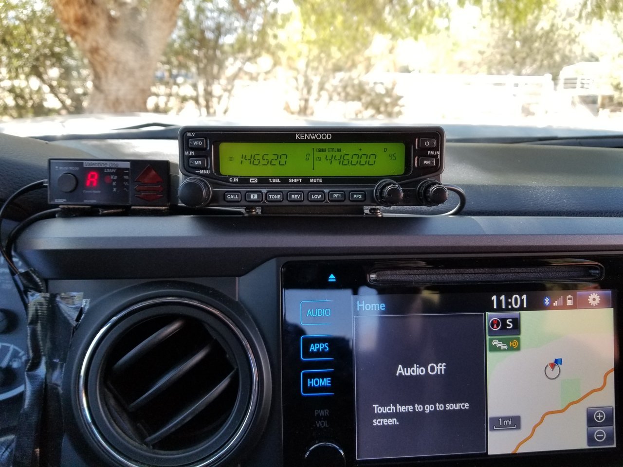

    Second photo of the new mounting location for the Kenwood control head.
    You can now also see the remote Uniden BCT-7 speaker I added below the CB for better audio out of the Kenwood Amateur Radio set. The new speaker fits perfectly there.
    73s, KG6ZMN

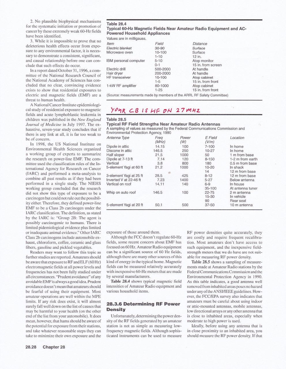

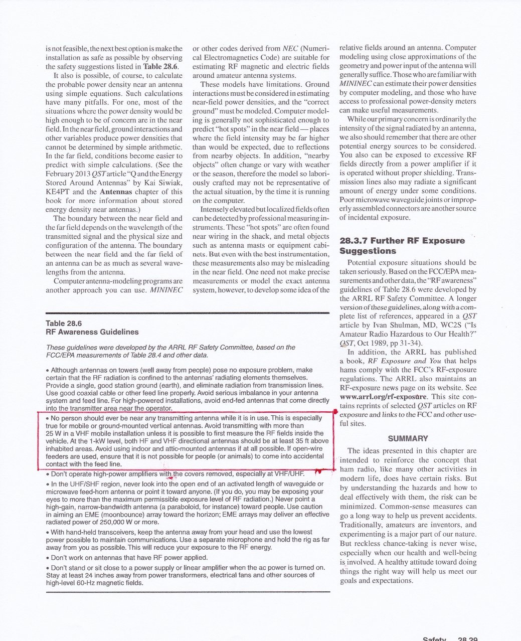

    RF (Radio Frequency) safety in vehicles.
    My reference is The ARRL Handbook (American Radio Relay league), Safety Chapter (28).
    Your CB is on what is known as 11 meters (11m) at 27 MHz. This is near the upper end of the HF frequency band (High Frequency).
    My Amateur radio is on both VHF and UHF, and my max output power is 50 watts; although, normally I leave it on the middle power setting, and don’t run at the full 50 watts.
    To calculate your exposure (All Frequencies) CB Is 27 MHz or 27.000. http://hintlink.com/power_density.htm
    Post #35 below is for a calculation of a one kilowatt linear amplifier at CB Radio frequencies.
    Post #36 is for a 500 watt linear amplifier, CB Radio frequencies.
    Post #38 is for a simple 100 watt linear amp at CB Radio frequencies.
    This is another reason why I would never install a linear Amp in a vehicle.
    Four pages enclosed; first is front cover of my reference, and this manual is available from the ARRL, Ham Radio Outlet (HRO) and other sources.RF Radiation Safe Levels 001.jpg

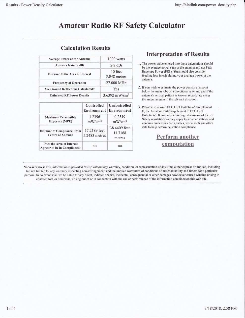

  15. Mar 18, 2018 at 3:05 PM
    #35
    EWCFred
    Nov 19, 2017
    #236430
    186
    Fred
    Example: This is what you get with a one kilowatt transmitter, on the CB Radio band frequency 27.000, Antenna distance 10 feet, antenna gain of 2.2. (A good CB Antenna with gain.)
    "Distance to Compliance" in the tables is the minimum safe distance for this power level.
    "Uncontrolled Environment" Are you near any highly Radio Reflective Surface; like a metal wall, or the hood of your vehicle?
    Note the difference between safe level power density, and your power density, at this distance.

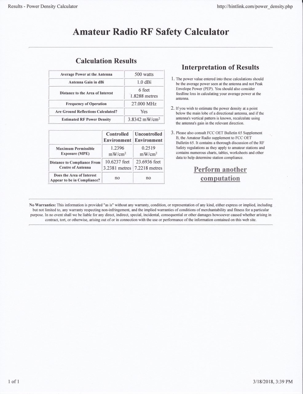

    500 watts output, CB Radio Frequencies (27.000 MHz), Antenna six feet away, Unitary gain antenna (No Gain).

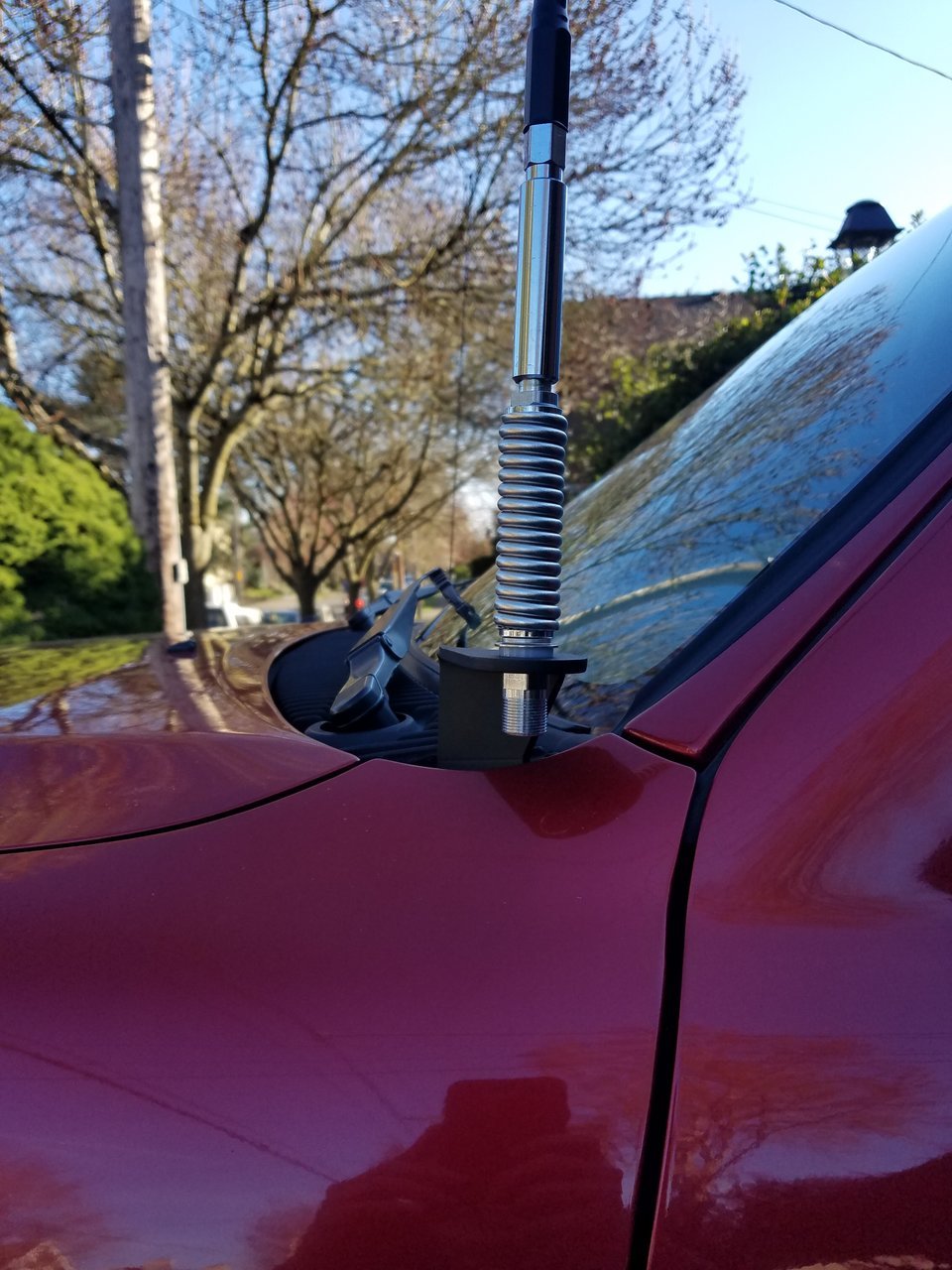

  17. Mar 18, 2018 at 3:59 PM
    #37
    jules04taco
    jules04taco Well-Known Member
    Aug 18, 2014
    #136422
    262
    Trish
    PNW
    04 xtra cab 4x4 TRD
    Camburg UCA, Kings, URD short shifter, K & N performance air intake

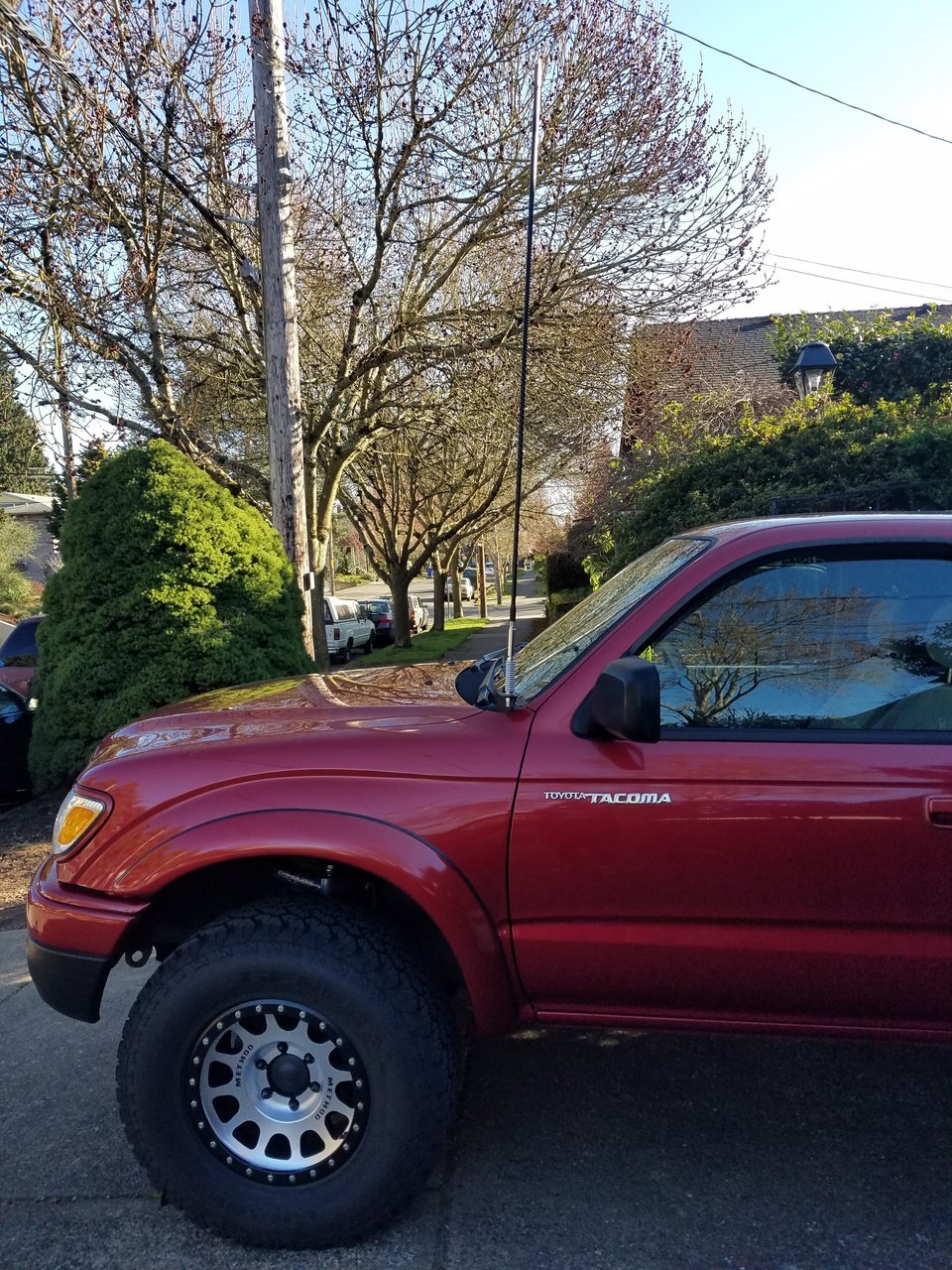

    I used a CBI ditch light bracket for mine 20180311_170549.jpg 20180311_170540.jpg

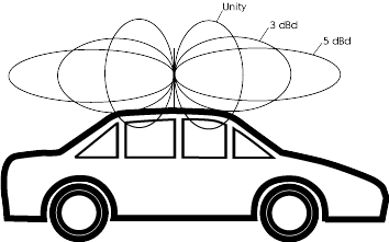

    It's a cartoon, but the principle's accurate:
    Now move that antenna from the center of the roof onto the fender right in front of the windshield, and the pattern moves with it. No matter the power level, I'd still rather be shielded by some metal, rather than have the main lobe hitting me in the face. The radiological health standards were developed based on risk to a population, not an individual. Some individuals get lucky -- I know people who have smoked cigarettes for 40 years and didn't develop lung cancer. I also know non-smokers who lived in a home with a smoker, and developed cancer. Personally, I'm not willing to bet that I'll be one of the lucky ones and not get cataracts or a tumor from a transmitting antenna mounted a few feet from my face.
