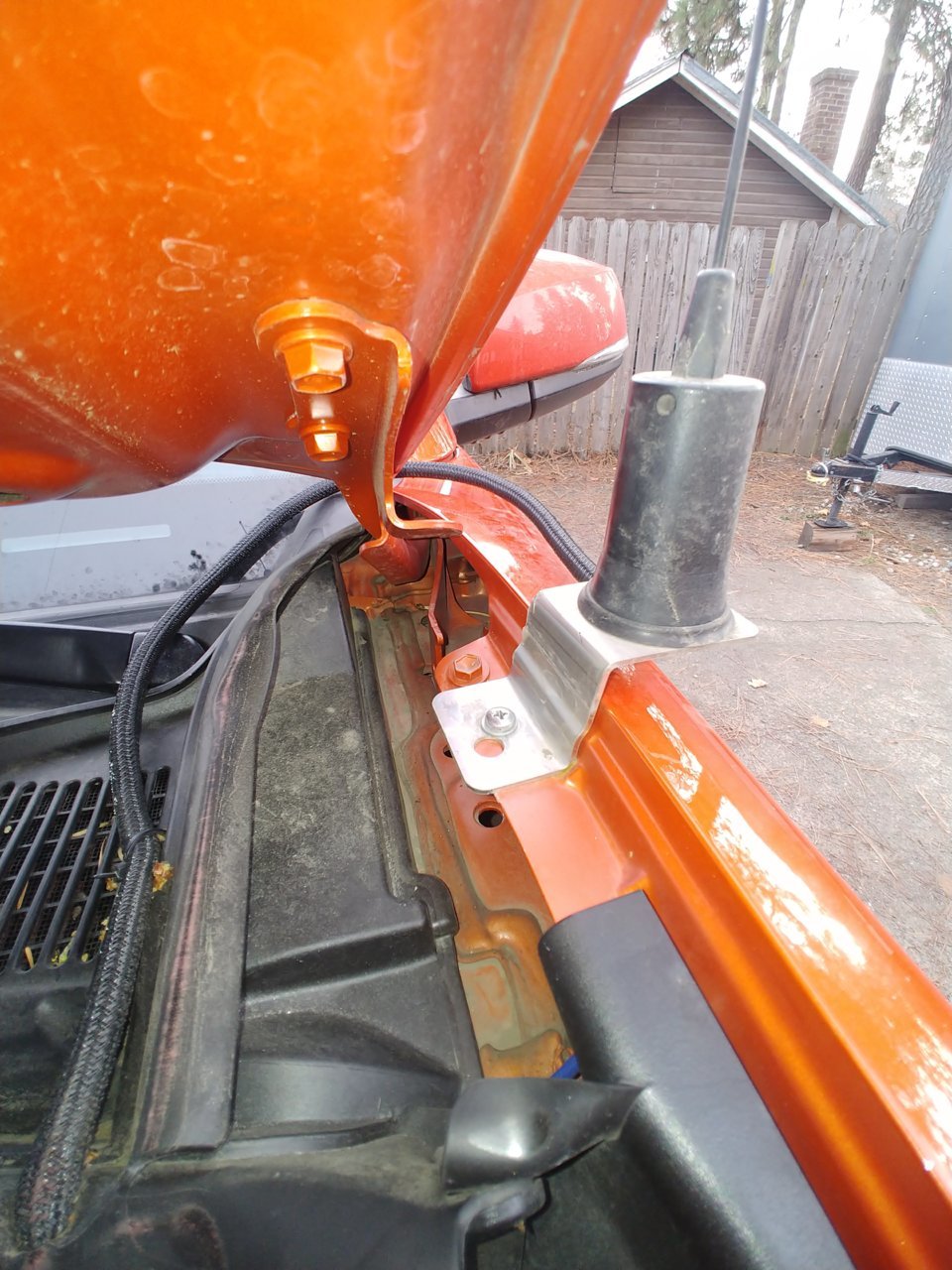

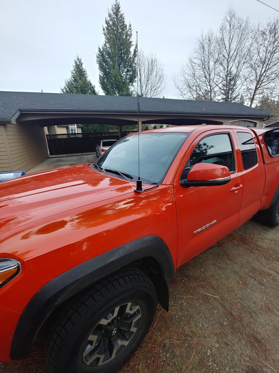

    Here's my wimpy little fender mount bracket. It works well for smaller 2/70 antennas but probably wouldn't be strong enough for most 11 meter/HF or bigger antennas. I'm considering putting my HF radio in the Taco. The antenna mounting point is my biggest concern. I'd be curious to see antenna analyzer data from someone using a ditch light mount for 11 meter or higher HF mounts.

    What antenna is that? Do you think it has enough flex in it to give if you hit a parking garage roof or something?

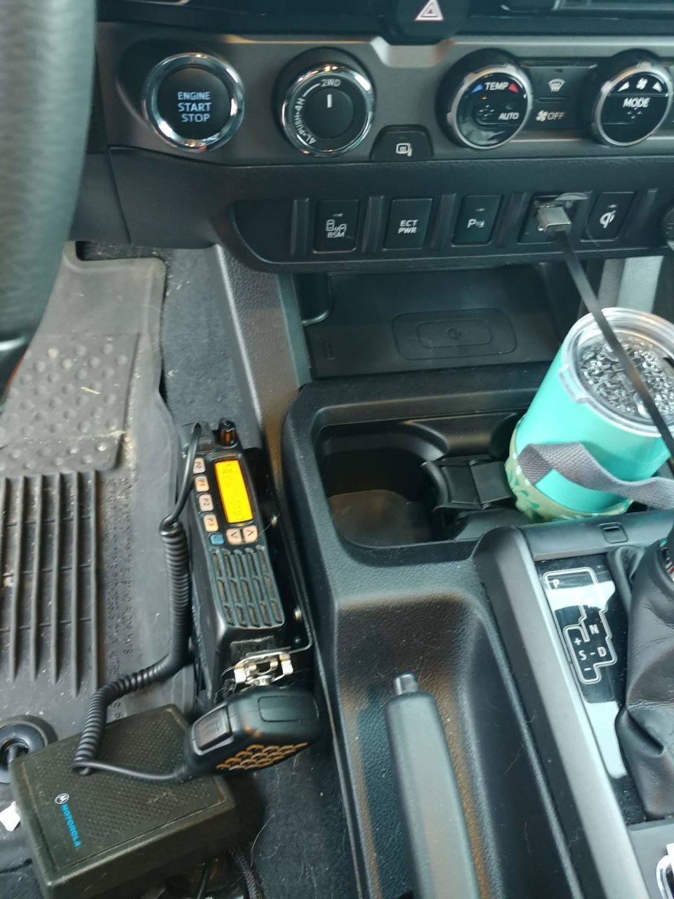

    It's a pretty basic setup.
    Antenna is an old trusty Larsen 2/70 NMO.
    https://www.hamradio.com/detail.cfm?pid=H0-000565
    It's flexible enough to bend for parking structures and tree branches without damaging the mount.
    My radio is a simple but bomb proof VHF commercial radio. An Icom F5021. Edit: I use a Motorola external speaker visible laying on the floor.
    For a single band VHF radio, I'd prefer a 5/8 wave whip. But the 2/70 antenna is shorter and more flexible than my 5/8 wave Comtelco.

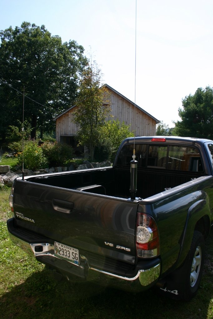

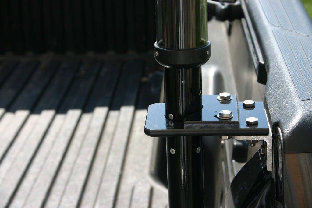

    Partially because of RF and auto electronics and because I did not want to look through antennas while driving they are all mounted on the rear. The screwdriver is 10-80 meters the other is 2-440 now with a matching one for DMR. Long story on the screwdriver but the mount is lexan because the antenna body is rf hot all of it so it can't touch anything conductive. There is a great deal of talk on ground planes but in the case of HF it's more about ground loss so the higher it is mounted the better off you are. I have over 50 countries mobile so it obviously works.

    You've got an ideal HF mobile setup. I've thought about a screwdriver. Do you have experience mounting it down below on the hitch? I have a canopy so a bed mount won't work. I see a lot of people with screwdrivers mounted to the tow hitch or frame. But I'm skeptical about how they function.

    Tow hitch sucks for one you need the coil to be in the clear that is the major length of the actual antenna there is a lot of wire wrapped around that coil. My antenna was once mounted up on a mount higher until the cheap fake (SS) cast brass Workman 3/8 20 coupler snapped off and the $400 antenna landed in the street good thing a friend was right behind me and picked it up. Other than a little asphalt rash it was fine. I installed a standard ball mount on the tailgate bulkhead and remove the tail light to wire it inside. All was good but it still shook I decided that really can't be good for it that's when I made the lexan bracket if you grab the antenna base you can shake the truck now. With the cap I guess you could mount it on the cap itself with a connector inside so it can be removed with the cap. You will of course need to come up with a ground to the mount but don't obsess over that you don't need a 4/O copper braid for your ground it is just a return path to the radio. The stinger is a screw mount it's too tall to fit under a 7'6 garage door. PS working HF mobile is QRP it is what it is but when the bands are open the world is yours.
