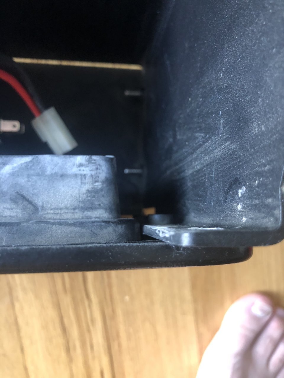

    [​IMG]For the door mount was the inner lip able to fit completely inside? Mine seems to be too long for their box. The spacers they provide dont fill the space completely When it’s on the truck

    that lip doesnt sit in between that the metal box like that.
    the metal spacers are thick enough to space that lip away from the expe metal box

    Yeah I did expedition essentials reach out And helped me.

    Nothing in the end, it just seemed a little weird but once everything was tighter down it was fine.

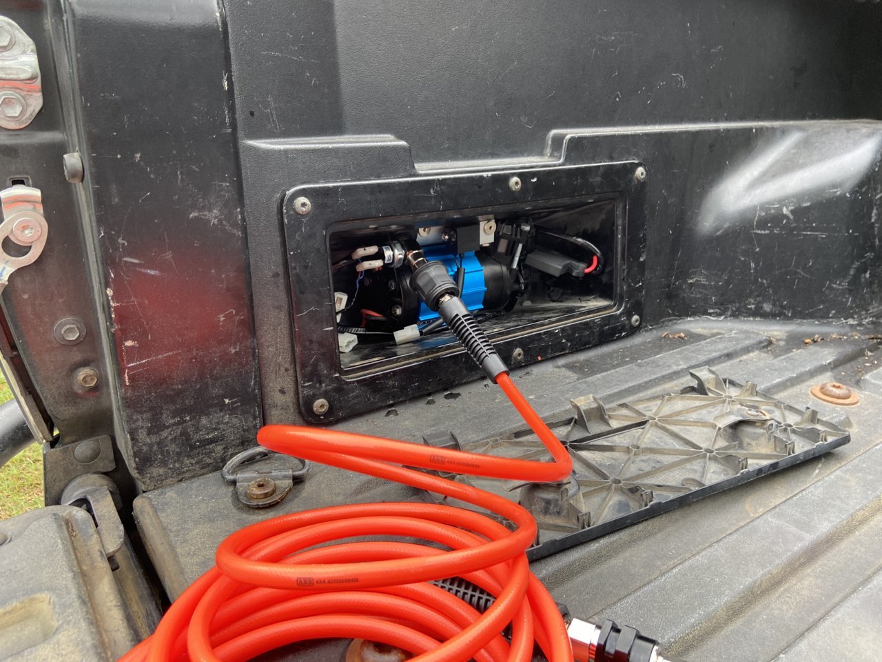

    Cool write up OP. I looked at this thread when installing mine for my locker, decided to use the stock cubby and cut the top. I went with the single manifold version so the dual probably wouldn’t have fit. I’ll eventually put some sort of cover on top to keep out water and dust but so far so good
