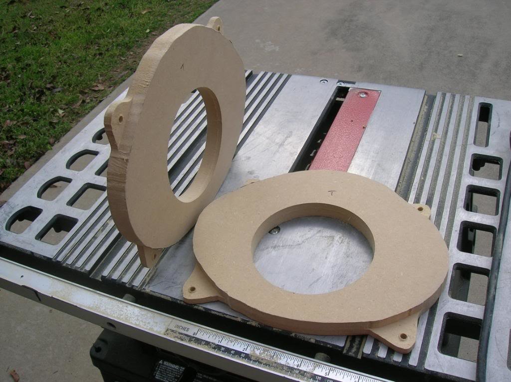

    Before I begin I would like to thank ItalynStylion for making the baffles.

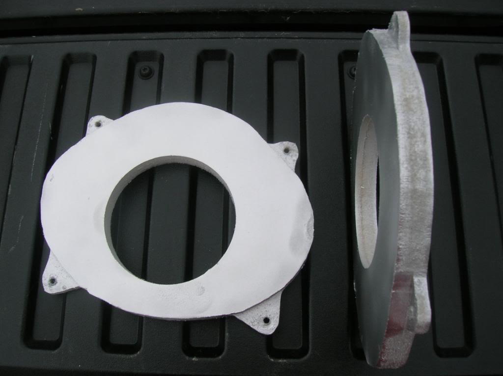

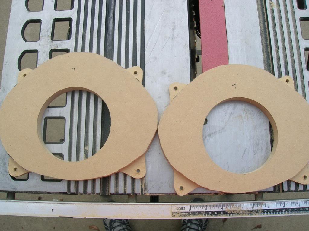

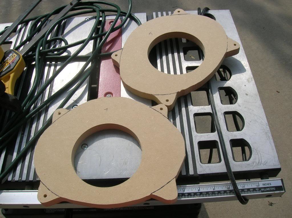

    1st thing is to get baffles made, you can make the templates using your factory speakers.

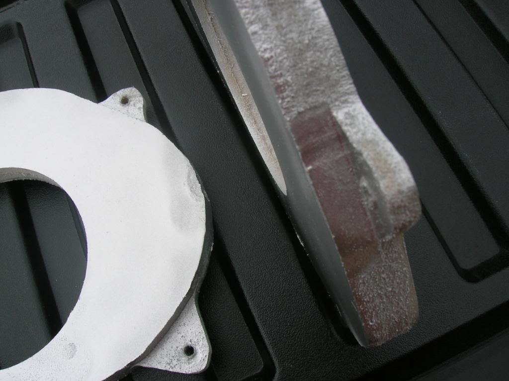

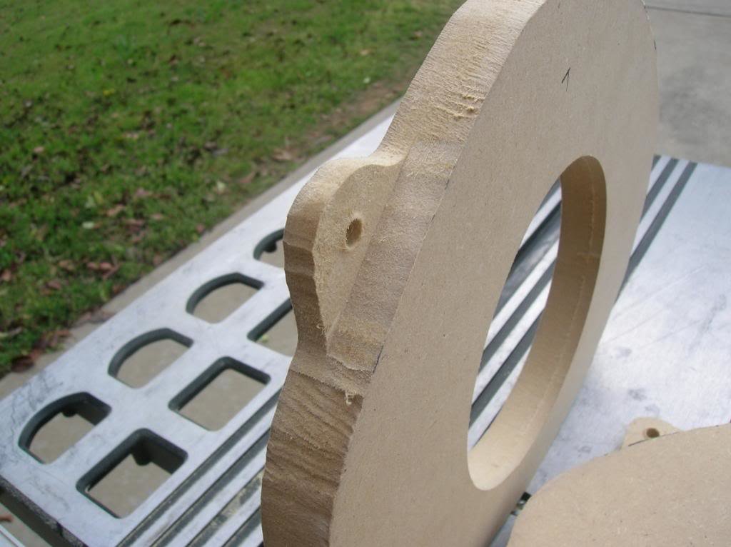

    I then marked off a bit of the tabs to route off so I could use the screws that came off of the factory speakers. Then I proceeded to route about 1/2 of the top layer of the baffle tab
    Then I used some spray paint to seal the baffles. I had some silver laying around so I used that, along with a primer and a clearcoat, I know probably overkill but what the hell, I wont have to do it again.

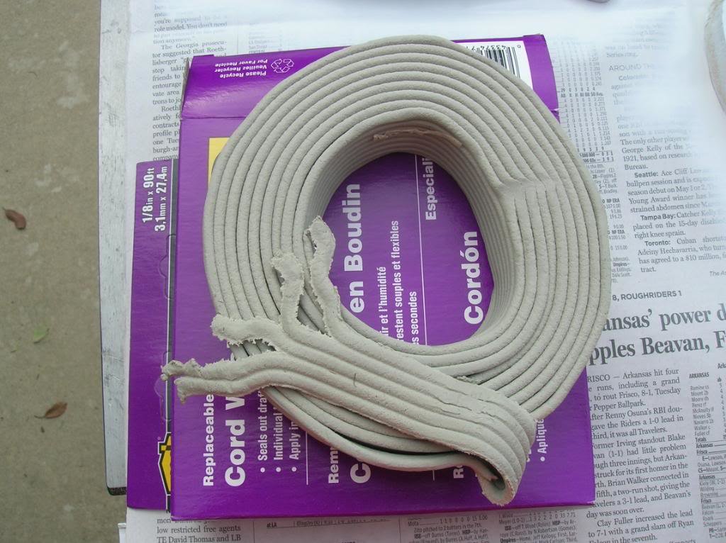

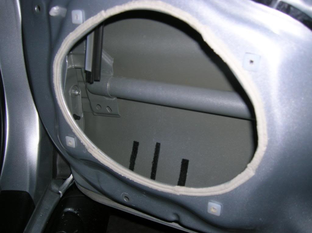

    Now I am ready to install the baffle. 1st you need a barrier between the baffle and the door frame and the baffle and the speaker. I picked up some cord weatherstrip to use
    Now I line my speaker and my truck door with the weatherstrip:

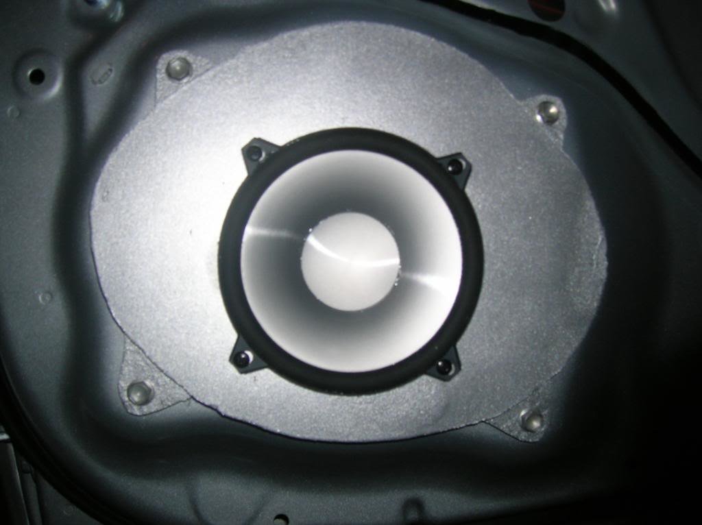

    Then I attach the speaker/baffle to the truck door using the factory screws:
    All done, total time about days, waiting for paint to dry, total installation time about 1 hour.

    What thickness mdf did you use?
