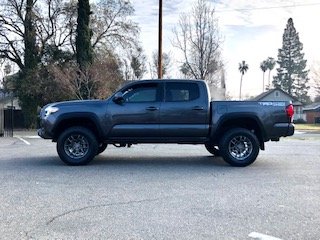

    I am also running 265/70/17s. I am not sure what my stock numbers were but the 23 inches even was with the 5100s at the 3rd setting 1.1 I think. 23.5 and 25 are after bumping up to the 4th setting and adding the AAL in rear

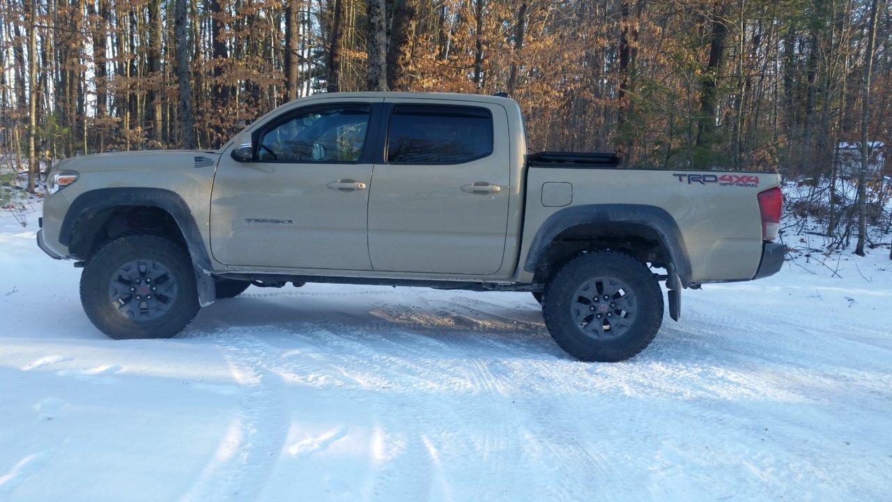

    Did the floor jack method today. Stock coils on the top notch. Didn't have a problem. I think the ride is the same as it was before, but it's hard to tell because the roads around here are shit.
