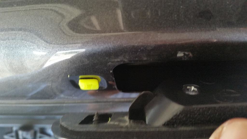

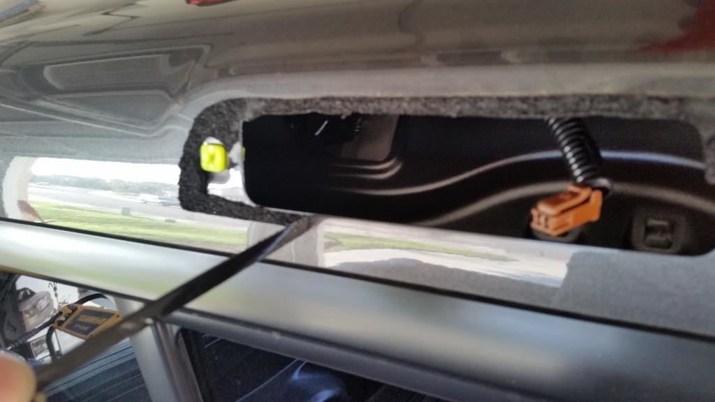

    First step - Using a T20 Torx bit screwdriver, remove the two screws set into the stock brake light:

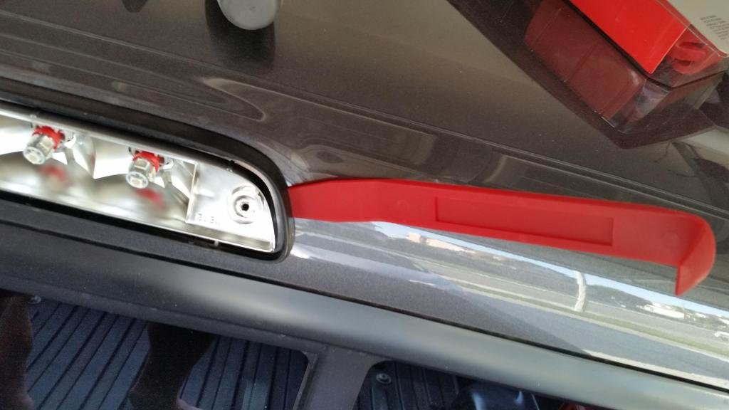

    Next, use a plastic pry bar and gently pry underneath the housing to separate it from the cab. It's stuck on pretty good, so you'll need to pry around the fixture from the sides.

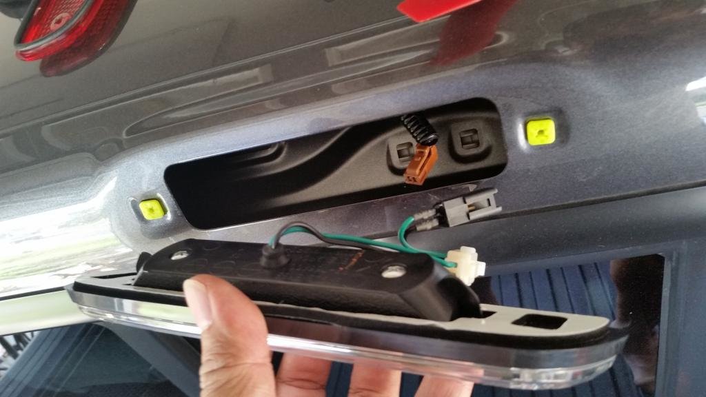

    The light fixture will detach. The stick-on gasket underneath will be destroyed - this means there is no turning back! On another note, I wonder how long these things really last without leaking??!?
    Now gently scrape/peel the remains of the gasket off the cab. Since I have a new truck, it wasn't that hard to peel the gasket away, but I can imagine a few years will make this task more difficult. Some "Goo Gone" might be needed at this stage if you can't just peel it away.

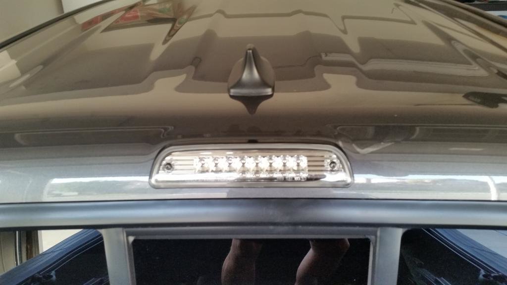

    Now plug in the wiring to the new light fixture and peel the backing away from the new stick on gasket. Be sure that there is no wax/dirt on the surface of the cab to prevent it sticking on tight!
    Now thread in your T20 Torx screws FIRST before sticking the light fixture on to the cab. Line up the screws with the plastic carrier holes in the cab. If you don't do this step, you'll stick your fixture on the cab and be unable to thread in your screws.

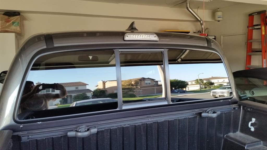

    Now tighten the two screws and firm up the stick on gasket. You're done!
    Looks good hah! :)
    The red LEDs light up brightly! I think this mod adds to the appearance of a silver/MGM truck. What do you think? :D

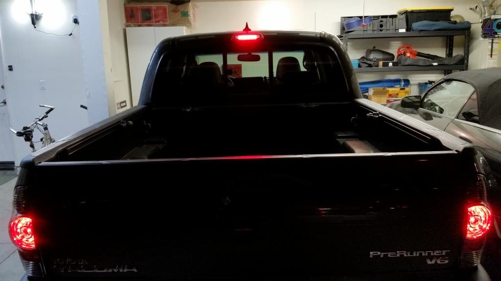

    Need pics of the light on!

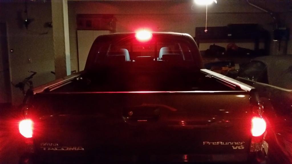

    Here you go!
    In the dark
    Lights up good! Is it $150 good? That's up to you to decide! :p

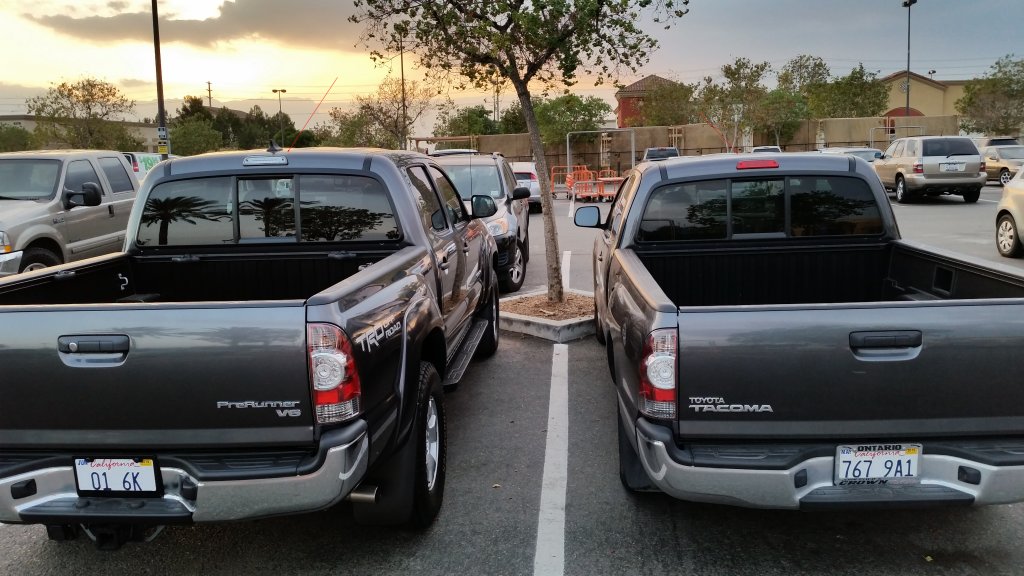

    Another MGM Taco parked next to me (mine is the one on the left) and gave me a chance to take a pic comparing/contrasting the third brake light.
    What do you think?
