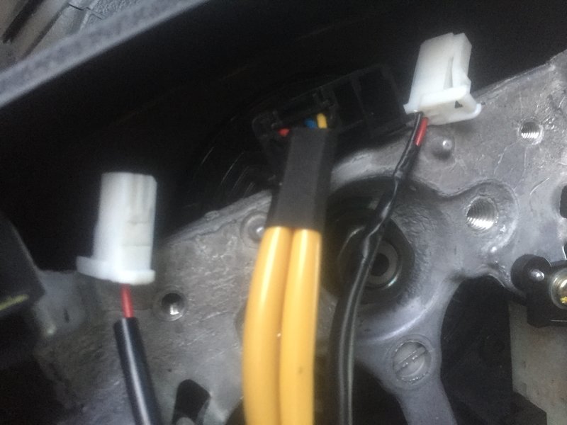

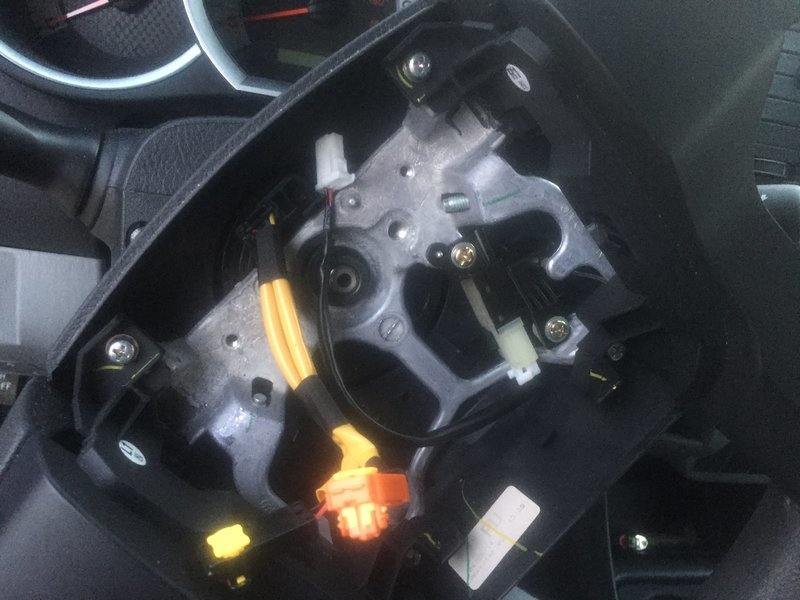

    First and foremost thank you to all who can help. I have read some other posts about this in this forum as well, and have watched the YouTube videos. This is my first truck (RIP my 2004 Taurus), and due to a limited budget, was bought used and is a very basic version.
    Anyhow, my goal is to install cruise control and I think I'm mostly there. Here's (photos) where my inexperience got me to a wall. In all videos I am seeing, it appears that there are two "ports" for wiring behind the airbag, that way you can connect both the cruise and the ground wires to the steering wheel.
    That doesn't seem to be my case, and perhaps this means my Tacoma wasn't "pre-wired", but I can't tell.
    Not sure if you can tell from the images, but it's almost like I have to choose between the ground wire or the cruise, and I have a feeling I can't just say "screw it" to the ground wire.
    Sorry if this has been asked before, but any help would be much appreciated. Happy 2017 to you all!

    I read something about pulling the ground wire out of its white "shell" and inserting it into the same shell from the cruise control plug (4 slots and only 2 are taken). Certainly would hate to break it trying, but would be curious to hear if anyone has done that.

    That's where it got frustrating: mine didn't come with the ground wire attached to the cruise like in the video, so now I'm trying to see if I can find the wire alone for sale, before I break something.

    Mine didnt have the ground wire either, it just came with the one wire, and i had to remove mine from the clip that was there, and place it in the new clip. It seems like there was a thread on here for it. I looked last night for the instructions, but it was late, and i will look again today after i get home. Hopefully we can get it figured out for ya.

    Thank you very much for the help; with English being my second language I probably wasn't using the correct keywords when looking for the instructions on this specific part of the process, so if you come across it, I'll certainly much appreciate it.
    In any case at this point I'm just glad to hear that I wasn't the only one having the problem. Every video I have been watching shows the person cutting the ground wire off the cruise harness and it makes me cringe/jealous, haha. Either that, or the ones that don't cut it, seem to have two slots to insert them.
    So at this point I can't think of another solution other than moving the wire into the cruise harness or finding a harness that already has both wires in it.

    I found this on a link in eBay, but am still a tad worried about ruining it. Until I find a guinea pig ground wire to test it with, I think I will have to wait.
    "FYI - You will need to move the horn wire to the new cruise harness.
    The plug you remove so that the cruise plug I provide will work has a single wire on it that needs to be transferred to the harness I send. This is your horn wire. Make sure you note the position of it on the old plug so you can correctly remove and reinstall it into the new plug.
    To remove the connector:
    1) Take a thin bladed knife and pry the rectangular retainer up from both plugs.
    2) Carefully keeping your fingertips out of the way of the sharp connector pin, pop it loose and install it in the other.
    3) Snap the rectangular retainer back in. If it won't go all the way down, the connector pin is not seated properly. If the white plug won't plug snugly into the clockspring assembly, the retainer may not be seated properly.
    (Easy to do. Hard to describe.)"
