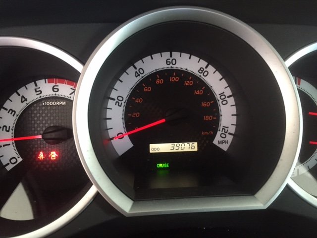

    Success! Updated the links on my original post if anyone else ever comes across this issue. If you are brave enough and know how to do the whole "depinning" thing (not sure if that is the right term, but I mean moving the horn wire into the same harness that came with the cruise module), then you might be able to save some $35 out of my $55-60 total. But, I am pretty satisfied with it either way!
