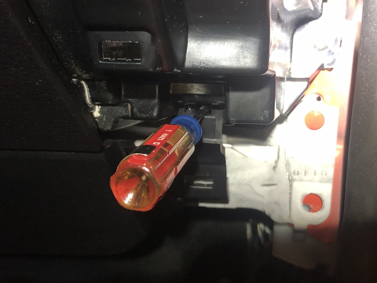

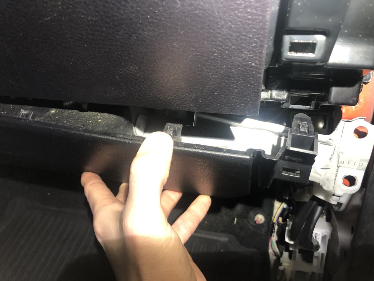

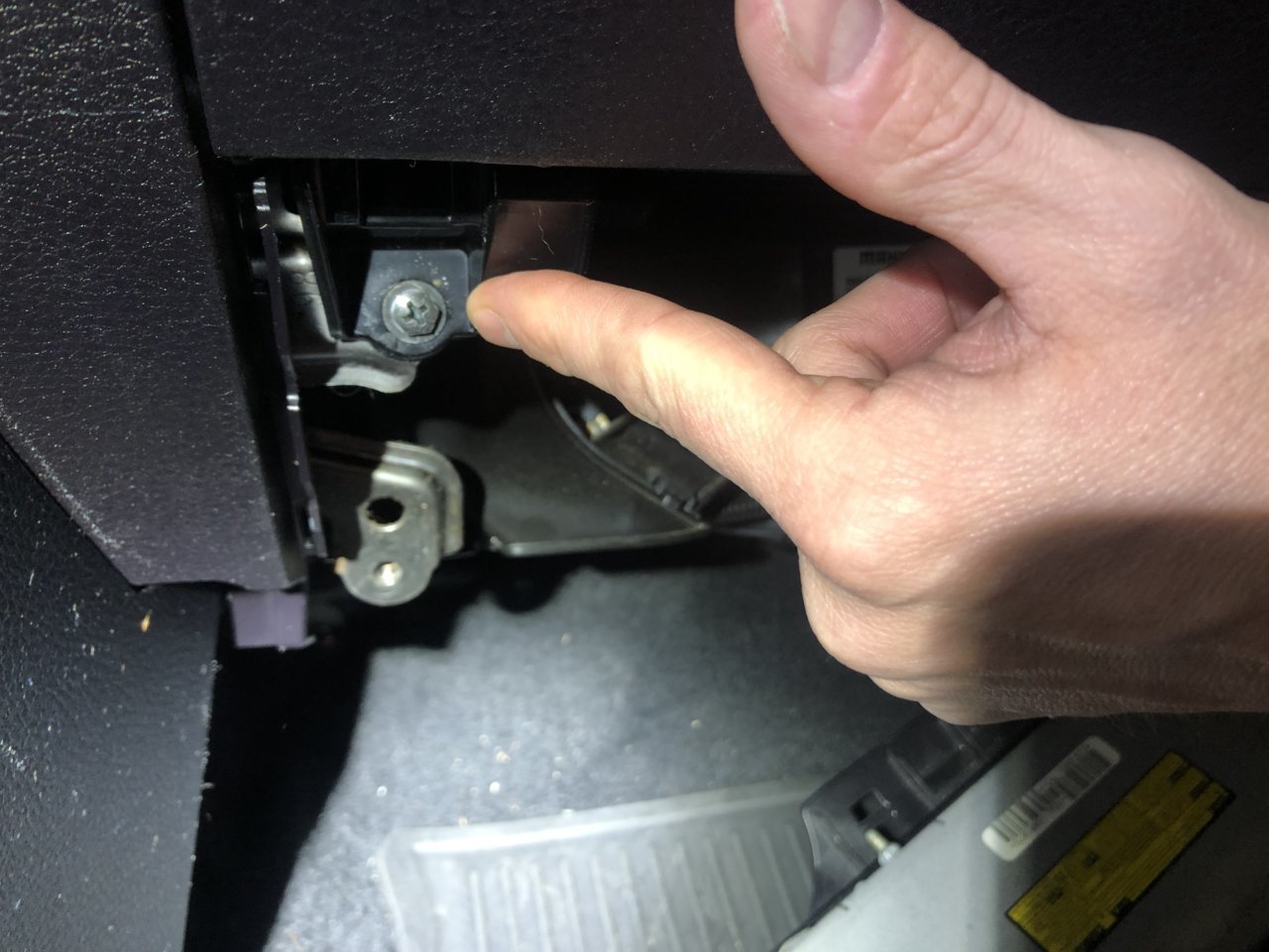

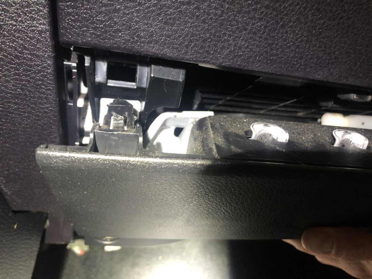

    Thanks for the help, I had to use both of these posts with a combination of a lot of thought to get that damn air bag panel off. This was what I was missing:
    Steps 4 here : https://www.tacomaworld.com/threads...e-3rd-gen-tacoma.614743/page-49#post-23621423
    And Pyrotech’s post 23 here has some pics, but he didn't go into detail about these panel tabs: https://www.tacomaworld.com/threads/the-some-day-build-and-trip-log.599494/page-2#post-21475950

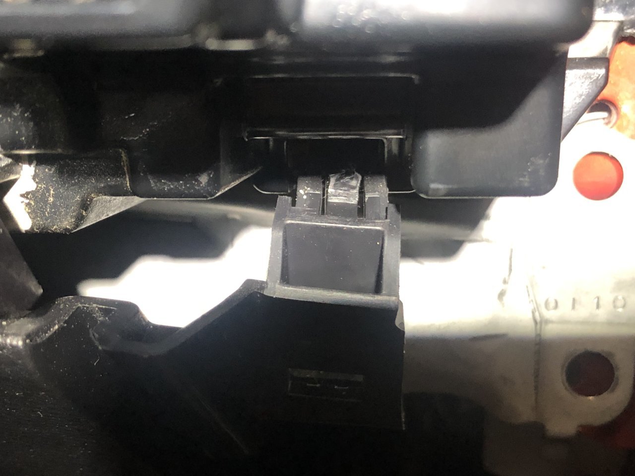

    The three hidden tabs are a bitch to release. I used a 1/8" wide flat screwdriver and really shoved it in where the tabs are to get them to release. My worst fear was breaking one and having to hear that plastic rattle forever.
    these pics are from my 2018 Tacoma SR5

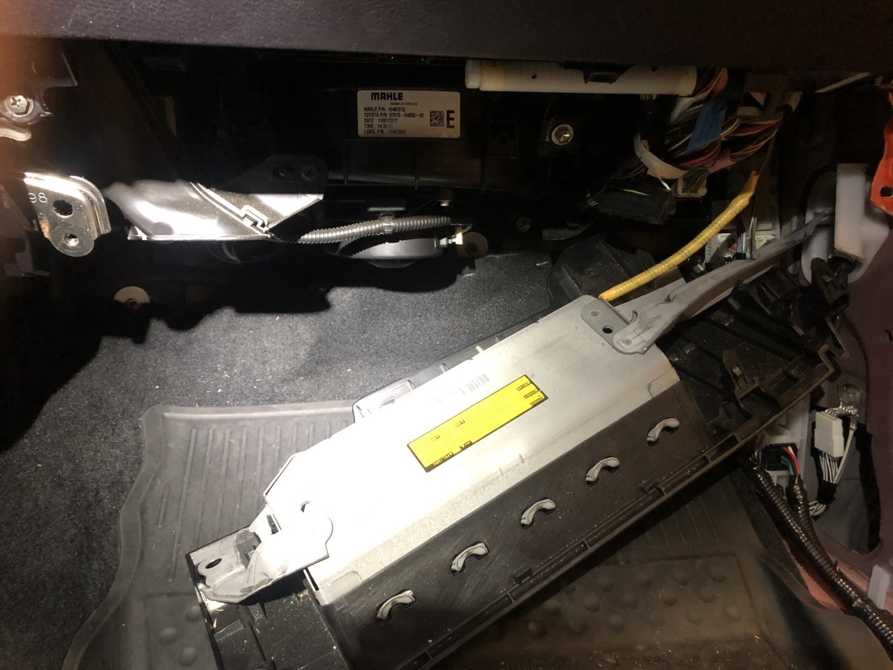

    And here is our little friend that we have to find to finally pull the glove box out:
    Air bag panel in floorboard. I didn't bother to disconnect it.

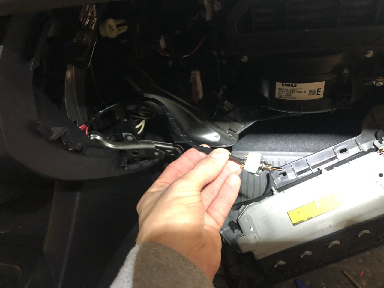

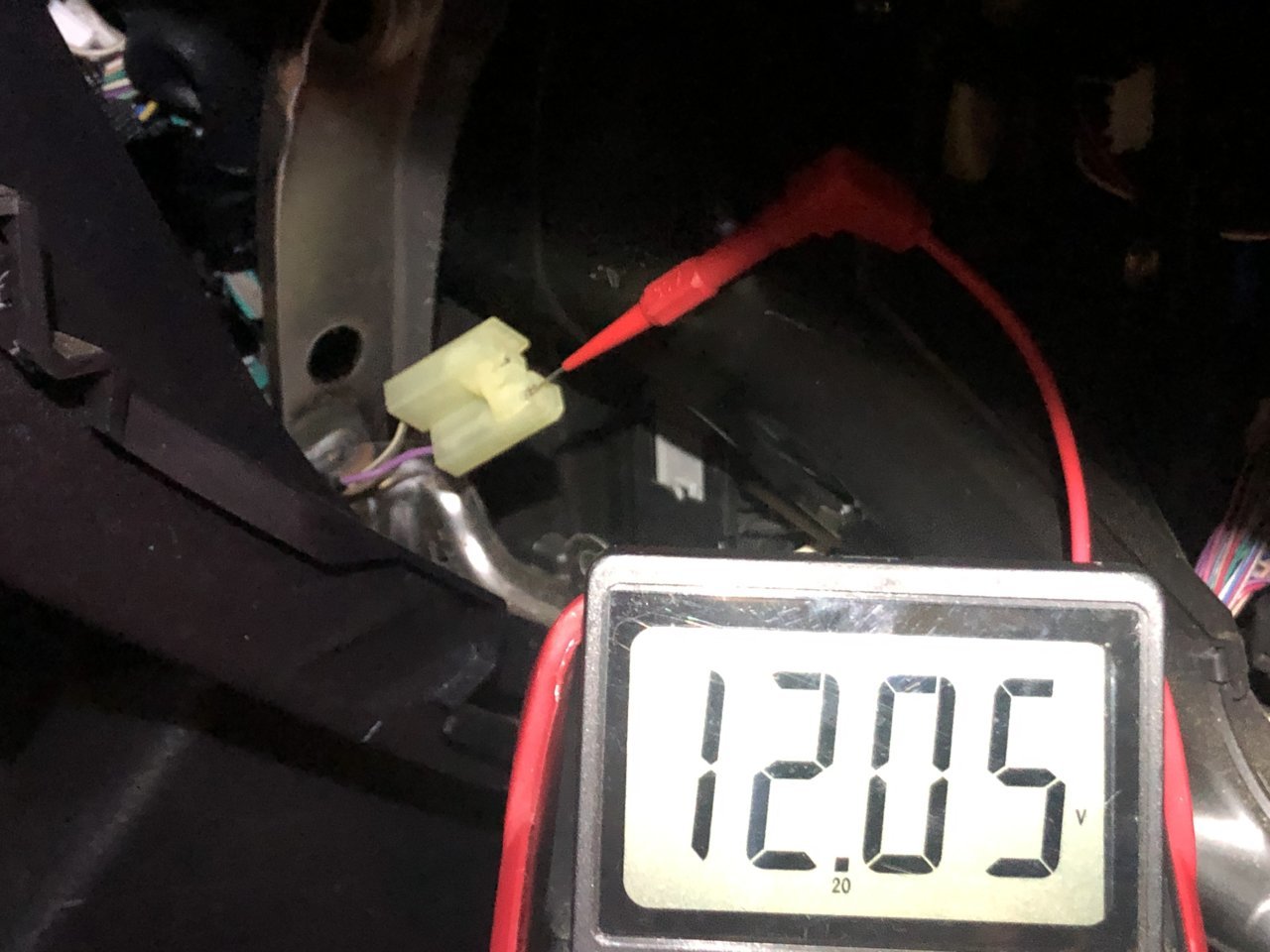

    Here is the right 12v socket connector. The hot is the purple wire.

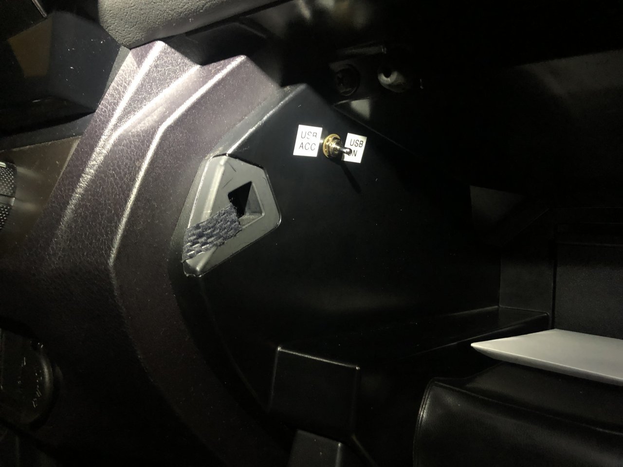

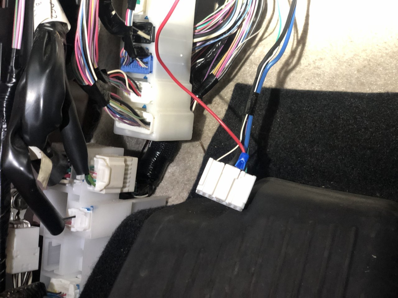

    Made up a 3 position switch, one leg tapped at the 12v socket (switched)
    and the other leg tapped at the brake controller connector, driver's side kick panel (always hot).

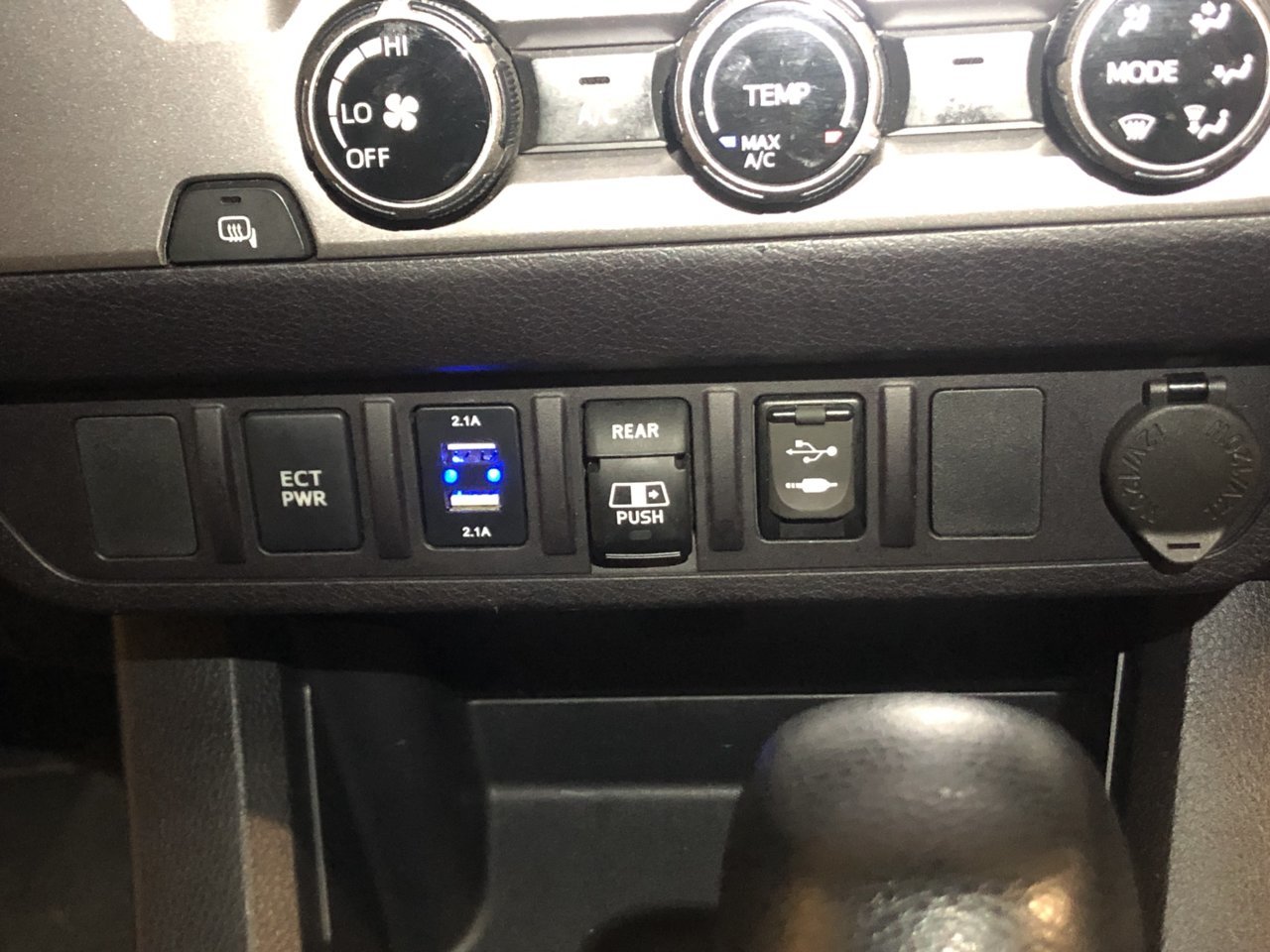

    Finished look. Hats off to Toyota for giving us blanks in these Gen3s:
    I mounted the switch inside the glove box at the top left:

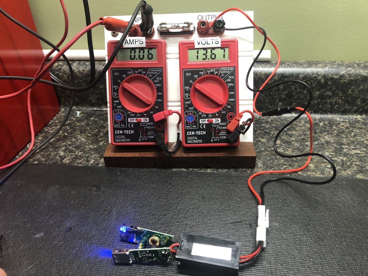

    Here is the 2-socket outlet on the bench showing current draw. You can see where you can clip the LED leads if you don't want them on. I like them because if I leave the switch to BATT ON, then I can recognize this when I remove the key from the ignition and the lights are still on (and yes those are the HF free meters, LOL):
