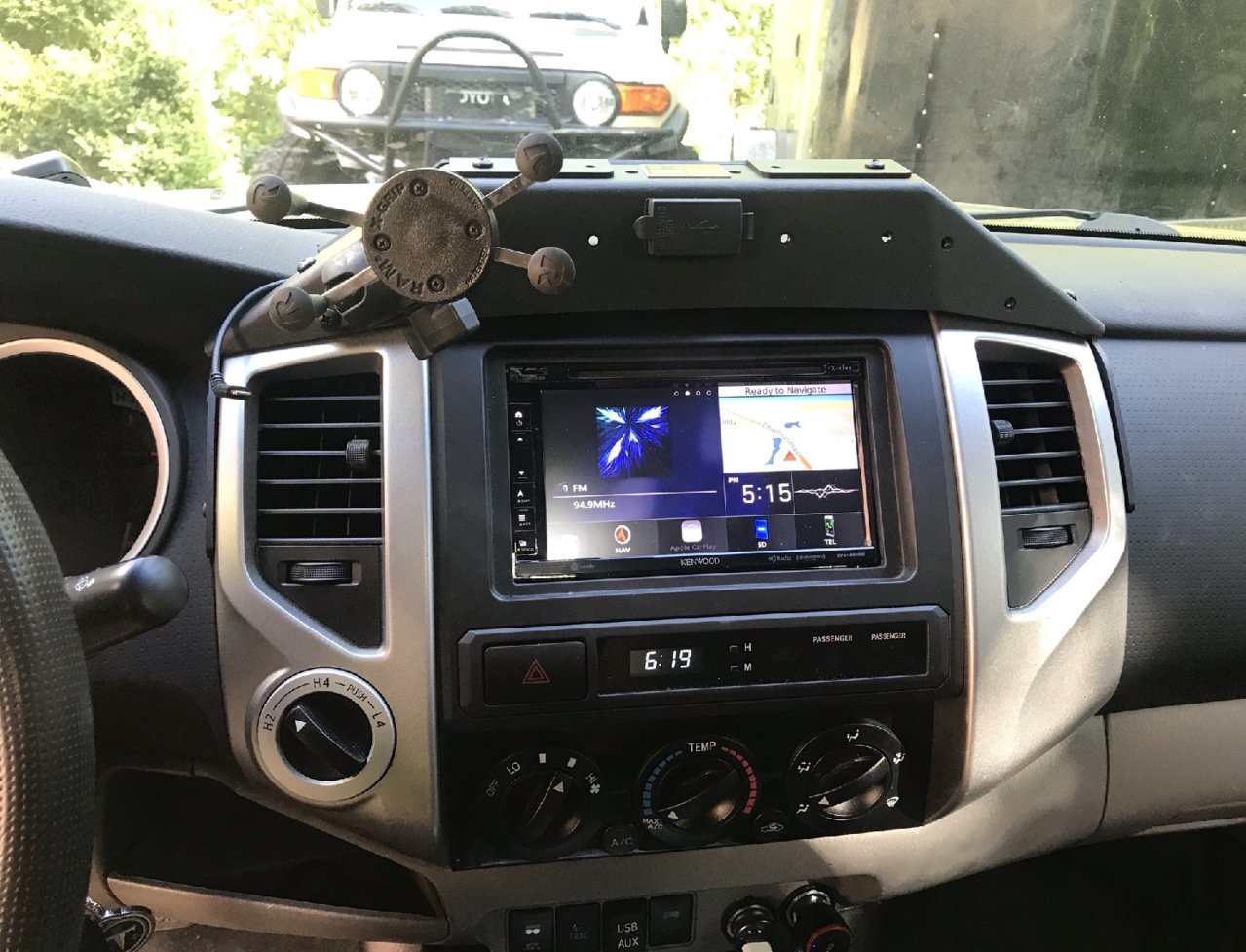

    Next Mod is to install the Expedition Essentials 2TPAM to hold my Garmin unit and cell phone when I am on the road:
    I put together the 2TPAM and set it over the radio. Positioning it evenly and carefully - Then I held it in place with some tape:
    See the holes on the sides?
    These holes will be marked using a black marker:
    Then over the radio there are four more holes. These holes are hard to reach, so I bent a small nail and used the nail to scribe the locations of the holes:
    Once I had all my holes marked up and ready to go, I removed the coin holder:
    AC Controls:
    There are four bolts that hold the radio down:
    Remove bolts and pull radio out:
    Carefully remove all plugs:
    See these buttons that are over the instrument panel on the dash? - Poke the middle of them to remove:
    This will allow the fascia of the instrument panel to be pulled away:
    Have a friend remove the Gray Radio Trim Bezel:
    Unplug the 4x4 switch
    Time for surgery:
    Drill some pilot holes and go to town:
    Tweezers aid in setting washers and nuts:
    Other side:
    Next drill the holes for the radio, always use pilot holes to prevent the drill bit from wandering. Any mistakes here will be visual:
    Time to set the piece that goes over the radio:
    Next, per instructions from Expedition Essentials, I trimmed this lip off on the driver's side of the Gray Radio Bezel:
    Dremel time!
    Now go run in the truck and trim this lip off the instrument panel fascia:
    Like this:
    Next notch the radio to allow wiring to travel to the USB charger on the 2TPAM:
    Wiring for the USB Charger on the 2TPAM was spliced onto the power points below the radio, I reached back there and removed the plug:
    Splice Colors for reference:
    At this point I ran the gray wire for the USB Charger on the 2TPAM BETWEEN the gray bezel and the dash, see at the top of the picture. The gray wire has the 2 red connectors at the end:
    Put it all togther now:
    So clean!
    Start up the truck to ensure proper operation:
    Install wire cover:
    Final install picture:
    Accessories to come soon!
