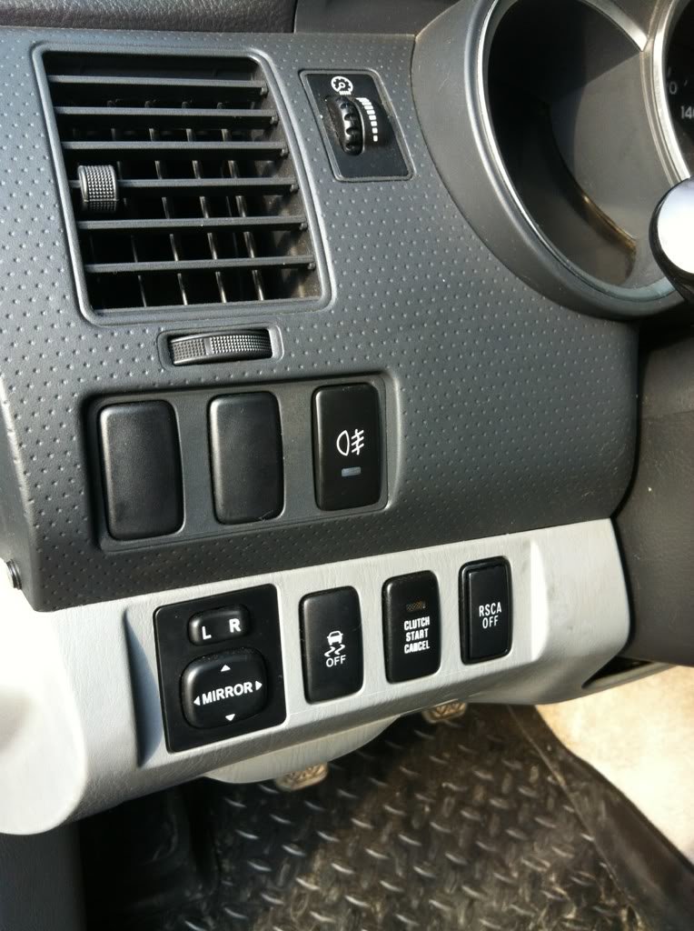

    Bought my whole kit off Amazon for 90 bucks here's the switch only problem is it lights up green.

    Your switch is upside down :anonymous:
    Also, if that is an OEM style switch, you can swap out the bulb very easily so it matches the other switches. It only takes a small flat-head screw driver to do so.
    In this picture, the brown round thing you see on the side of the switch is the small incadescent light. It twists out with a small screw driver and you can replace it with whatever color you wish.

    Hmmm, shiiiiiiiiiiiiiiiiiiiiiiiiiiit oh we'll I can't see it anyway. Just flip your monitor upside down that's what it looks like. And I could care less what color it is just letting the guy know it wasn't the factory orange.

    I flipped my monitors upside down and your fog light switch was right-side up! But... your your clutch start-cancel, RSCA, VSC and mirror adjustment buttons are not upside down. Also, did you know that you have floor mats on your roof? :laugh:
