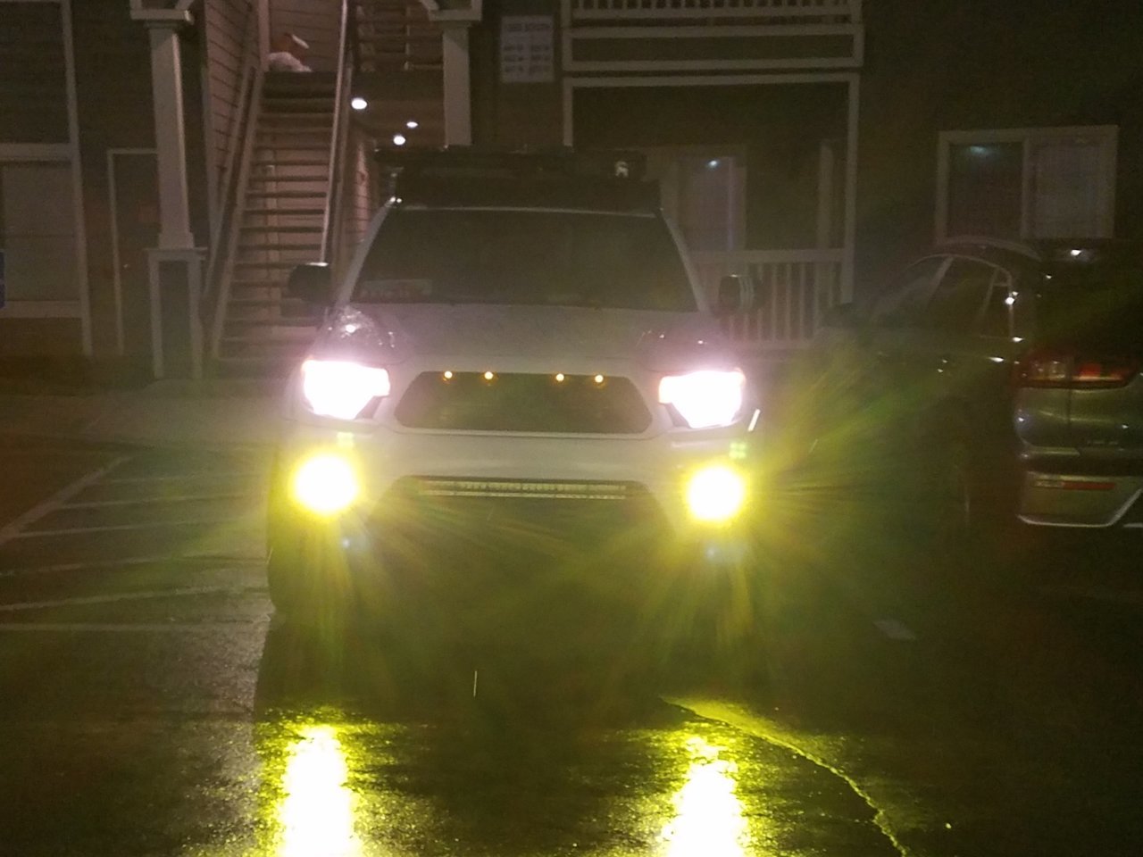

    Should be able to remove the plugs for the holes and insert fog lights, either OEM, or @Baja Designs makes some really good drop ins.
    The real question is whether or not the truck is pre-wired for them. Check behind the blank in the top left position of the area by the door, and you may find a pigtail. If so, add the switch, add the lamps, and boom, fog lights. If not, add a switch, run a bit of wire, and boom fog lights.
    Baja Designs for reference (WAY brighter):
    boogie3478 likes this.
