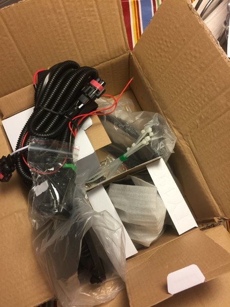

    Hi. I was wondering if someone can help me. I have a toyota tacoma 2013. I purchased a pair of aftermarket foglights. Its a complete kit with the lights and everything (relay etc). If someone could walk me through on how to wire it or just give me an idea. (My tacoma is not pre-wired). Please. Thanks im advance.

    Pretty easy. Pop the relay into the mini fuse box under the hood located next to the bigger fuse box. It's labeled fog under the cover.
    Pop the upper left "dummy" switch to the left of your steering wheel out of the dash with a mini flat blade screwdriver. There's a wire loom ready to plug into the back of a new switch you should have in the kit.
    You should have little
    Whips down at your bumper behind your fog light locations. Then you have to get end adaptors to adapt to your fog light ends. You may not need them depending on the fog lights. If you do, you will have to adapt your Toyota ends to accept the ends to the new fog lights. Or you can splice them with crimps. (I wouldn't recommend. I would recommend splicing with connectors to keep the lights factory splices. Then that should be it.
