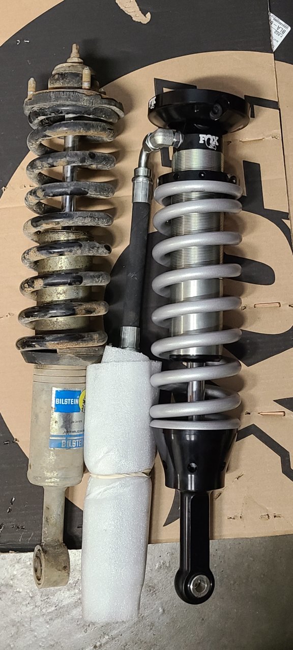

    I bought these Foxs recently and am trying to order replacement parts for the bearings but am unsure which coilover it is exactly. Can anyone help me identify the exact model? It was on a 4wd 6 lug so I am guessing these but it doesn't have the double adjuster collar. Any help appreciated![​IMG]
