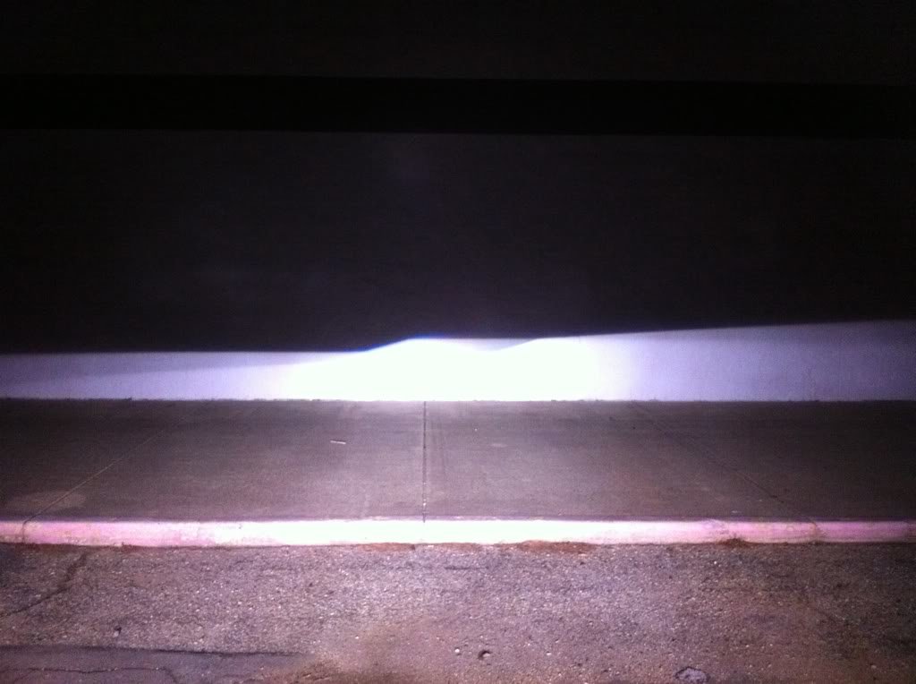

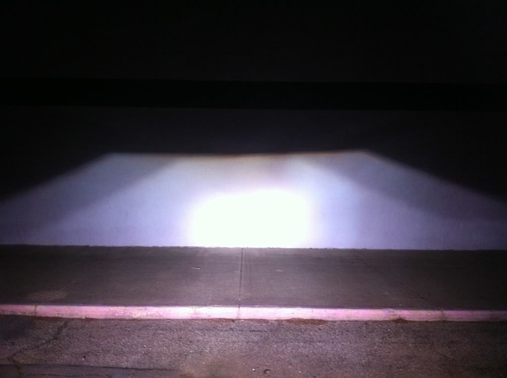

    No. The projectors aren't up to par. Light still scatters in them causing you to blind others
    There are others that have better adjusted pics and prolly better setups, but here's my retrofit (my passenger side is still a hair off horizontally)
    Low
    High
