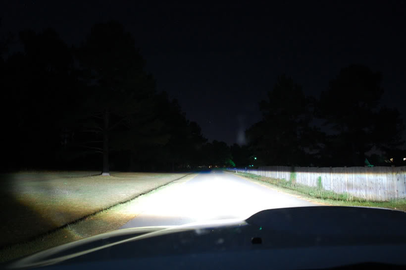

    here is your pic about 25ft to 30ft away! now send me a pic of your awesome retros!

    driveway has a incline and wet. my ccfl halo rings do give a little scatter but its much brighter than stock!!

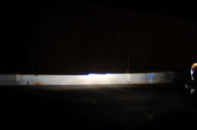

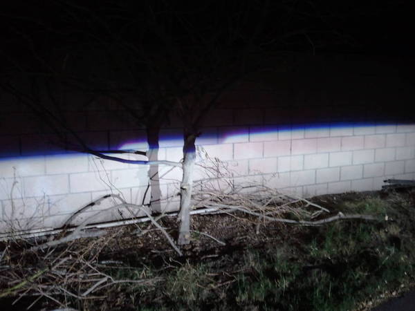

    And a real retro...

    Is the second pic high or low beam?

    The second beam would be a shot of the low beam... I cannot take credit for these photos though. They were pulled from Electronman's thread. Mine look just like it though. I just don't have my good camera here to take the shots

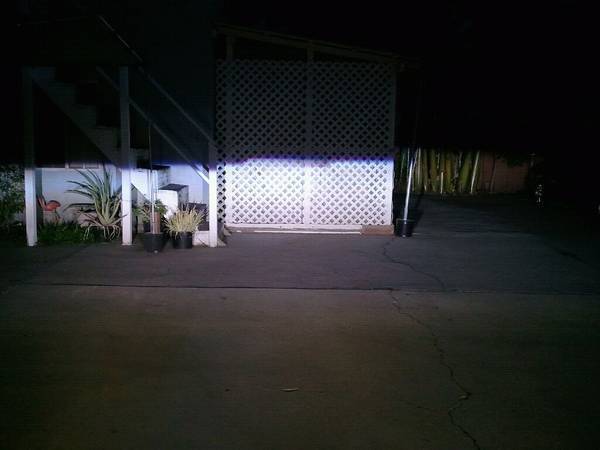

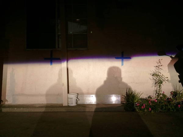

    heres my PROPER RETRO
    NO SCATTER HERE!!! :woot:

    Even if the driveway is wet and reflecting light, which I am not convinced is the case, the glare above the cutoff is way too uniform to be from and reflection off the ground.
    And the foreground is terrible compared to what you get from an HID projector.
    However, those do look better than a factory headlight with an HID which is all glare and no cutoff
