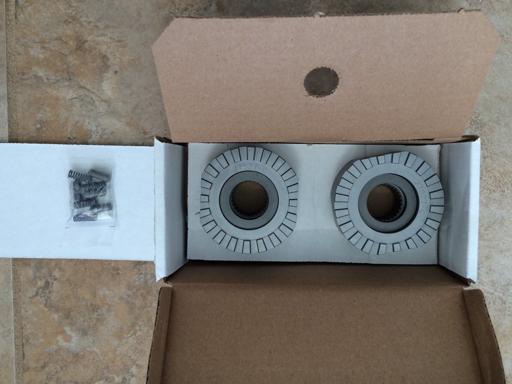

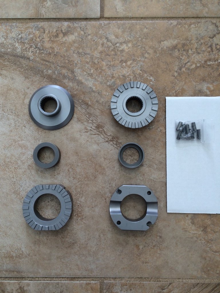

    I finally got it in the diff yesterday and the diff in last night. Initial thoughts are what was to be expected. It's locked and behaves that way. It'll ratchet when coasting and turning and will bind up when turning and cruising or accelerating.
    I took a few pics and will throw together some sort of DIY or something if anyone cares. As usual, hit some snags and overcame them with money and determination. I've been up since 5am yesterday and it's 6pm now. But I got a lot done. Lunchbox in, resealed oil pan, jacked up 5100s, rotated tires, greased up, installed a winch and some home brew welding lead wiring.
