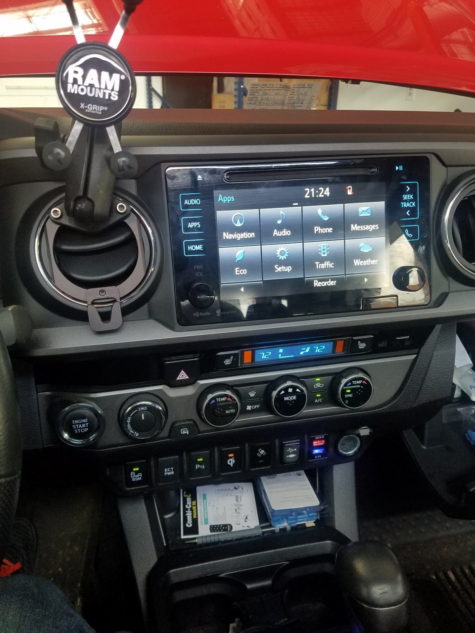

    So I just installed this today and I found it pretty easy to cut the OEM switch panel while it was in place. That made it so I didn't need to remove the whole center console. I just reached around the back after removing the ignition panel and unclipped the switches. Once I moved them out of the way, it was easy to cut the panel and install the new hotness.

    @destin_meeks Any idea if the center console can be removed as described without removing all the other dash pieces prior? I forgot to plug in my wireless charging pad during reassembly... FML
    On an aside can anyone confirm if the white lettering on the rear window switch is supposed to illuminate with the headlights on? After reassembly the switch functions and the indicator led is lit but the words don't light up like other switches. I don't use this switch much so am not sure if this is normal behavior. It does mirror what I'm seeing on the AC power button in the left pod so maybe it's working normally?

    Unfortunately, the whole dash probably has to come apart to get to that connector :sorry:
    EDIT* I might try just pulling up the console section (cup holders back to the center console) and see if you can reach up under the wireless charging pad? Haven't tried that so no clue
    As for the rear window switch, it does not light up. Only the little indicator lights up. The lettering on the inverter switch doesn't light up either, but the lettering on the cargo lamp switch does

    Mercifully, you can get at the charging pad wiring harness easily buy only removing the shift knob and shift trim panel.

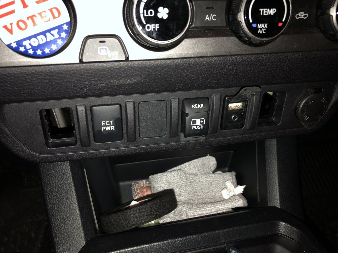

    With the Ac controls out, can you access the back of the switches on the lower panel? I have 3 empty slots that just have a filler in there, wondering if I can just pop them out from the back right there

    Yes, I believe you can reach down there pretty easy. You can also get a thin panel tool (like a skin wedge) or even just a butter knife and pop the blanks out from the front. They’re not in there very tight

    You were 100 percent right. Just slid a panel tool in there and they popped right out. This will make the heated seat install 100 times easier. Thank you! You’re one of the most helpful members on here

    I guess it’s a bit of a moot point though. You’ll have to pull the A/C controls out to get your wiring in there
