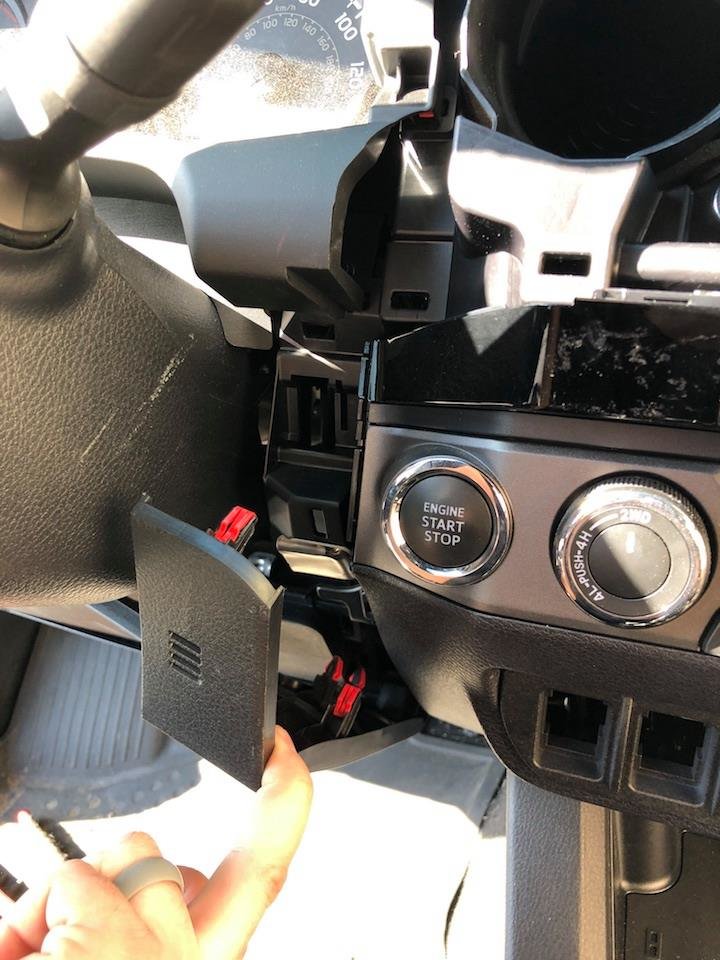

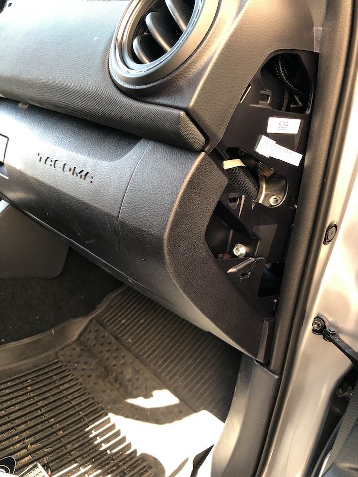

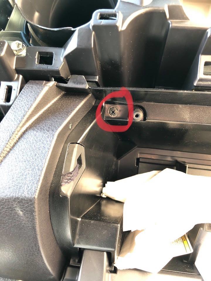

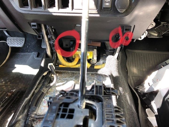

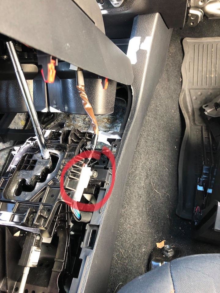

    From there, you can remove the plastic cover along the driver side, and wire tie everything up and out of the way, and then cover it all when you replace the cover.

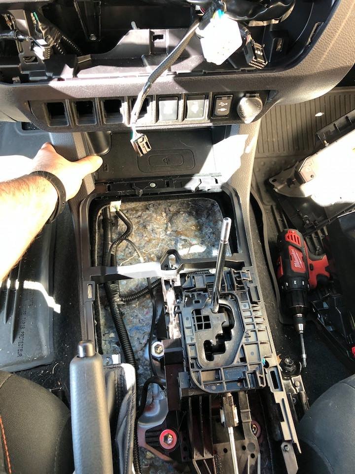

    Thanks for the write up and I do have a question. First off, I am not replacing the entire switch panel, but I just want to pop out the iQ charger button and replace with the Front/Rear Camera Mod switch button. I don't like the iQ thing anyway, so losing that button for something more works for me. My question is, if I just remove the center console components, will that provide enough access to pop out that button, cover the the old wires, jam them back into the electrical abyss, and pop in my replacement button with it's wiring?

    Yes, if you pop off the radio surround and the AC control panel, you can access the switches very easy.

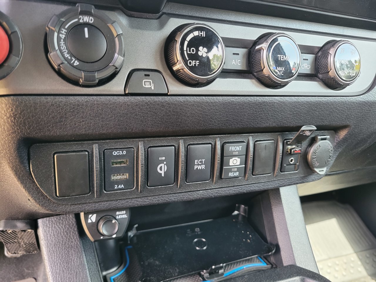

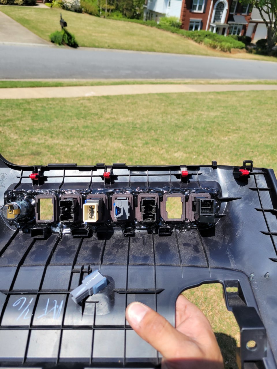

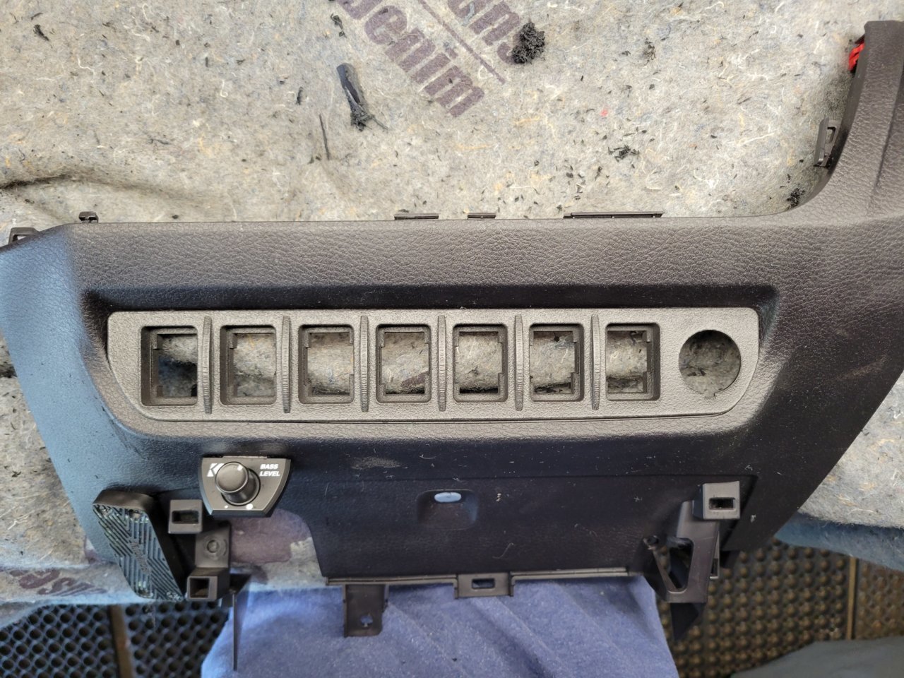

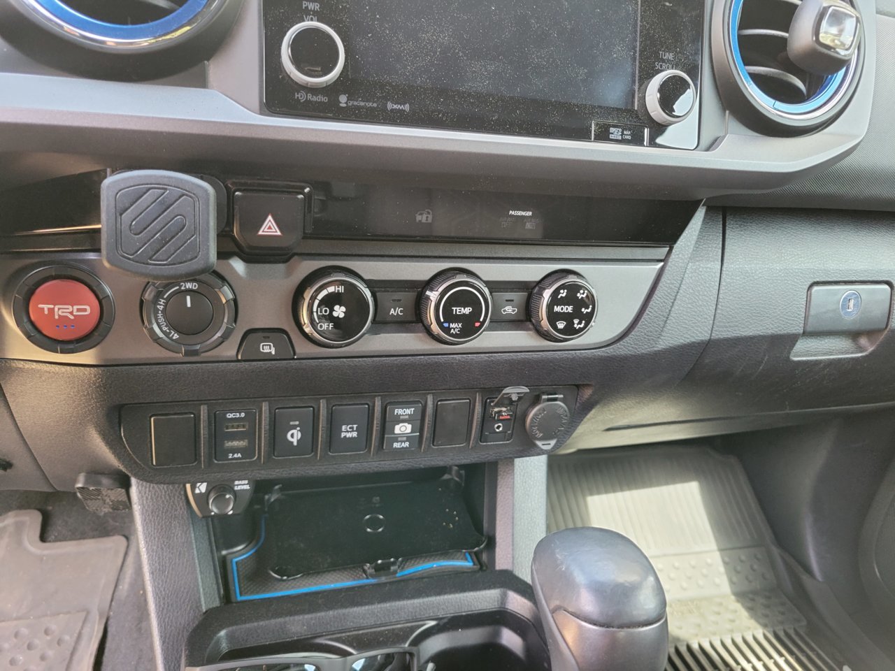

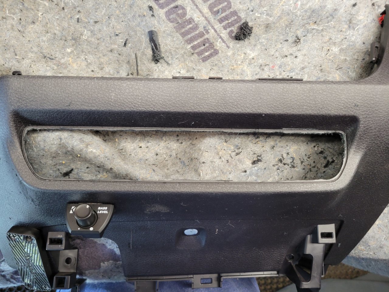

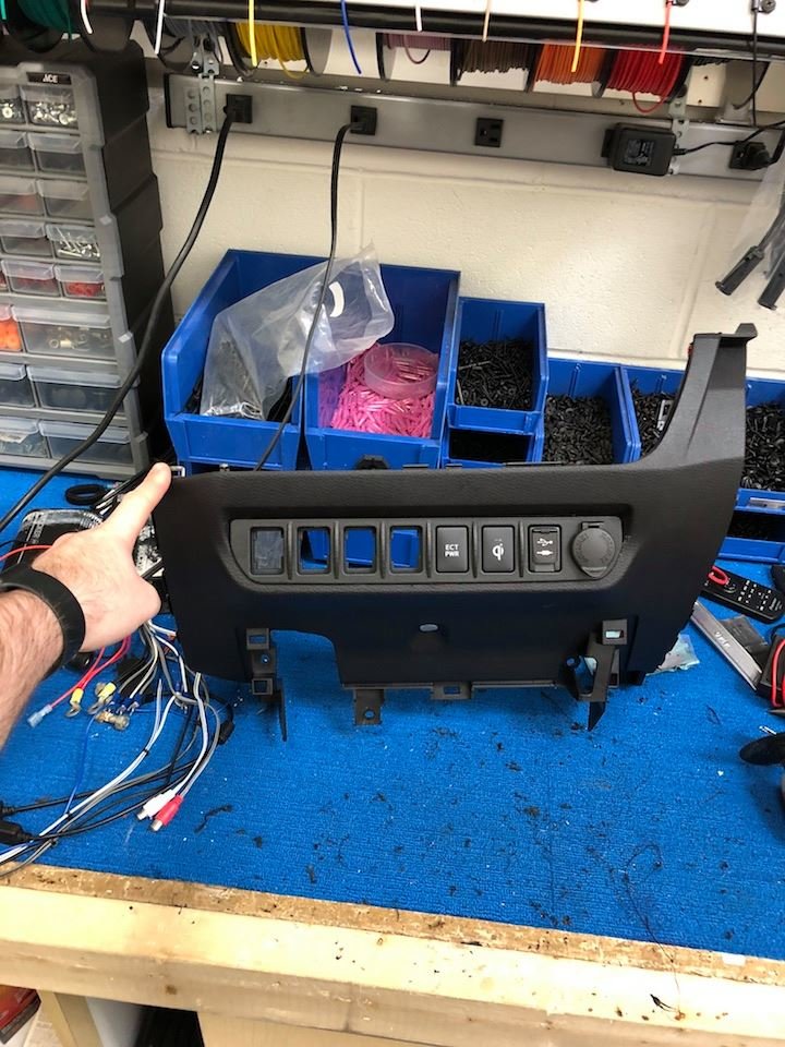

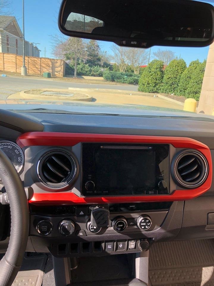

    So i did the lower panel switch install and it turned out great! I added a usb charger and love it. I do have a few pointers
    Grossomotto likes this.
  9. Apr 15, 2021 at 1:28 AM
    #69
    Dellafor
    Dellafor 2017 Tacoma 4x4 (Big Blue)
    Dec 1, 2020
    #348343
    128
    Atlanta
    Suspension:Procomp 4" coilover lift kit w/cv drop & diff drop. Dirt king UCA, Sway bar relocate, urethane bushings and sumo bump stops AAL w/ 1" rear block and shim. Fuel 18 x9" wheels with 275/70/R18 K02s. BAMF CMC (deep). Exterior: High linel bumper gaurd with LED bar and Smitty winch. CNC Blue line Grille. Custom 6" LED over 3rd brake light for trailer/ bed. Any time backup and Front facing camera. Rear hitch guard/step, rear tow hooks (f150). Red tail light overlays and side mirror signal tint and corner marker blackout. Fully debadged and removed decals, tailgated raised letters. Toyota tonneau cover. Nerf 3" side rail sliders. Interior: Meso Dash Blackout kit, w/AC knobs and Start button. Blue floor led lights , Meso lower dash switch panel with HDMI input and usb quick charge. Dash track mount w/ram mounts. Blue vinyl overlays. Kicker tweeters and kicker amp w/ JL w3 8" sub on OEM entunes head unit (anytime gps mod & av input.. Full door, roof and cab dyna mat. Weather floor mats, center console cover, LED int light kit. Full Alpine Dash cam.setup(3). Performance: OV Tune, K&N filter with TRD piping & accelerator. TRD exhaust Tip. Oil catch can and AC drain mod.

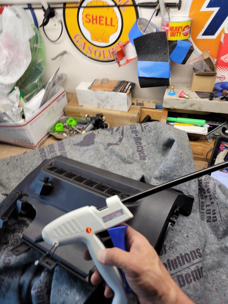

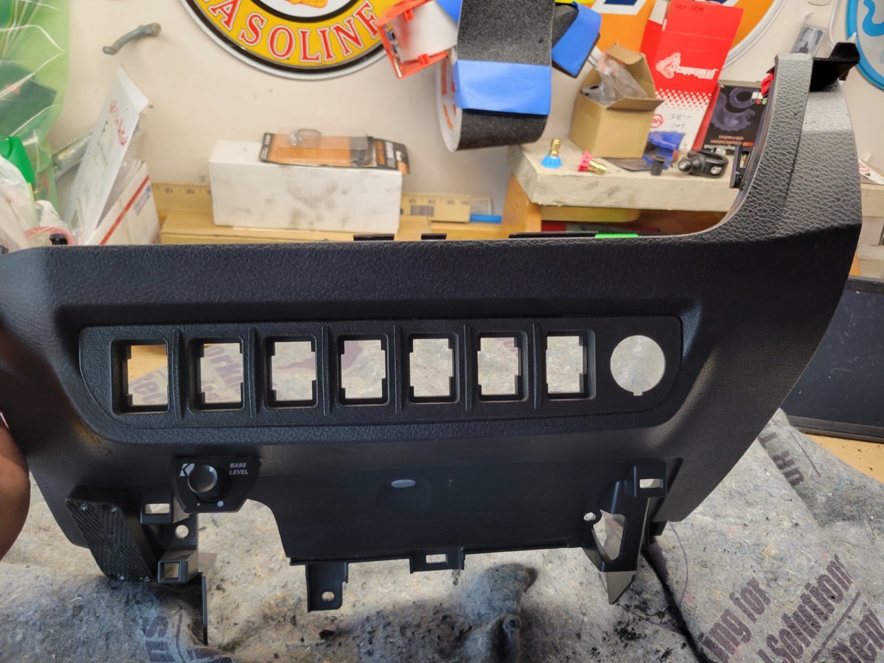

    Used black hot glue (easy to use and clean up/remove if needed & hides gaps)
  10. Apr 15, 2021 at 1:35 AM
    #70
    Dellafor
    Dec 1, 2020
    #348343
    128
    Atlanta

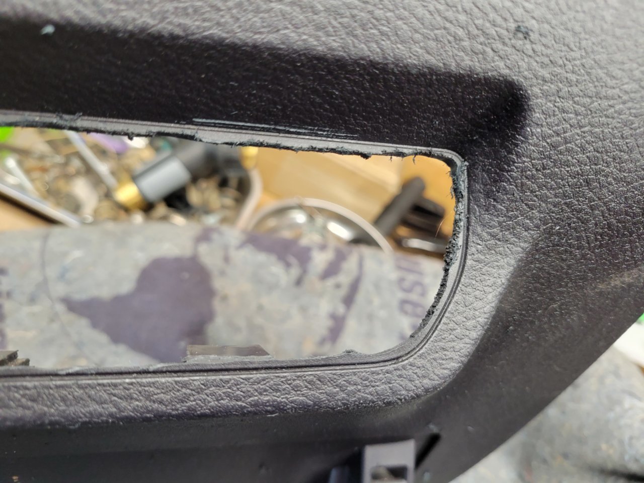

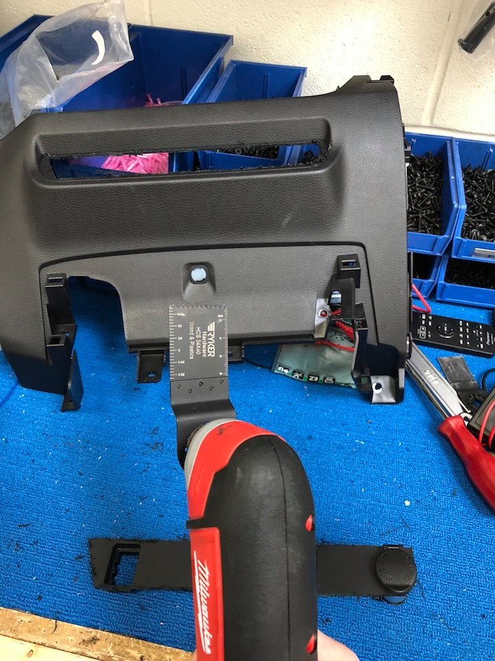

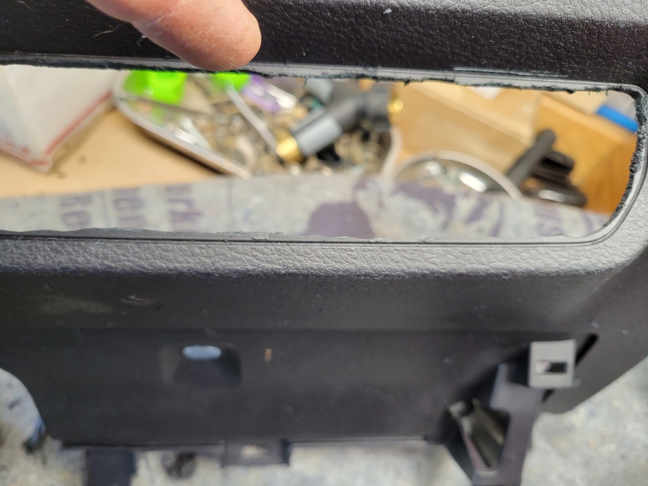

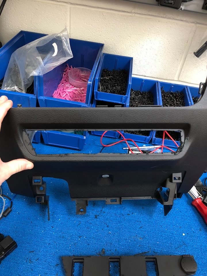

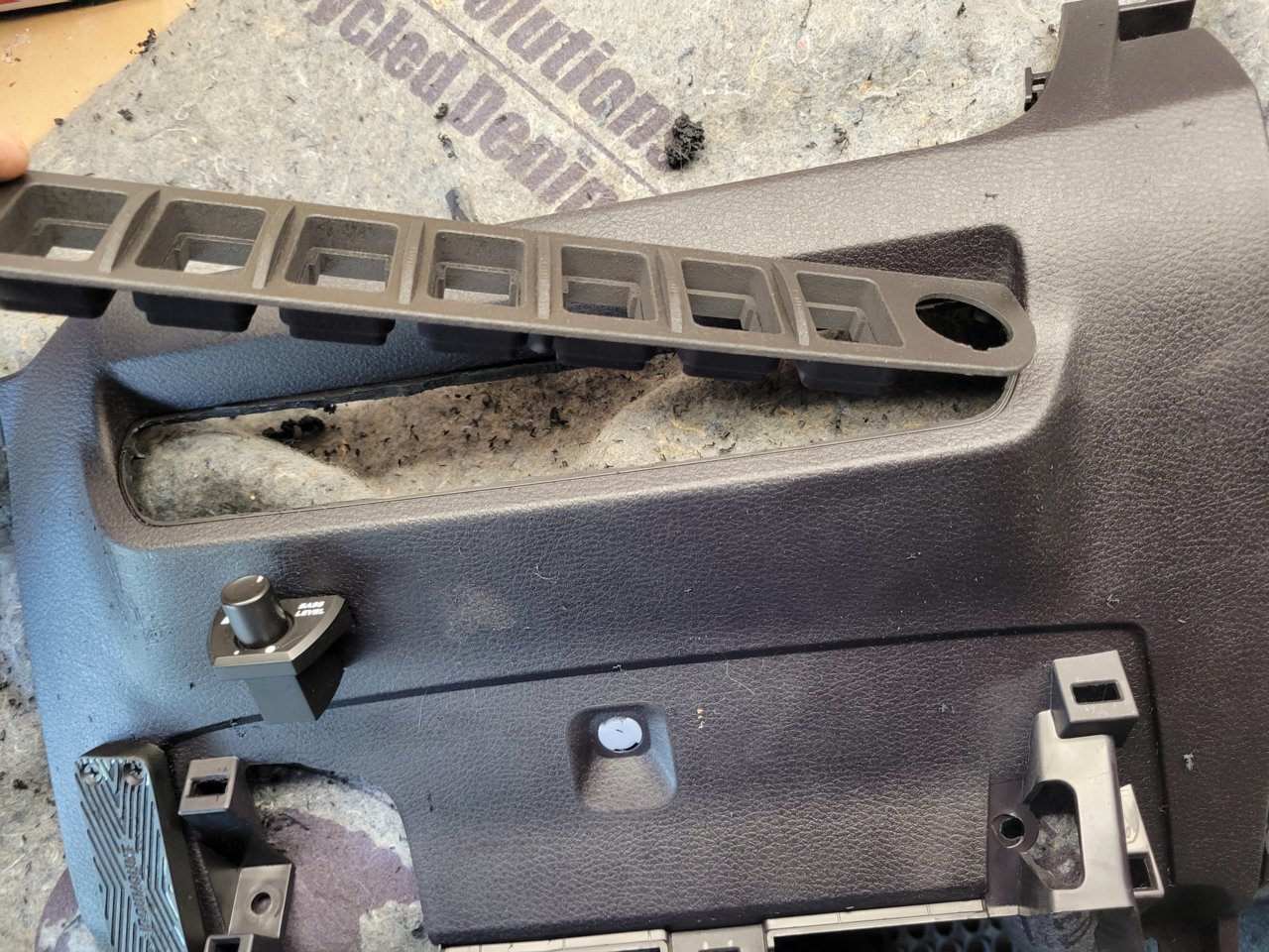

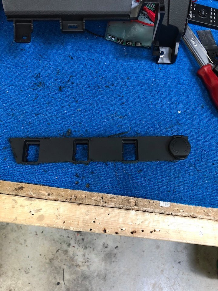

    When cutting i recommended not starting in the outline groove spot. What I did was start about 1/4"-1/2" or so from the edge with a dremmel router bit and cut off wheel. Then I went back with a roller sander attachment to clean up and get close to the grooved area.
    NOTE: you dont need to remove all of the old switch plate plastic to fit in the new one. Once you get to the sanding part, keep checking for good fitment to minimize gap

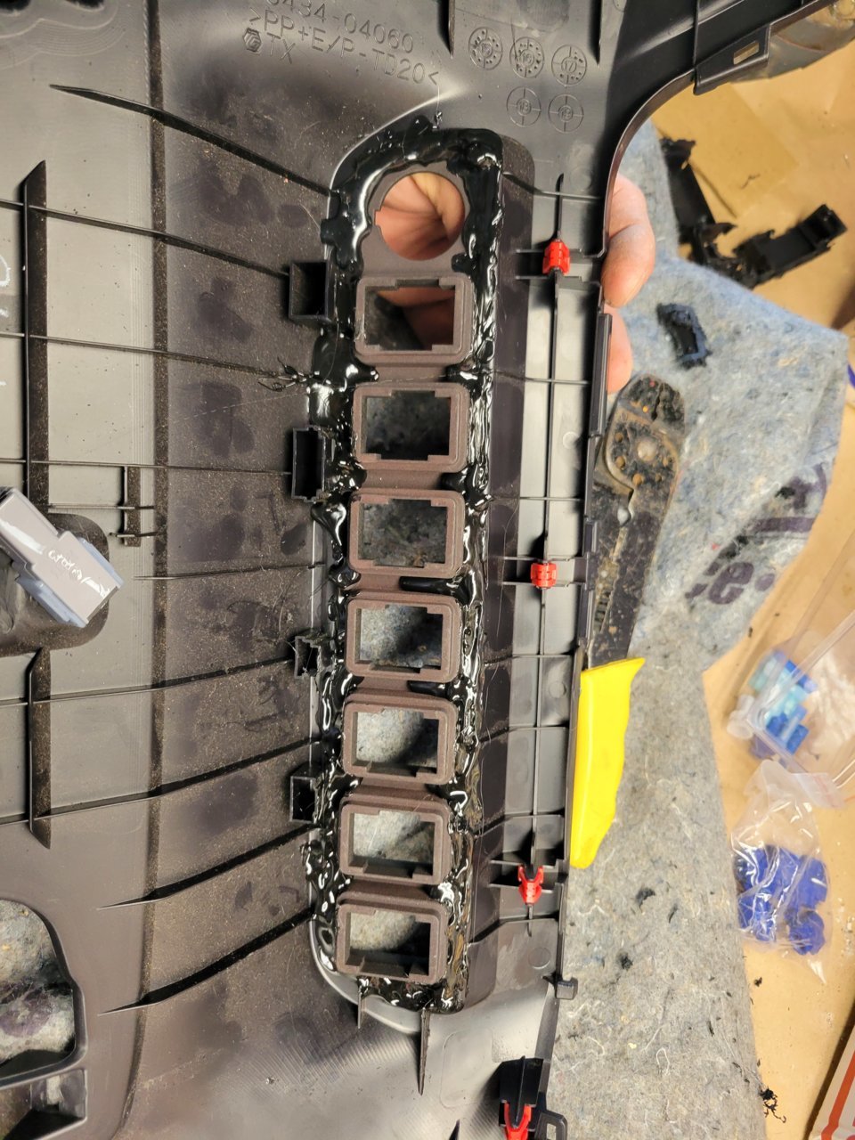

  11. Apr 15, 2021 at 1:38 AM
    #71
    Dellafor
    Dec 1, 2020
    #348343
    128
    Atlanta

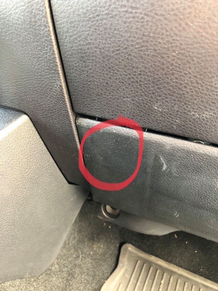

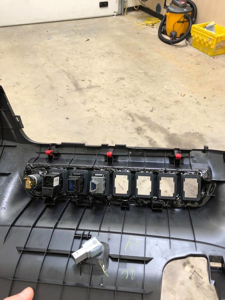

    Those pictures show how much i ended up removing. Note that the groove is still visible (the.new.panel will fit fine) Doing this will virtually cover any gap along with the black hot glue or epoxy
    Lay new panel from right to left as shown (only if you left groove) this ensures an even fit

    Remember start slow and remove a little bit at a time. The sander is your friend but if you slip your dash aint gonna look Purdy

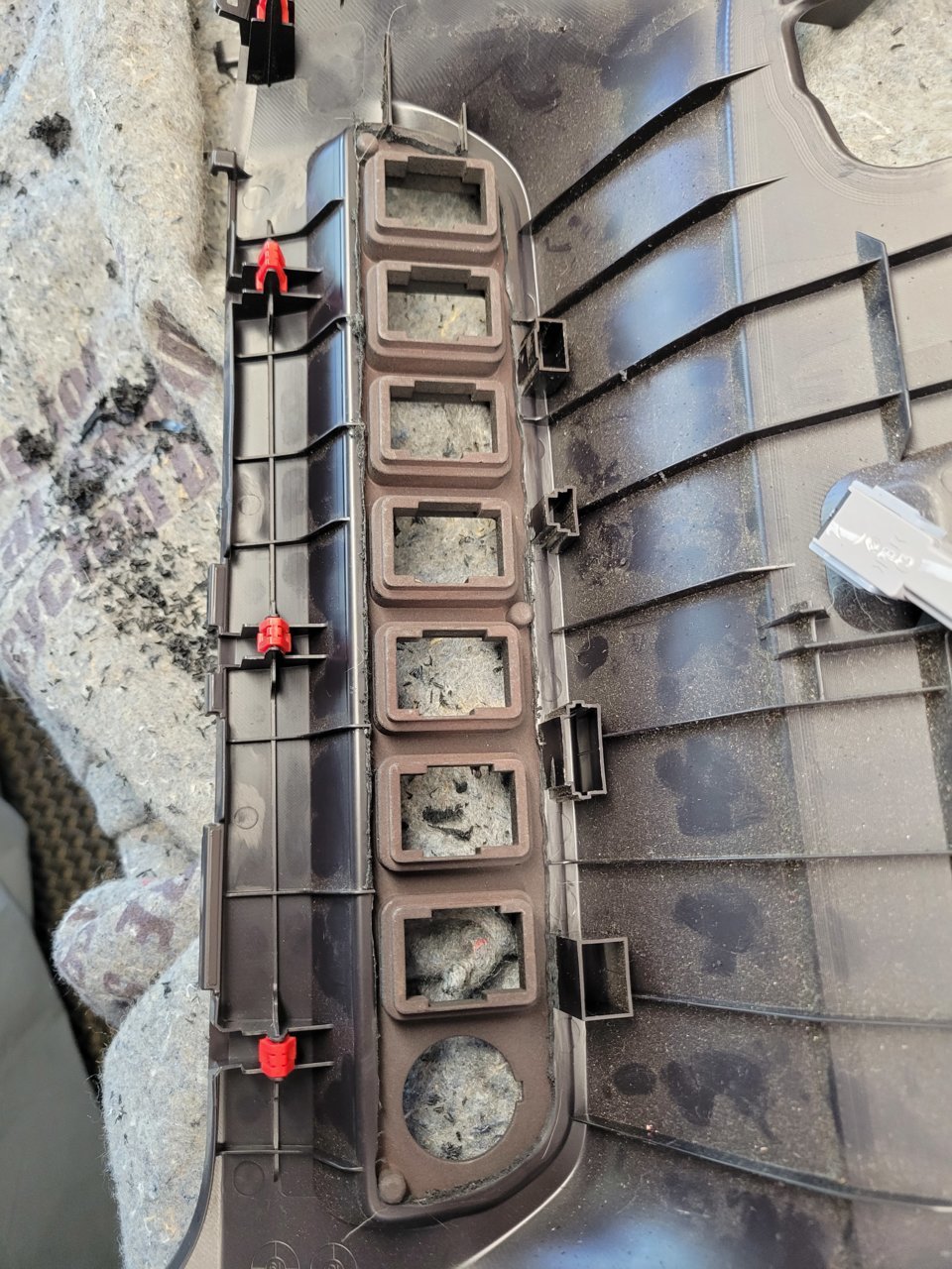

    One last thing. You may have to use a little hot glue around the oem cigarette socket. It seemed loose and wiggled in the meso panel. USE hotglue and not epoxy here in case you need to remove or replace in the future

    I was hoping to get to this project before my summer trip starting in June, but other delays on parts delayed other installs, that kept pushing back my time to do it clean and right.
    Curious why you cut out the factory area that the 12V socket goes. I was thinking of just leaving that material in place to support the printed part, as well as maintain a good fit for the socket itself.

    I’ve had this installed for a little over 2 years and never had any issues with support or the socket feeling flimsy or loose. I’m sure you could leave the material there if you wanted, but you’d have to cut out the spots where the tabs on the 12v socket go. They won’t fit on 2 layers of material.

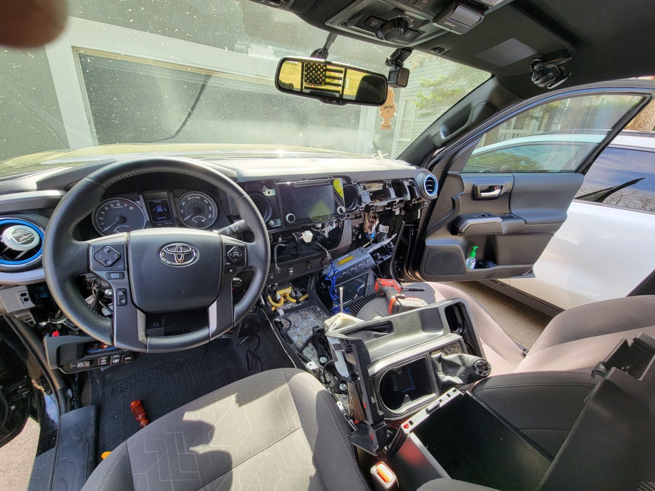

    I’ve had this for years and almost sold it but finally have the need for it.
    For those who didn’t take the dash apart how were you able to glue it in without have the glue drip?
    Taking the whole dash apart looks like such a pita but probably would give me the best results....just need the motivation to start it, it looks intimidating!

    I did the whole project in under an hour. Granted, I’m used to taking apart car interiors, but still.
    Absolute worst case scenario, you have a screw and a red clip left over like i did. It’s been 5 year since I installed this and I still haven’t found where they go and my truck still hasn’t fallen apart so they’re just in the glove box in case I ever take the whole dash apart again.
