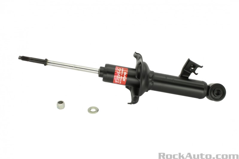

    I finally found a number to call KYB, the monotubes are for the pre-runner. I thought I could upgrade my front struts to gas-adjust monotubes because they were listed under front struts for my vehicle at rockauto. im not saying the brake line hooks into my shocks but there is a spot on the strut that holds the brake line
    I ended up buying these, you see how it has a spot for the brake line?

    #151688
    59,842
    Randy
    West Valley, AZ
    2017 4Runner
    That doesn't seem right. If they were designed for our Tacoma's, there wouldn't be a brake line holder there. I don't think they will work, but I'll let someone else chime in who is more knowledgeable
