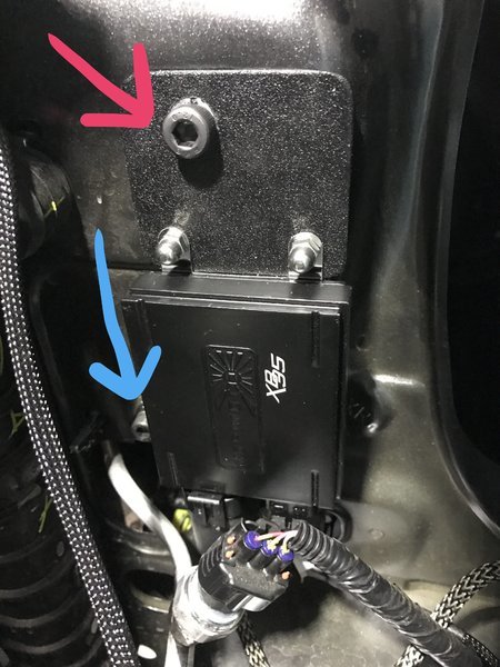

    Finished the install. Thanks for the idea on the brackets. I really didn't like the idea of drilling into the engine cab to make holes for the ballasts so I found preexisting holes and mounted off them. One hole had a nut welded on it so it worked out nicely.
    Used some 1/8" aluminum sheet, drew out two brackets, painted with black textured bed liner spray.

    Man... that looks GREAT! I need to step up my game. I see you mounted your passenger side on the same spot. I don't remember there being a hole with a nut on the back. I hated to drill two small holes also, but I can easily pop in a black rubber plug and it'll disappear if I need to remove, or redo the mounting point.
    Solid work man.

    Thanks! Ya the passenger side is mounted in the same spot as yours, which I got the idea from you. Worked great in that spot. The blue arrow points to an existing hole that was a clearance hole for an M8 bolt size. The red arrow was the hole that had a nut welded on the front side which was for an M6 size bolt. Both those two holes are preexisting in the engine cab.

    Wait that's wrong. It's opposite actually lol. Red is clearance for M8, and blue is the hole with welded nut for M6 bolt.

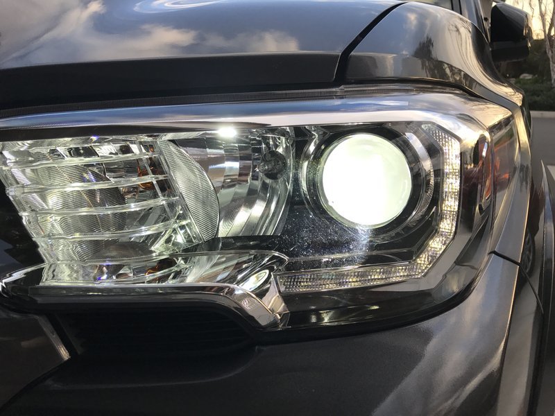

    I got the 35W 5500K and they look pure white to me. Didn't go with the 50W ballasts cuz I heard they can prematurely ruin your clear lenses, and also the warranty is less I believe 3yr instead of 5yr with the 35W ballasts

    Pic for color reference compared to the DRLs

    Here are the night pics:

    yes that is the white i'm aiming for... purchasing tomorrow thanks again!
