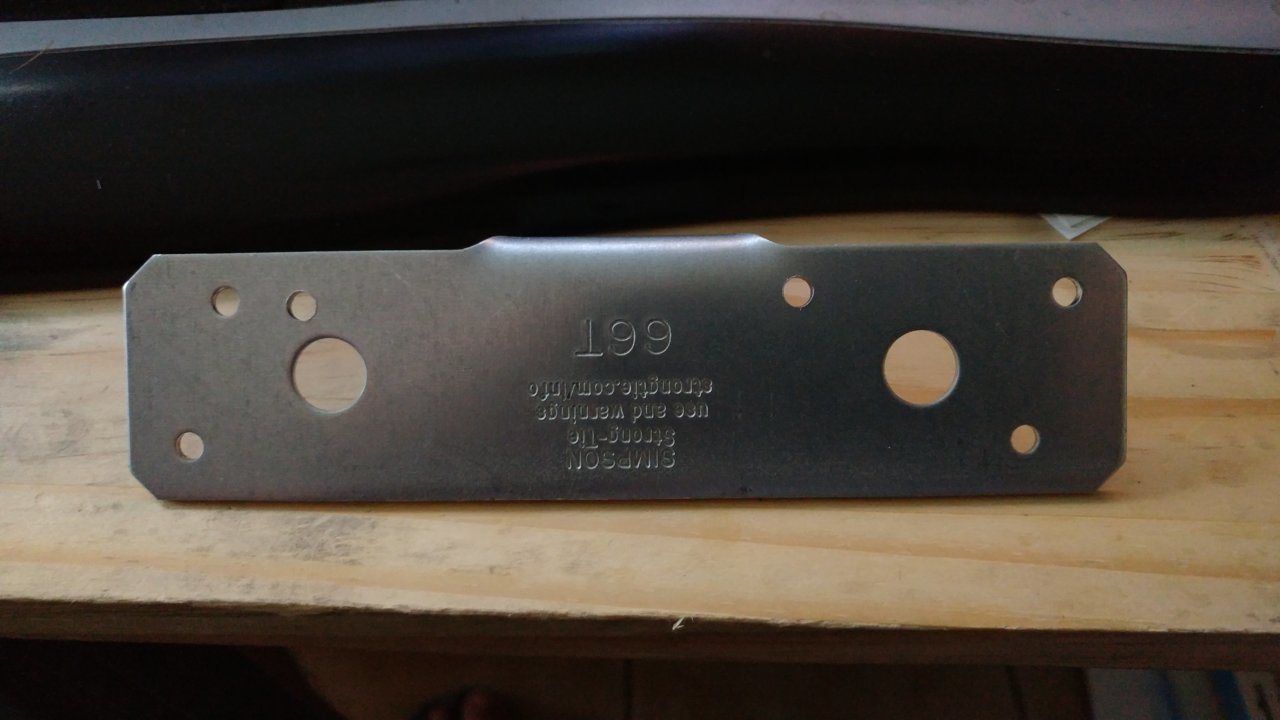

    Crap, I made 2 mistakes..... Should have bent the bracket the other way...... <smfh>.
    I am a noob - clearly.

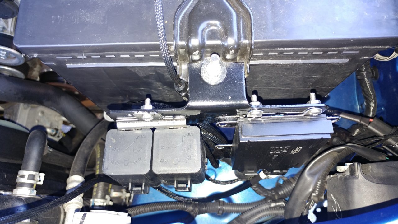

    Done. Doesn't look as good as others, but it works.
