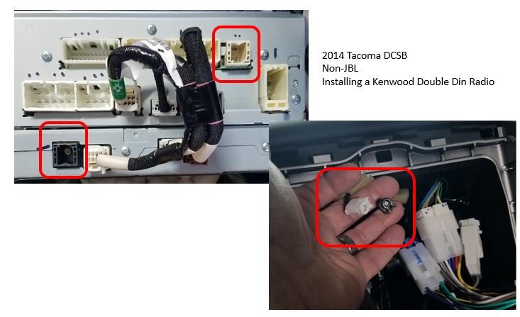

    After connecting the new unit, I have these two plugs left over. Can someone ID what these are for? Right now, all is working except when I put into reverse I get a "No Video Signal" on my screen. So it looks like it recognizes reverse but something is off.
    Crutchfeild premade harness and yes I'm talking to them.
    Would like to know what these two plugs are on the OEM Tacoma Entune double din head unit.
    Thanks,

    Someone will correct me if I’m wrong, but the black one is GPS antenna and the white one is camera video.

    UPDATE:
    Well, Crutchfield just rocks... I had my Red/White aux hooked up but not the Yellow cam in from the harness. Backup cam is up and running.
    Everything works and I now have Apple Car play and Android Auto (have two phones). So I wont' need that GPS antennae used on my OEM unit. I believe that goes for the shark fin on top of my truck?

    I am unable to receive AM radio stations. I do need this to work. Talked to Crutchfield but am still unclear. I did use the supplied antenna adapter and it plugged into the truck just fine. FM works just fine.
    Does this have anything to do with the two plugs above and perhaps a powered antennae?

    I thought the shark fin antenna on the roof was for am/fm/xm/gps? At least on the 3rd gens anyway? :confused:

    The white connection is GPS/HD antenna. The black, I'm unsure, but I believe it is the XM antenna. Regular AM/FM is picked up from the standard antenna.

    The large white rectangle connector to the right of the OP's circled white connector is the radio antenna. You will want an adapter like this:
    https://www.amazon.com/Antenna-Adapter-Vehicles-Aftermarket-Installation/dp/B0B3F6SZS6?crid=12X9RZZLCS4GX&keywords=toyota+antenna+adapter&qid=1685027495&sprefix=toyota+antenn%2Caps%2C136&sr=8-1-spons
    The blue wire is not used because the antenna is not powered.
